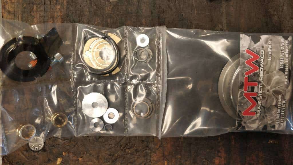

Been a while since I posted here after selling my S60R. But I'm currently getting ready to install a K24 in my 850R along with a manual swap (thread linked below). I decided to post this here to make it easier for anyone looking for a K24 rebuild kit with a 360 degree thrust bearing. Apparently they're hard to locate. I was looking for one because they are generally better than the stock 270 degree bearing and I specifically wanted one since I'm installing a larger 7+7 compressor wheel on my turbo which means more strain on it.
I researched online and found old posts saying to check into specific shops in Sweden or turbo shops in Florida but those were dated and led nowhere. I even asked a reputable Volvo performance parts retailer and they weren't aware of any of these kits. That's why I was ecstatic to find this shop an hour away from me that actually made them in house. Who would've thought.

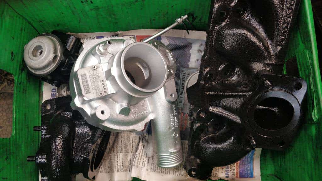

K24 before it gets machined:
When I arrived, they were very friendly and helpful. They even had someone else's K24 being worked on that you can see in the picture below. I'm excited to get this thing back and installed. I'll update you all on how it turned out after they finish working on it.

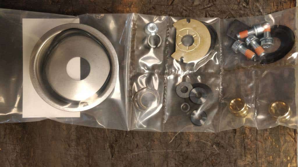

Ok sorry all, it's been a minute since I last updated. That's because we ran into some problems with my turbo. So after I dropped off my k24 and larger 7+7 wheel to get machined and installed along with the rebuild kit and 360 degree thrust bearing, the shop called me and said they found some damage internally. The turbine shaft on the exhaust side was pretty much worn to the point where the grooves were no longer there. That and there was some damage to the bearing housing upon disassembly most likely due to the damage on the shaft. Here are some pictures:
Luckily, they were able to find a spare used turbine shaft and bearing housing to install so that eliminated the need to order new more expensive ones or wait longer for new parts to arrive.
Other than that, I got the turbo back and it looks pretty sweet. They machined the compressor housing, installed the new larger billet wheel, replaced all the seals and rings, installed the beefier 360 thrust bearing, balanced it, and gave it all a new coat of paint to make its appearance look proper. Here it is:
