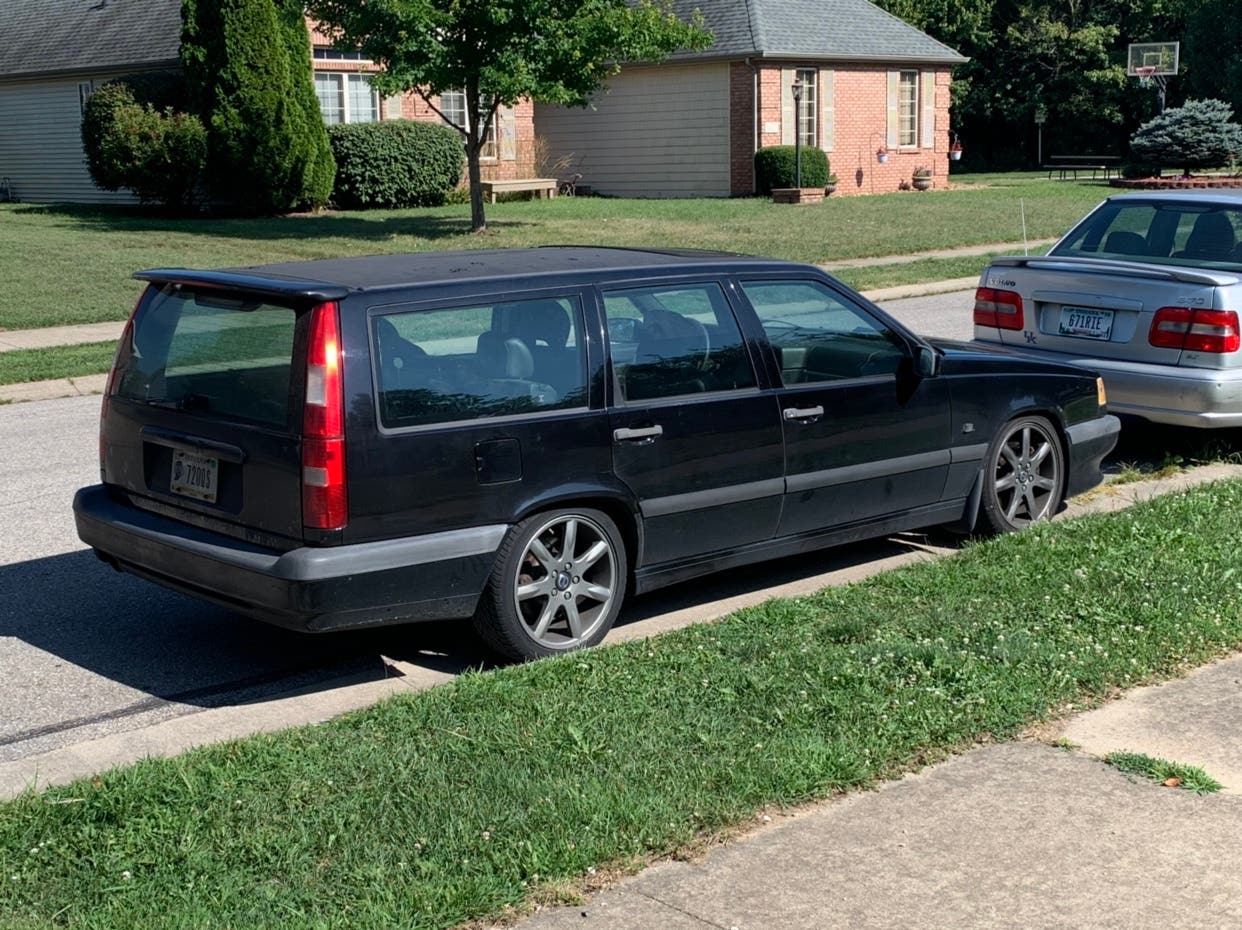

My black 1997 855R wagon
18K views 153 replies 14 participants last post by  johnwartjr
#1 · (Edited)
So you've seen my thread about my replacement white 855R but I don't think I started one for my black 97 855R!
This is a 97 850R wagon. Has 355k on the odometer as of August of 2019.
Engine is stock, but has been M56 swapped back at around 200k. I daily this car during the nice months, but I don't like to drive it in the winter.
Mods so far:
V70 hatch with spoiler with 3rd brake light
Plastidipped roof since the original clear has failed
Powerflex torque mount and top mount bushings (all 4)
94 850 subframe with Delrin subframe bushings
93 aluminum control arms with power flex black control arm bushings
IPD sways and links
IPD springs
Bilstein HD shocks and struts
C70 convertible subframe brace
Ultra Racing front and rear strut braces
DO88 silicone coolant hoses (all 8)
302s in the front, braided stainless hoses all around
IPD skid plate
Mods on hand, waiting to install:
DO88 radiator, intercooler, RIP kit
2004 C70 subframe - aluminum bushings
1998 C70 delta link - its a little bit wider
A set of Nebulas
Honestly this is the most fun car I've ever owned to drive.
My drive to and from work runs about 120 miles a day. So, I just keep racking up the miles.

So it’s been awhile since this car got much if anyone love.
Today, I put on a new OEM PCV kit, NA intake with 960 throttle disc, DO88 radiator, big pack intercooler and associated RIP kit.
Also did the fan mod.
Earlier this spring, I swapped out the starter and both battery cables.
There isn’t a lot of room to get that radiator and intercooler in there!
