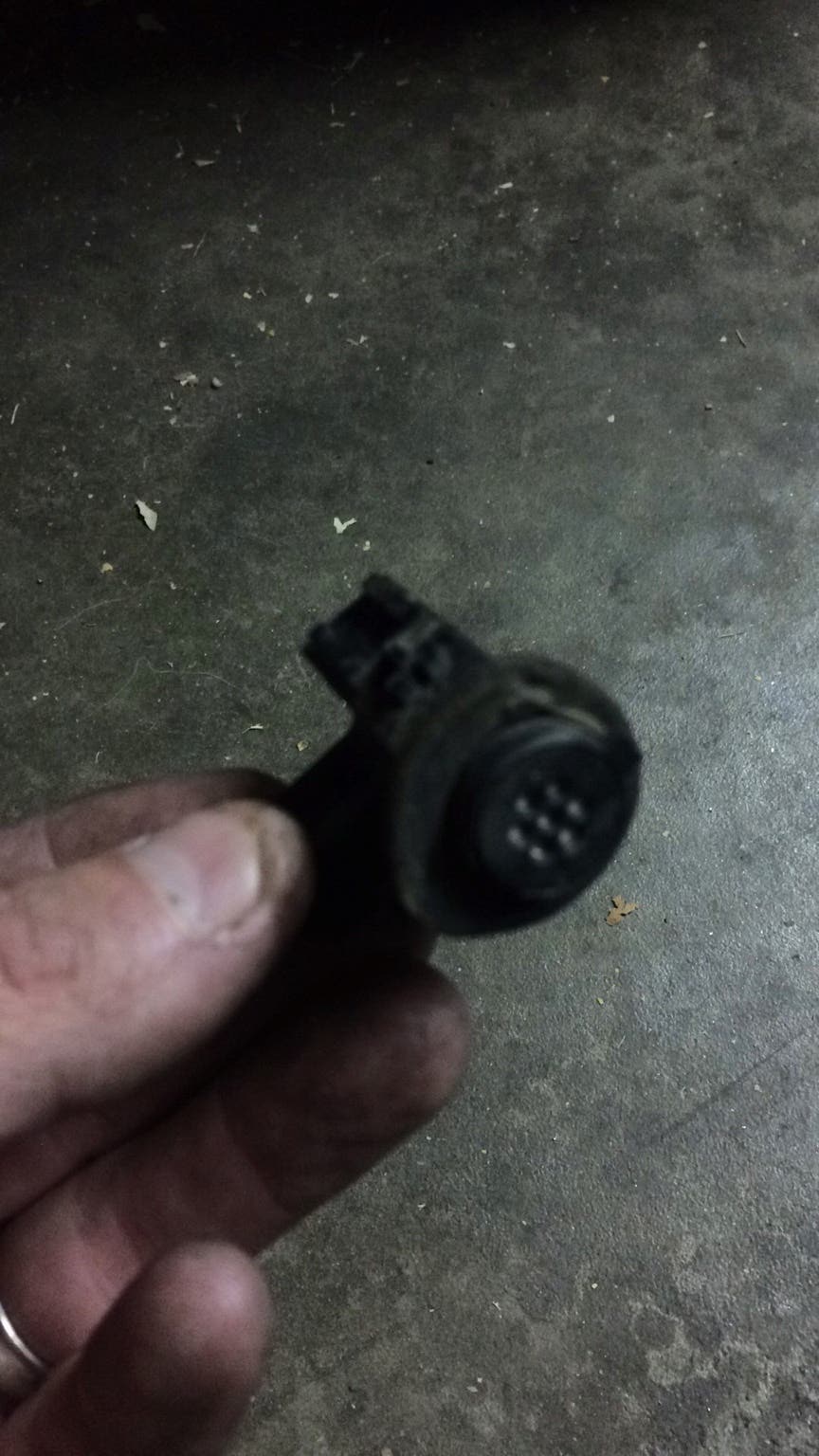

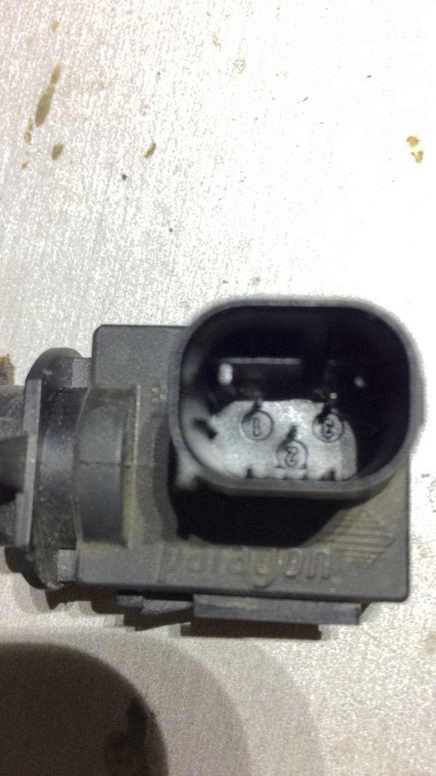

Discovered this huge price savings if you have an IAQS (interior air quality sensor.)
VW part # 1K0907659 ... is an exact match. Made by Paragon, with their logo on it, and just branded with VW/Audi in it instead of volvo. It'll still plug into the socket, it'll slide into the bracket that holds it, and it will work as it should. It'll also eliminate a code if you have one in your VIDA-side of things.
I got mine for $14 w/ free shipping... versus the $130-150 on most parts sites.
Location of sensor...
YOU KNOW YOU HAVE IAQS IF YOU HAVE THIS BUTTON (the auto function)...
The one I pulled from my 02 S60 2.4T, and according to VIDA should be the same sensor on all P2's and P2R's that have the IAQS...

Remember that older P2 cars (2000-2002) have differend AQS sensor (bigger and cannot be exchanged).
I should have mentioned that.
2001 and mid-year 02's may have a different sensor. But my 02, had this one.

To make sure you’re clear... this alternative part will not work 05+... we have determined it’s an early p2 alternative only.

Have long had CCM-0021 Air quality sensor Internal fault. Going to try one of these ebay sensors with part no 1K0907659. They are all chinese, not paragon branded. I'll report back with the results.
That specific part that I tried did not work. VIDA would report back a duty cycle of 1000%.
So what’s the correct part number to order and can it be gotten on eBay?
I don’t know, yet. I’d like to find one that works but the one I tried didn’t.
How do you know if one has failed, does it throw a CEL?
No it will show up in VIDA as a DTC.
I ended up replacing my IAQS sensor with a Paragon labeled unit from a 2011-14 VW Passat I think. Ordered it from eBay. I posted it in the S80 “what have you done thread” and it functions and fit perfectly.
I can say I’m not sure of the usefulness of this function and hoped it was actually functional but I was recently behind a big rig spewing all sorts of black smoke and it stunk to high heavens. I thought the system would turn airflow off but it never did, even after me fiddling with it to make it work. I kept shutting the fresh air off and turning it to recirc after waiting for it to automatically change modes and it never did.
At least I don’t have the code on my VIDA anymore tho.
