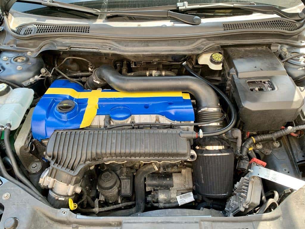

Originally, I deleted the vacuum pump by modifying the stock hose that was included on the car so I could keep the check valve. I HIGHLY advise against this. The reasoning? If the check valve goes bad, you will likely lose your brake assist power. It is not uncommon for these valves to fail. It is recommended to replace with a straight vacuum line like I will show you.
I won't go into detail on how to remove the vacuum pump and it's mounting bracket for two reasons: 1 it's been documented before and 2, it's fairly self explanatory if you look at it, the bolts you need to remove are the only ones connected to it. If anyone has questions on this though, I can definitely update this here!
Now you can remove the rest of the vacuum hose that routes to the intake manifold, OTE pipe, and brake booster.
Once that's removed, go ahead and get your new vacuum hose. I chose a hose from Amazon. It is 12mm inside diameter. This is a little bit of a tight fit, but it gives me peace of mine knowing it won't come off easily. Here's what I ordered: Amazon.com: High Performance Silicone Vacuum Tubing Hose, ID 0.47" (12mm), OD 0.71" (18mm), 5 Feet per roll (1.5 Meter), Black 60 psi Maximum Pressure: Automotive
We need to cut the end of the existing vacuum hose that connects into the intake manifold so that we can reuse this piece for our new hose. I cut mine right around where the yellow arrow was below.
After that, insert the piece you just cut into your 12mm ID vacuum hose. I added a hose clamp on this just for extra safety, but it may not be needed.
Then, connect the other end to the brake booster vacuum hose that comes from the firewall. This is slightly larger than 12mm, so this will take some muscle to get on. I also included a hose clamp here just to be safe, but this piece likely doesn't need it since it'll fit on so tight.
Finally, we'll need to plug the OTE pipe with a cap where our old vacuum line used to connect to. This prevents dirty and unmetered air from getting into the engine. I bought a pack of vacuum plugs at Autozone here: https://www.autozone.com/ignition-t...routine-maintenance/vacuum-cap/dorman-autograde-assorted-vacuum-caps/365550_0_0 I can't remember what size I ended up using, but the kit includes one that slides right over this plug. I then used a zip tie wrapped around it to make it hard for it to slide off. This shouldn't come off, but if it does I'll likely switch it for a hose clamp.
And that's it! Driving the car around feels like normal, and myself (as well as others) have noted that boost feels like it builds slightly quicker, as well as the turbo noises being slightly louder as well. This all might just be a coincidence, but it could also be a result of this mod!
I did some tests with braking, and it all feels the same as it did before. The only time it feels different is if the car is turned off and you continue to press the brake, but it isn't often that the car dies on itself and you need to brake in an emergency. Even if you do, you CAN still stop the car, it just won't be assisted (again, like most cars on the road today).
The engine bay sure does look a lot cleaner! Now I need to sort out my air intake situation and move that ugly looking ECU bracket I made…
I think I covered anything here, but if I missed something or anyone has any questions, feel free to reach out!

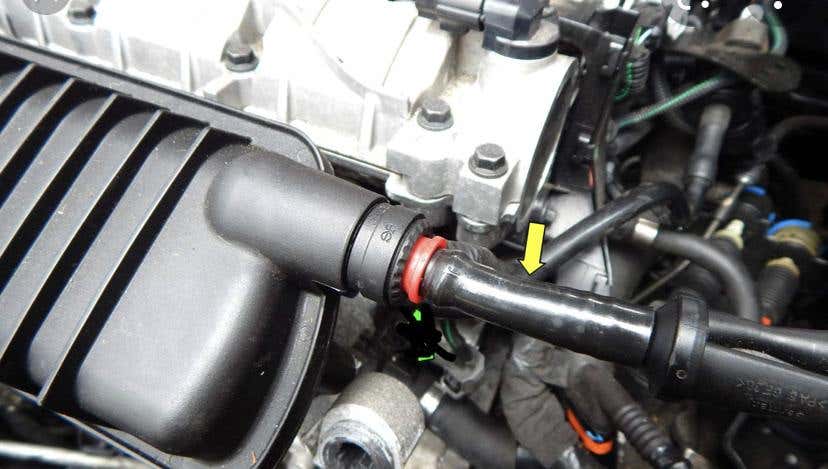

So after doing some digging and talking with others, im almost positive that there is ANOTHER one way check valve before the brake cylinder.
Talked with some people who work on Volvos a lot (specifically P1s) and they said they believe they remember another valve behind the firewall/battery box before the vacuum line goes into the brake cylinder.
I wanted to confirm this so I loaded up VIDA.
129661
In the above image you can see part #10 which is the vacuum hose that connects to the vacuum pump, intake manifold, air intake pipe, and the brake booster. Right after that, you can see part #11, which is the hose that comes through the firewall and connects to part #10. Looking up part #11, which is Volvo part # 31406272, we can see what looks to be a one way check valve built into this hose.
129662
You can see it right above the "U" in the "FCP Euro" watermark. Im almost positive this is a check valve, and will do more digging to confirm. But i think that this keeps the brake booster safe from any sort of boost going into it.
I've talked with a handful of people who have ran with a straight hose for years and have had no issues at all braking, so I think this mod (as well as the nicer looking Focus RS hoses) are safe and should not damage the brake master cylinder, etc.
I'd love some input and thoughts on this though to confirm my findings, etc. Thanks all!

Not 100% sure what issues that would cause but that check valve I believe is there to prevent excess boost from leaking back into the other side of the intake manifold, there is another one on the opposite side of it as well. That's one that should 100% be there.
#27 ·
I agree with @lookforjoe and @evy0311. I think without that check valve the intake plenum will bleed boost to the turbo intake pipe and then back into the turbo and over again.
In mine there's two check valves: the one @Joshude is missing, which has the flow orientation to the intake plenum. And there's another at the other end of the pipe with flow direction to the turbo intake pipe after the MAF sensor. Basically both check valves with opposite flow directions. Can anyone confirm if this is ok?

Do you have a pic of the tubes? On my 2012 C30 T5, the tube fitting on the inlet pipe is part of the vacuum tree that attaches to the plenum, brake booster & vacuum pump.
The one from the underside goes back toward the bulkhead - I assume for HVAC - I've not looked specifically - you can see where it doglegs over the engine harness casing
Typically, any/all check valves are there to prevent positive pressure pushing back - so the "motor' (draw) side of the valve will always face the vacuum source (intake hose/pipe, plenum, etc. You can confirm this by applying suction to the valve & then try blowing into it. You should be able to draw through the valve from the plenum end and from the inlet end, but no pressure should pass.
