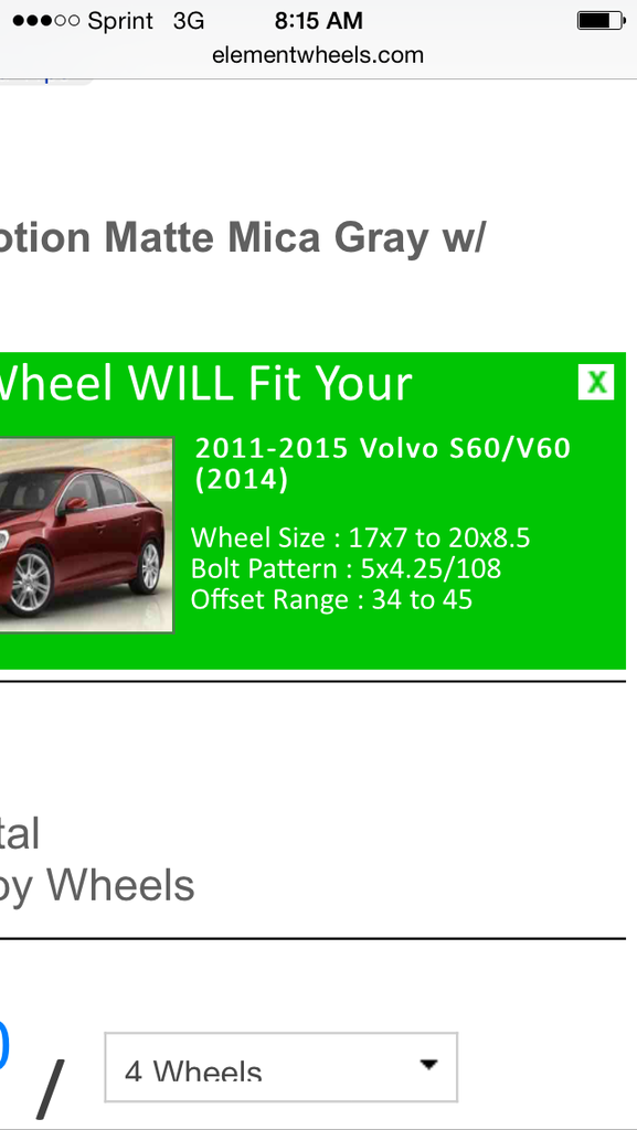

So I have that same question I have a 2014 s60 tho not R design and I want to install some new rims. would 19X8 in front and tire size 235 40 R19 and in the rear 19X8.5 with 245 40 R19 would that fit perfect in my car ??? Maybe I could go with a thiner tire 35 instead of a 40 ? Please guys let me know !! Thanks

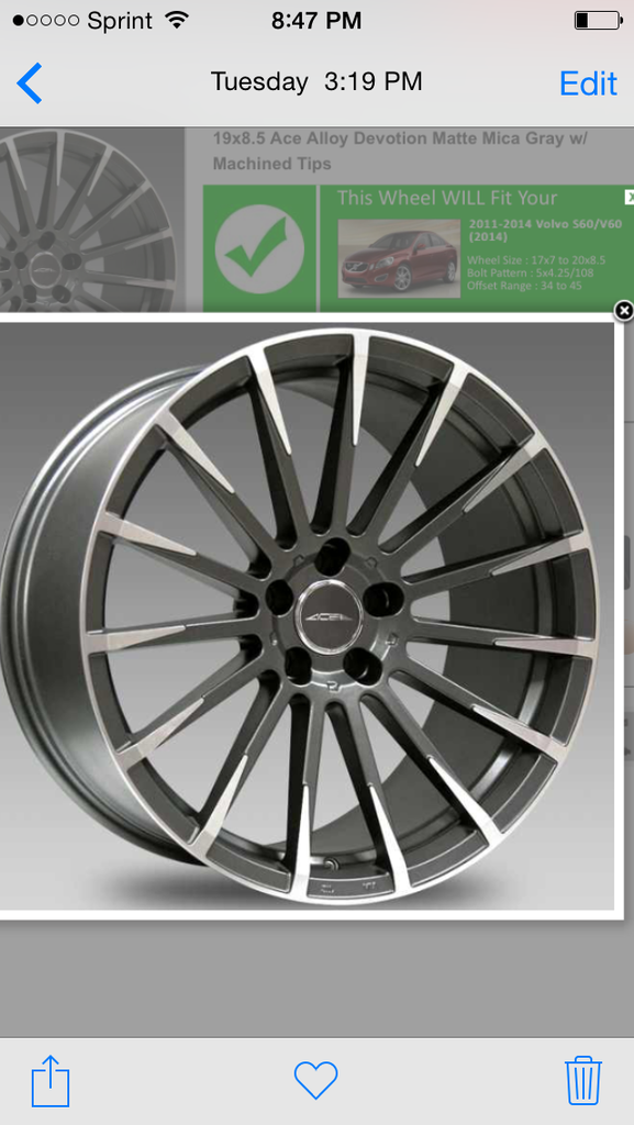

I'm thinking of trying a set of the Focus RS wheels which are 19x8.5 +60's.
Same bolt pattern and bore..hopefully no rubbing inside. I like the design. You going 245/35?

Your offset and tire selection is off; appears your rims are even beyond the fenders. Should be 245/35's and +ET45-50 right? Tire Rack shoes 45mm for most of their recommended 8.5" rims.
That's why I think the RS wheels might work for a more aggressive tire. They are set in 15mm more.

That's the wheel so guys please tell me what will fit my stock s60 2014 with 17 oem wheels please tell me tire size as well thanks guys
Nice, I like! Of course I like, they look like my Bor's. ;)
Nothing less than the ET45mm offset though. 235/40-19 or 245/35-19 should work.
#24 ·
way wrong offset! should be 45-50. makes for a good off-roader look though...
