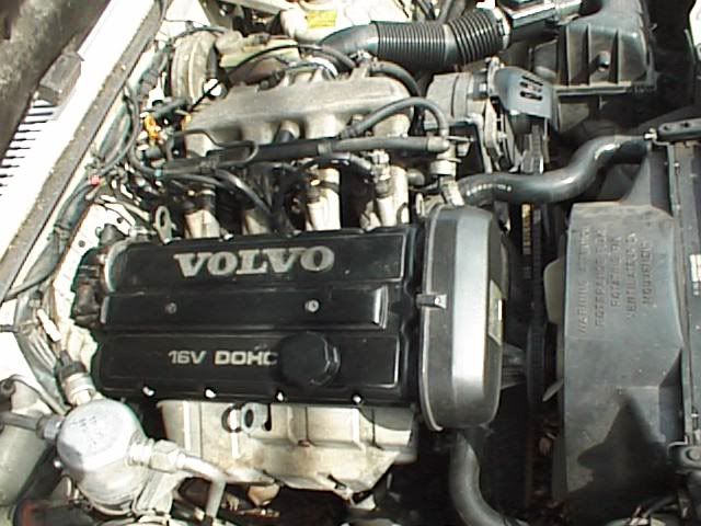

Careful if you are going for the stock B230FT turbo motor you got in your 87 760 to use a B234F head with stock plumbing. You might have to trash all you got now, and use all new or used aftermarket upgrades for a B234F eng to work in turbo trim. It is way more then just slapping on a 4 VALVE Head. Research before you just buy the head and expect it to bolt on.

Sorry to break the news to ya. If the pic up above is the same or ALMOST to your 760 turbo eng bay? Then you have one or more of three MAJOR problems going on.
1) you bought a 87 740 16V with a 760 turbo badge stuck to it by some YOYO. Hense NO TURBO.
2)you have the only 760 turbo made with NO intercooler or intake hoses for it.
3)airbox is on wrong side of car to even work with a stock turbo setup. And the Turbo airbox says TURBO on it.
The 86 760 Turbo intercooled eng bay on my moms car looked nothing like this. It had way more hoses(for the working intercooler). One more thing if your car takes the standard every other 700 seris airfilter size and not the special only for turbo cars size filter then it is NOT a turbo car.

yeah the air box is on the passenger side running to the intercooler and around and all that good stuff but i mean the only difference looks to be the intake, intercooler, intercooler hose, head and belt cover from what i can tell in the picture its hard to say that mine is deffinitely the same from a picture

Like Nato740 said, it's not just a 'slap it on & go' proposition. Some points to think about:
The 16V heads require pistons with valve reliefs machined in them.
The power made by even a 5psi boosted 16V car is beyond support by the stock fuel system.
You need to lay out some $$ for a Euro-only 204GT exhaust manifold, or have a custom header welded up.
