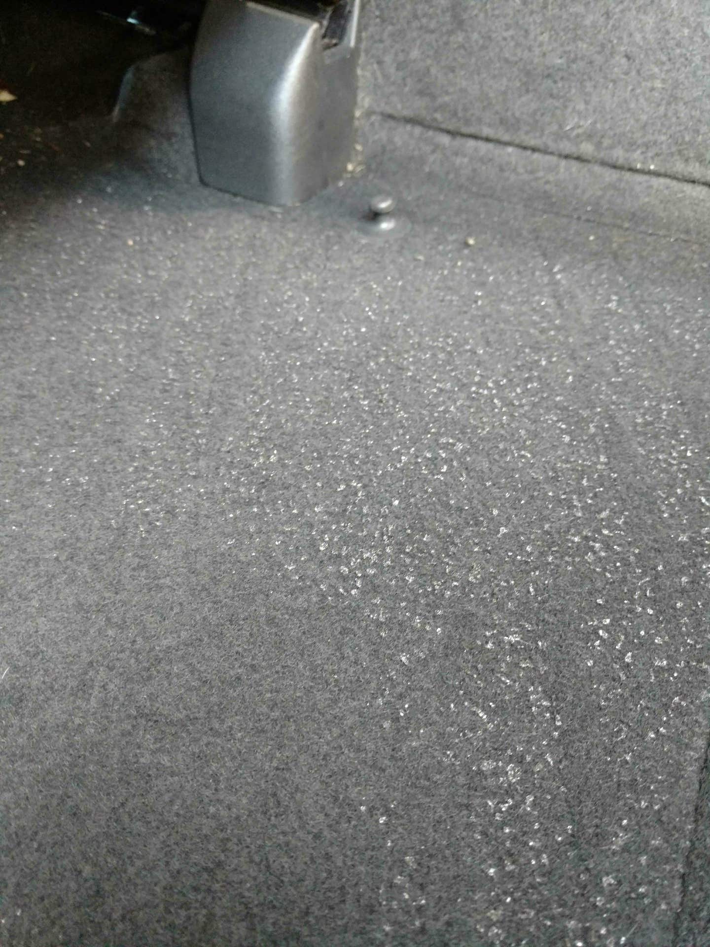

Got up this morning to clean out the s40. Was going to hose off the rubber floor mats I have (OEM Volvo) to clean a little bit of dirt off of them. As I removed the left rear one first, I noticed a lot of water underneath the mat. It isn't puddled, but it is significantly damp/wet with some drops of water visible. The little white dots that are seen in the first attached image are all drops of water. There is a must smell that is coming from the carpet as well.

Your drivers side sunroof drain shrunk and is pouring water direcrly into your car. You need to replace and secure the drain hose. Take out all the seats and carpets to dry completely or else that smell will get much worse and it will start molding under the carpets.
