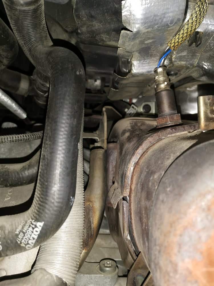

Also I should mention my experience on my XC90 2017 T6, no heat shield removal required for Replacing the front (before cat) O2 sensor.
No need to remove belly pan cover as the sensor can be reached with long skinny arms and long fingers with no rings on any finger….lol.
Once you brake the sensor loose, unplug the sensor above in engine compartment and then completely unscrew the sensor.
Then I got new sensor and enclosed it in the plastic bag it came in with an elastic band to keep it clean as I lowered it from top of engine compartment to the exhaust area once down, I plugged the sensor in and went underneath car again to install the sensor hand turned it a few turns and the went up a above again to unplug the sensor and completed the install below.
I used the stubby sensor socket with a ratchet to do the loosening and final tightening of the sensor.

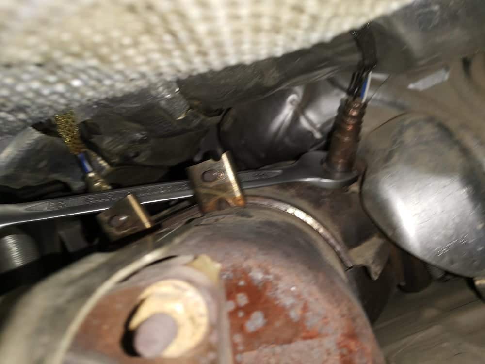

Just wanted to add, I completed this on my XC90 T6 AWD. Volvo wanted over $900. I only replaced the downstream O2 sensor and after a few trips the CEL went away.
Couple of things I would add.
  • I have pretty long arms but even I found it difficult to reach, you have to feel for it. The upstream sensor is easier.
  • I only replaced the downstream sensor and it fixed it, but it's probably a good idea to do both.
  • Start Stop was malfunctioning (giving an error) but this went away after two trips.
  • The offset O2 sensor someone recommended above wouldn't fit for my downstream sensor so I had to find a fairly short 22mm wrench.

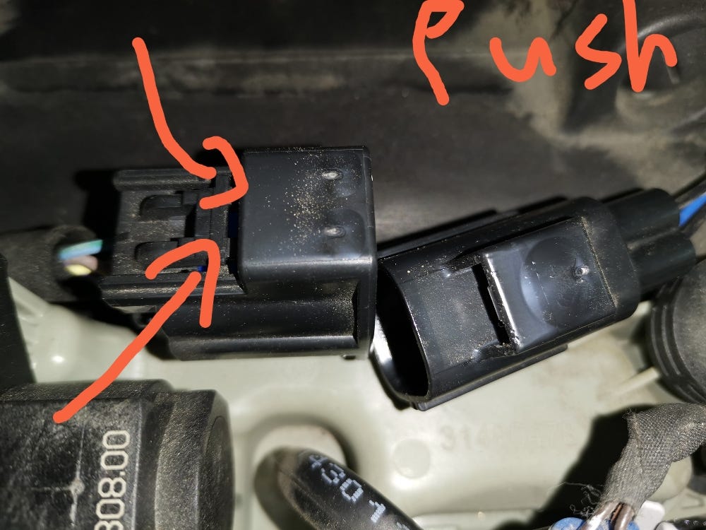

  • Had to lever the plastic clip holding in the plug using quite a bit of force.
  • Definitely doable with basic tools and very basic mechanical knowledge.

Which sensor are you replacing, or are you doing both? I did the downstream (driver side and harder to reach) which fixed it. I gave up on my first attempt. On the second attempt I basically just did it 90% by feel and it wasn't actually that bad, just make sure the exhaust is completely cold.

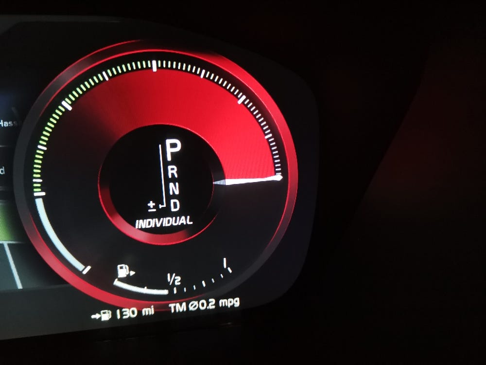

I think he's talking about the trip reset on the end of the left hand stock.

Yes exactly it's the trip stick. This will reset the mpg data.
I would agree the place is pretty tight and you can barely see the whole work. You will need to rely on feel to complete the job.

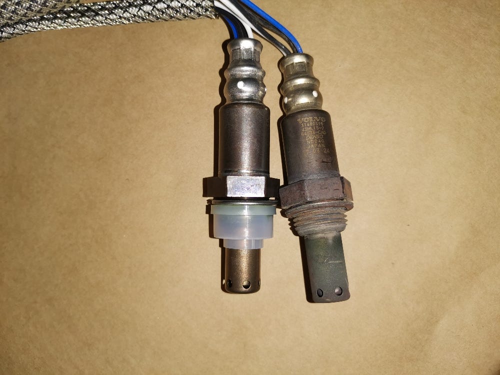

Left (driver side) is downstream, right (passenger side) is upstream. I replaced my downstream (the one that looks more like a cylinder than a point) and it fixed my CEL. It's not too bad, just make sure the car is completely cold as you'll be hugging the exhaust.

I actually thought removing the heat shield was easy. I only replaced the downstream sensor and it fixed my issue. Just make sure it's totally cold and go under the vehicle from the front so you're hugging the exhaust. I got the slotted socket tool and it wouldn't fit so I used a short 22mm (if I remember correctly I could be wrong) and it worked fine.
