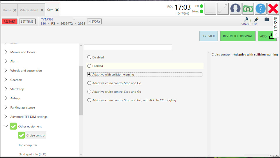

Best thing to do is email Pavel if the option exists. When you have VDASH running you may be able to scroll through the menu and see what options can be enabled.

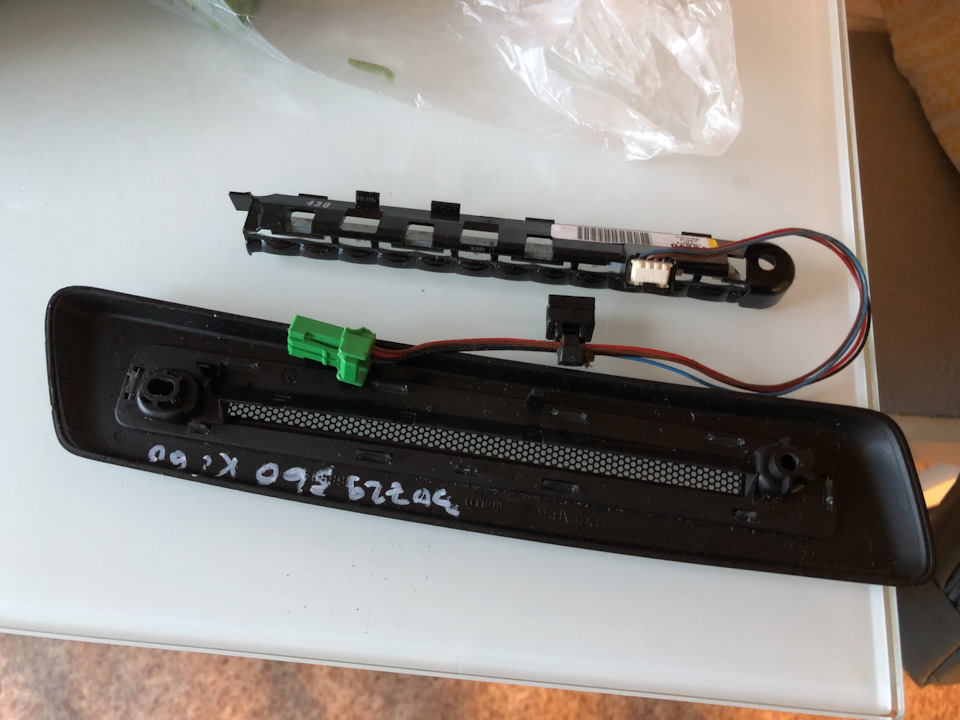

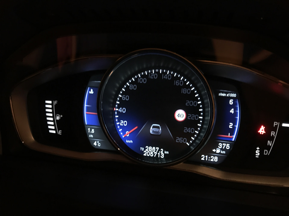

Hello,
Just an update with some topic about ACC retrofit : It seem to be possible with Vdash
