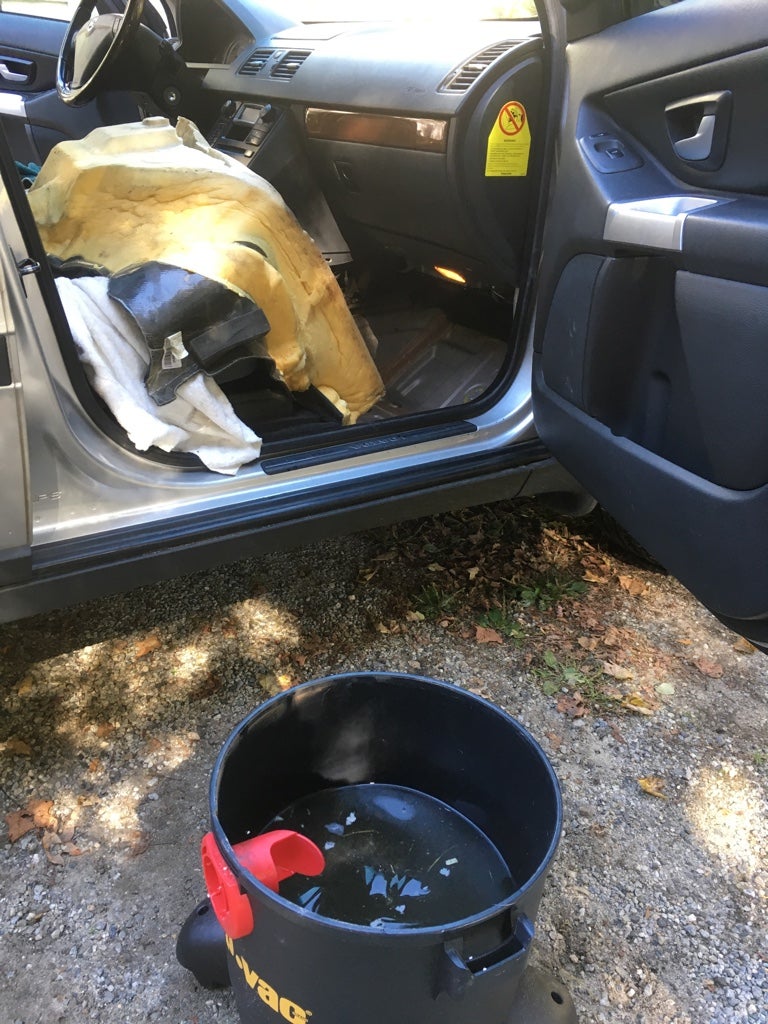

That's an 8 gallon shop vac...
Sunroof drain grommet was definitely clogged.
Could anything else be leaking in here that I should check while it's apart?

Wow, Let that air out for a while! The grommet you're talking about is the one in the A-pillar just above the dash? Make sure you check both sides, there's one in the driver's side too.
If yours are the older kind that close up like a star shape on the bottom, trim that material off so there is no obstruction.
Before you button all the interior back up, run a garden hose on the sun roof for a while to check for additional leaks.

Good call! I happened to check the drivers side "just in case" and hose was completely disconnected from the grommet! Luckily (sort of), the drain hole in the sunroof tray was clogged on that side so all the water drained out the passenger side regardless.
Going to fix it all and retest.

Lining isn't bad... water seems to have made it all into the right side footwell :D
I'd make sure you get it nice and dry down there. Last thing you want is mouldy spores forming on the foam padding. It will smell stale and there is no amount of smelly trees that you can hang from the centre mirror that will get rid of it. [emoji268][emoji268][emoji268]
