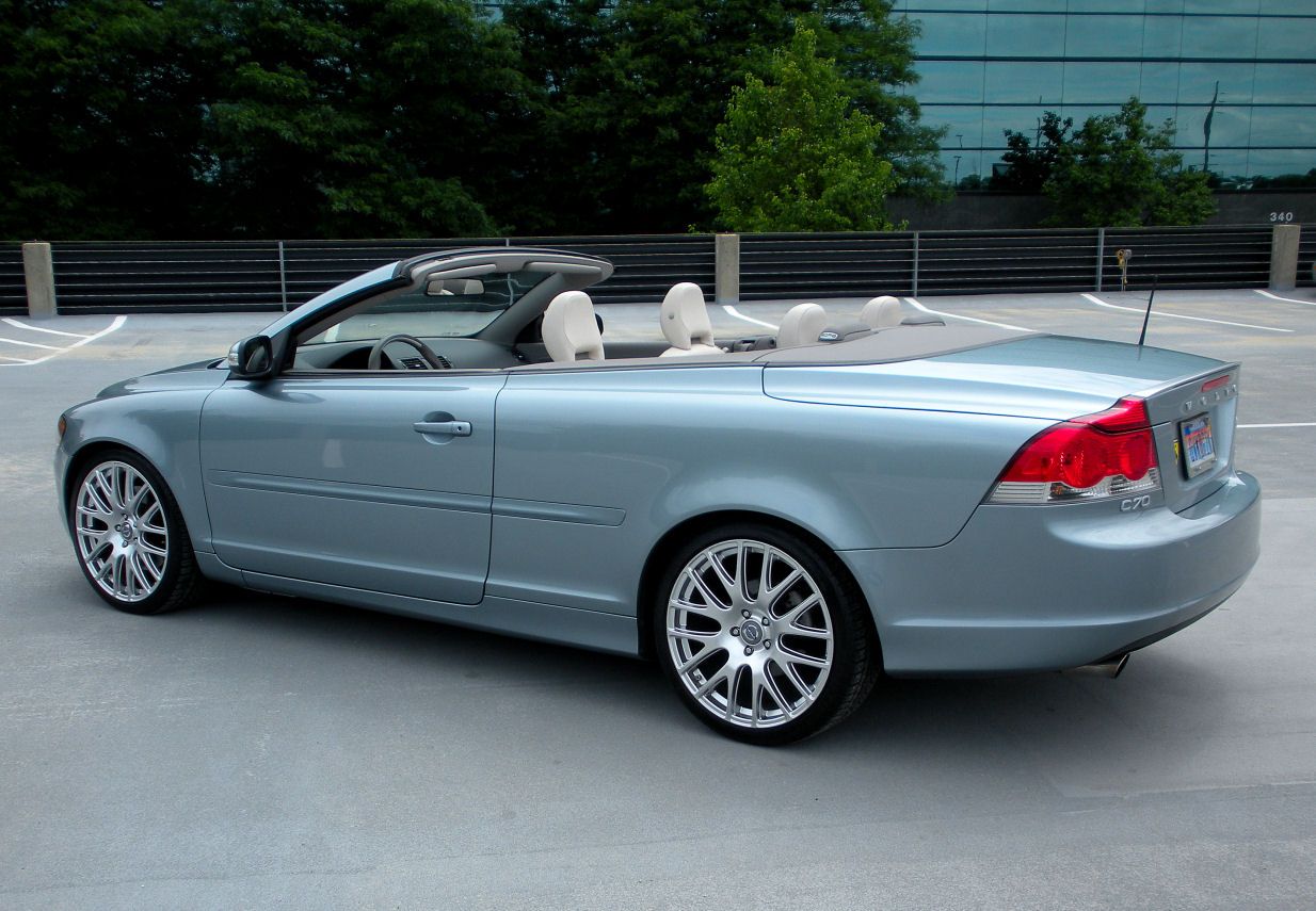

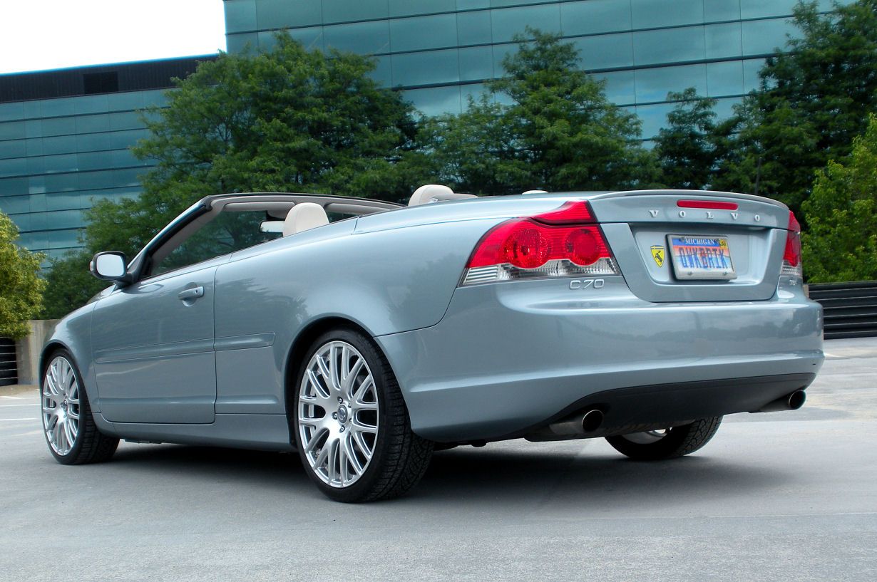

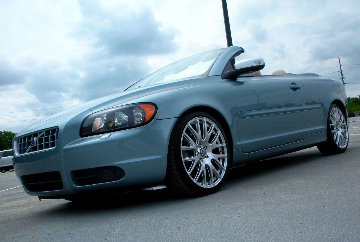

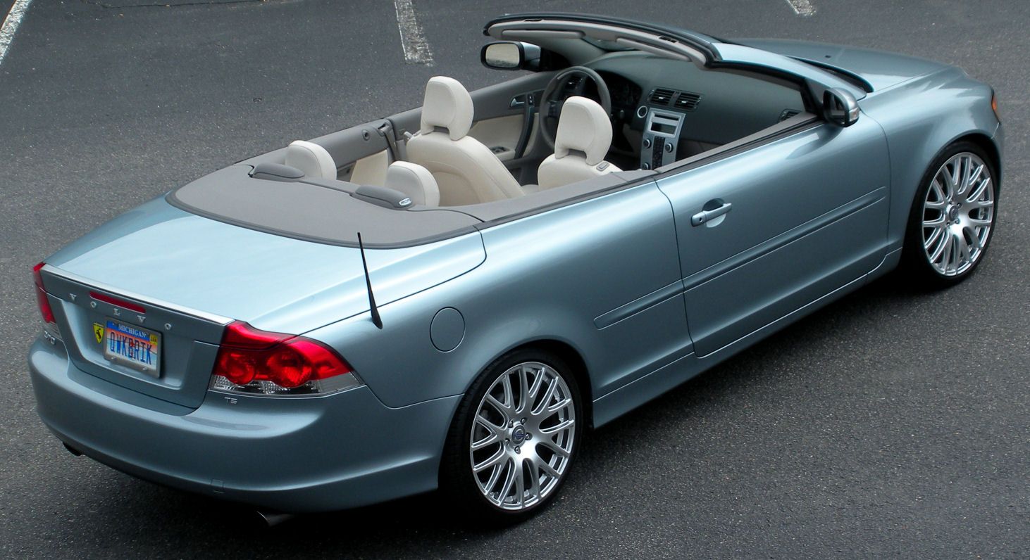

I thought I would be done this weekend, but realized one more tweak will be required. Paint, interior, and suspension work is all done.

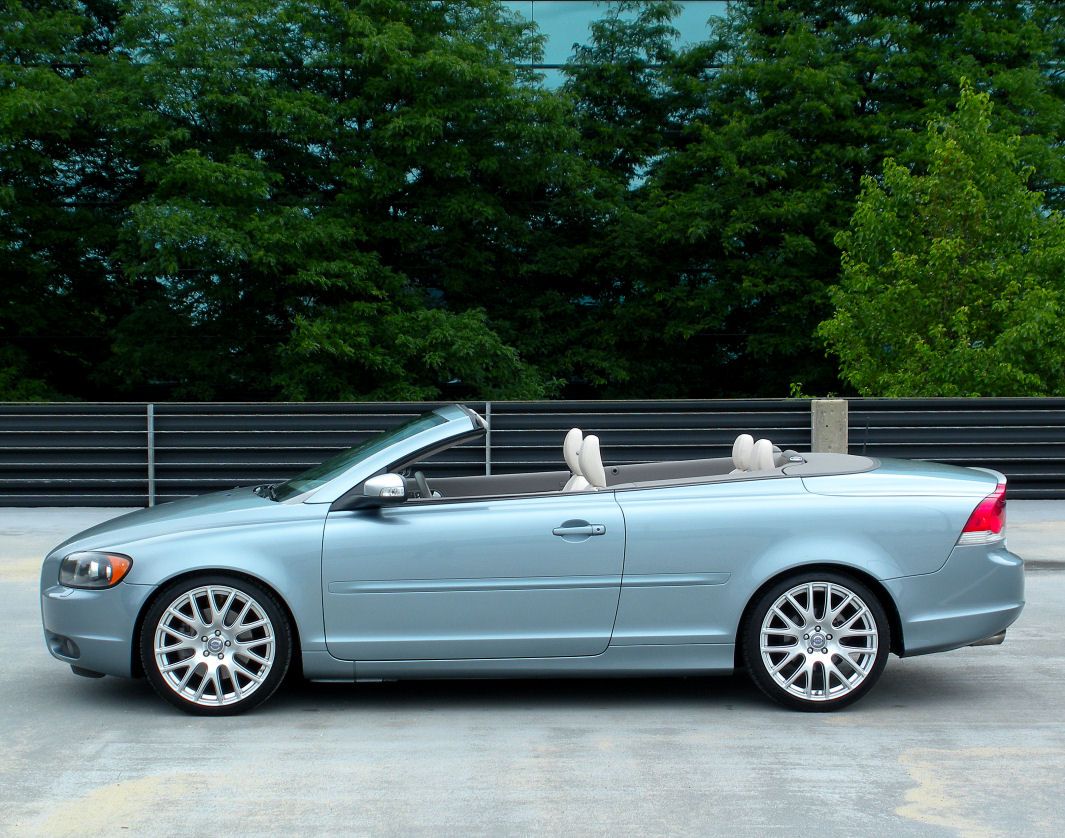

The Bilstein B8 strut and shock / H&R spring package makes her drive like a completely different car. It is AMAZING and I don't use that word often. Completely flat through the corners and actually handles bumps and rides smoother than the OEM setup with less bounce and jounce. This car couldn't possibly be more fun to drive. It feels really sure footed like it has never felt before. No more plowing ... I look down and am doing 50 through curves I used to get excessive roll out of and could barely handle at 30. The drop from an aesthetic point of view ... was maybe a little disappointing from my perspective as it is actually quite subtle. I could make it look more aggressive with some spacers but really don't want to sacrifice the ride quality I now have. I still have plenty of room in the wheel well and no issues with any rubbing at all. 19 inch TSW Mugello's with the stock 45mm offset and 235/35/19 Conti DSW's
A big thanks to my favorite Service Manager Brian, and their top mechanic Levi at Dwyer and Sons Volvo here in Michigan for a really painless install. They always take really good care of me ... they had a real laundry list this time and handled everything correctly the FIRST TIME.

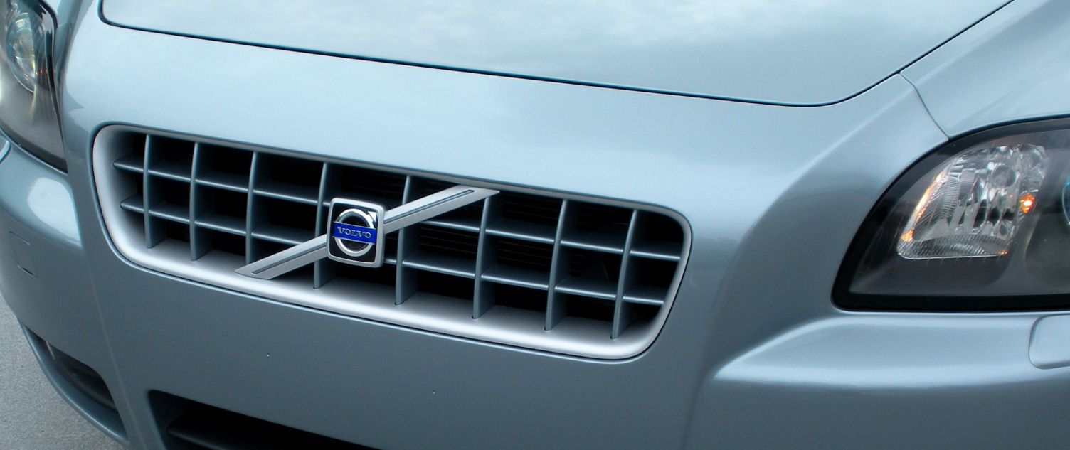

There were a few paint repairs required so I took the opportunity at the body shop to do a few custom mods. All the satin sliver work was yours truly and all the celestial blue was shot by my friends over at Fraser Auto Body. The grill makes the front end look rather "ghostly" ... that is really the best way to describe it. I paired the satin silver mirror covers with my satin silver el-cheapo spoiler, then debadged, repainted, and reapplied all the rear emblems. I took the opportunity to space out V-O-L-V-O like the updated version since I have the old style 2008 for a bit of an updated look as well. There is no more bright chrome on my car now at all.

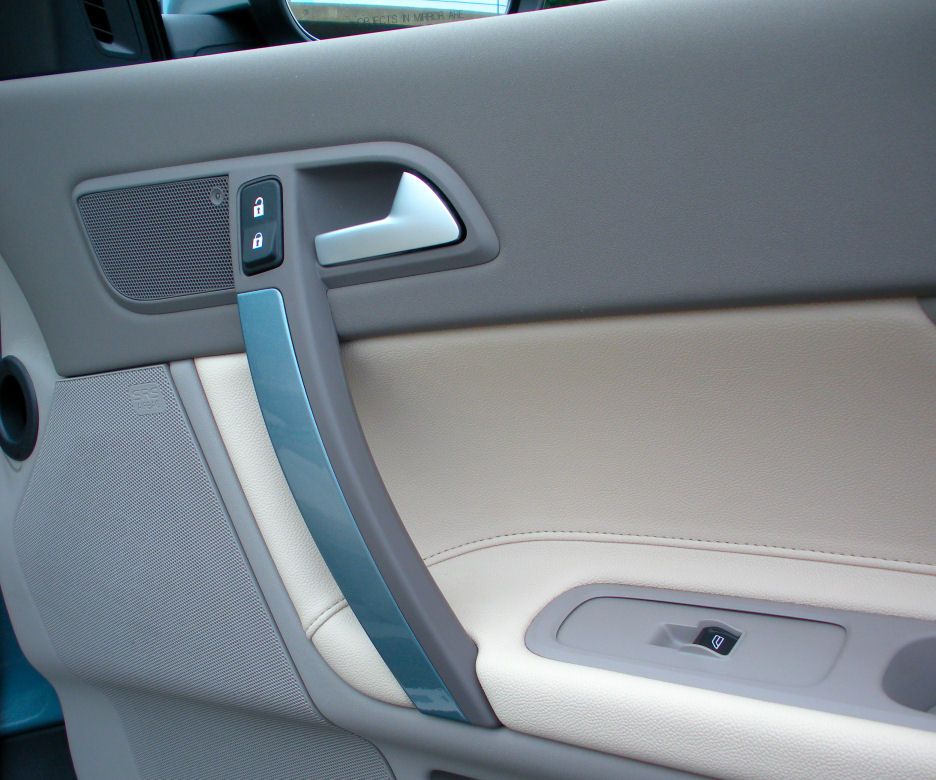

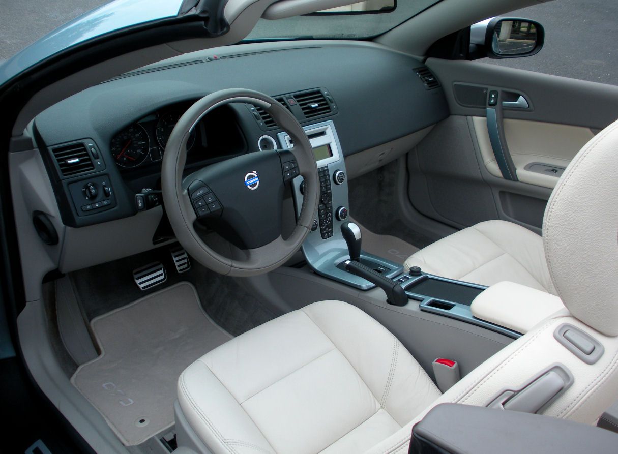

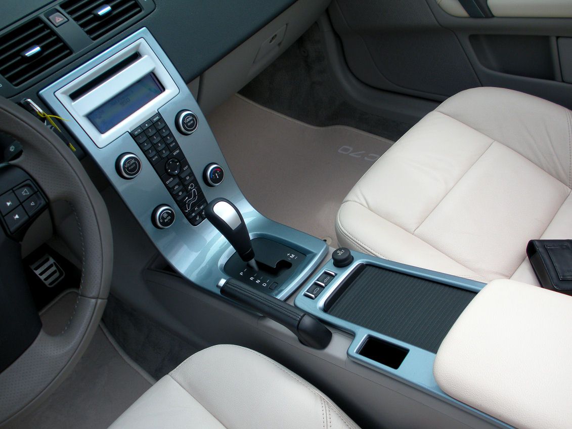

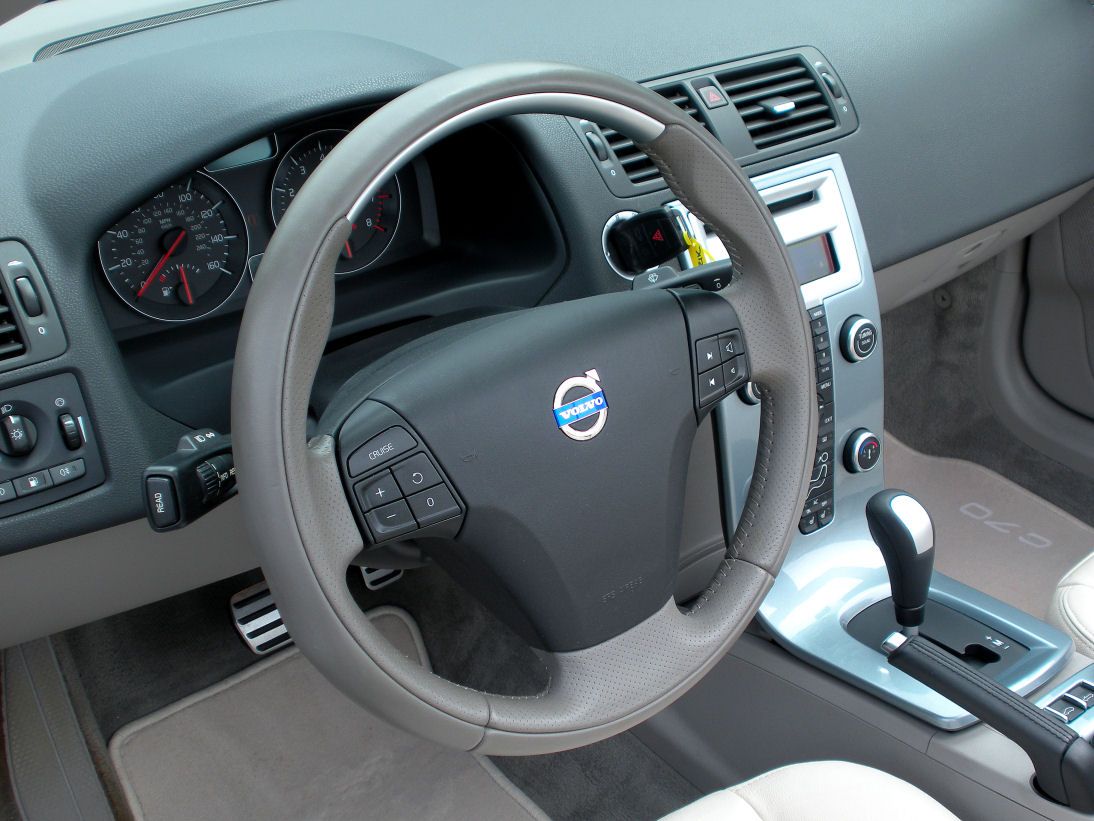

The interior mods were a little scary as I thought my ideas may be a little over the top. It actually turned out to be the wife's favorite part (and I really like it too :p ) . We did the waterfall, console, and door handles in body color. I shot the radio surround in satin to match the 4 knobs on the waterfall and debated it before doing it for a long while. I am happy with it. I also added the Volvo satin silver inlayed shifter knob, the Volvo aluminum pedals, and the sport steerting wheel this car should have come with from a 2007 model from the boneyard (Erie Volvo).
Even the service advisors at the dealer said this is the way the car should have come from the factory. It could probably handle a polestar upgrade now, but I drive it like an old grandpa and just cruise around town. She satisfies me for being a 5 1/2 year old car with nearly 60K on the clock and now I look forward to the next 5 years with her ... and maybe more.
Lastly, I am getting a vibration commonly referred to here as "brake judder". Levi confirmed that I am due for new brakes and the rotors are the source of the vibration. This is the 3rd set of brakes I have gone through on this car and am convinced the OEM rotors and to a lesser degree the OEM pads are the culprit. I have sourced a new full Stoptech package with aramid (309 prefix) pads and high carbon drilled rotors. More pics to follow in a week or two when I get the parts and have them installed.
Beautiful car! I really like the custome paint work on the waterfall. Looks sharp!
gorgeous car!! and nice photos.
the drop and 19" wheels looks so right... minimal gaps just looks so buttoned down. i wish my roads were better so i could do the same because it looks amazing. great to hear about the wonderful performance and comfort of the bilstein b8/h&r combo. have to admit i shied away from bilstein mostly because of concern for comfort. their reputation is certainly solid for performance and reliability.

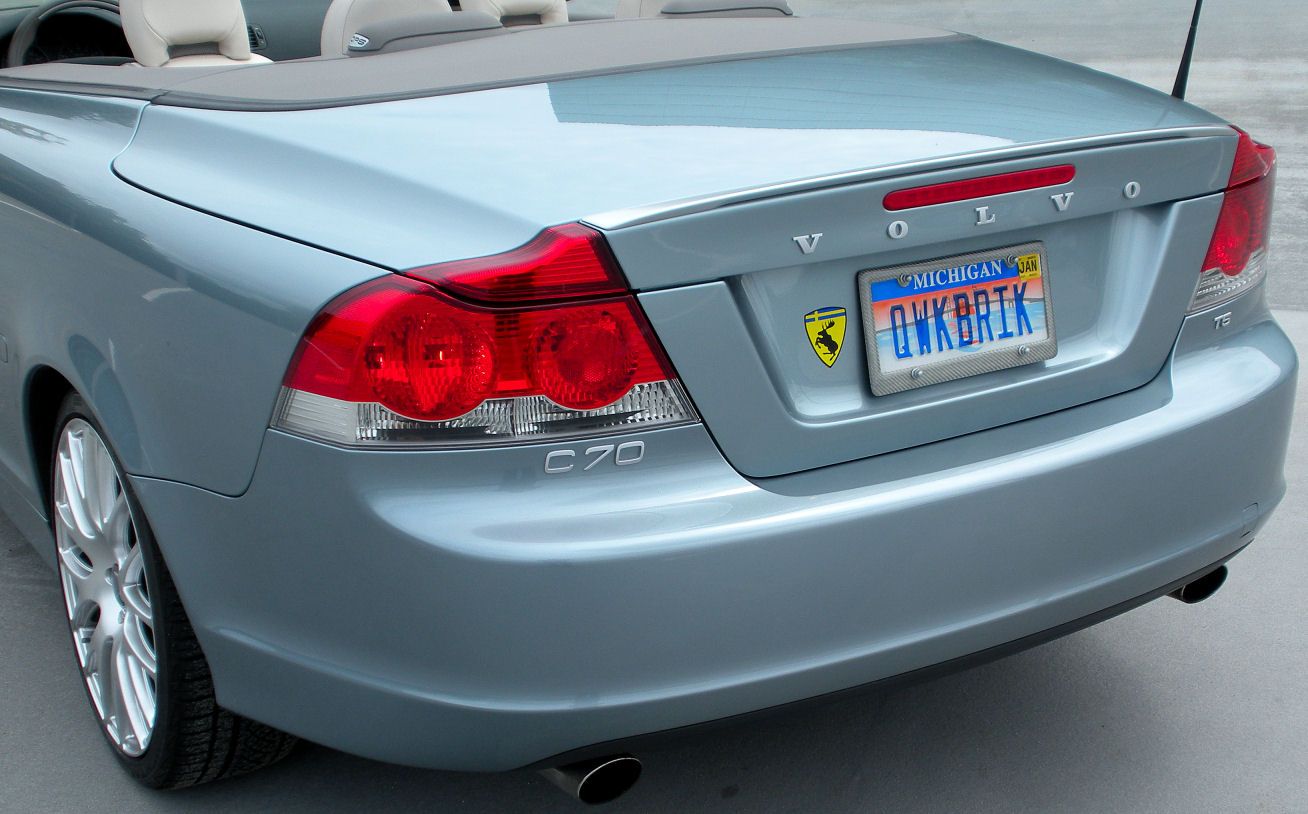

definitely beautiful interior detailing and unique color match for the waterfall. but i really like the widened volvo logo on the rear. did you do that yourself or the body shop? i seems easy enough, and something i' try...i just don't know exactly how to re-attach (glue? tape?) after removal.
with the suspension upgraded and brakes soon you're definitely ready for a tune - polestar or others. your c70 will be the better the inscription volvo sells!
... i really like the widened volvo logo on the rear. did you do that yourself or the body shop? i seems easy enough, and something i' try...i just don't know exactly how to re-attach (glue? tape?) after removal.
I simply pulled off all of my old emblems, sanded them, painted them, and reattached them myself with 3M body molding tape (that foam stuff you can buy in any automotive part supply store). Since I had the rear bumper repainted I had to pull the C70 and T5 badges anyway. I used a picture, some painters tape, a ruler, and a pen to line them up and apply the VOLVO emblem. I have no idea how close they are to the actual spacing of the new models :p .
I used an exacto knife and some paper templates to cut the tape and apply it to the back of the newly painted emblems. It was quite easy to do ... just took a little patience.

QB - looks great. The blue waterfall, door handles, etc. are very distinctive and classy, and that grille looks way better than the factory black. You definitely got the rear badge V O L V O spacing right - the L is centered with the high-mount brake light, with the O and V on either side, inside the lens. I am not sure but I think the size of your badge letters is just a tiny bit smaller than the size on my 2011, but I can't really tell.

Yes regtor, I thought I was close on the letter spacing ... like I said I just reapplied my original emblems after I painted them and simply worked with a picture to place them. I observed the same thing; that the O and the V on either side of the L seemed to sit just inside the edge of the brake lamp, then simply spaced out the letters on the ends the same distance. I noticed the same thing about the letter size over the weekend and I do believe you are correct ... my factory 2008 letters are slightly smaller than your updated 2011 ones.

Quick Brick, i ordered the same shocks and springs as you based on these pictures and your brief review.
have you had the alignment done on your car since lowering? i am wondering if i need to order the SPC rear camber arms to get a decent alignment.
thanks!
Your car will ALWAYS ALWAYS ALWAYS require an alignment after a drop. That being said the camber arms will definetly NOT BE REQUIRED. I did purchase a set of Eibach Pro-Alignment bolts, part number 5.81310K (+/- 1.0 degree) to allow for some additional adjustment, but the dealer did not need them to bring the car back into spec. You should be able to find a set for 20 - 25 USD just to have during the install for precautionary measures. If the drop were more radical they also offer bolt part number 5.67420K (-1.50/+5.0) but this would only apply to somebody cutting coils or going with a coilover setup. I would not recommend either on this car for street use. I think the first number will accomodate any aftermarket spring you would care to purchase for this car as they all seem to indicate a 1.2 to 1.3 inch drop.
Be sure you order the B8's and NOT the B6 variety of Bilsteins. These shocks are specifically for lowered cars (the B6's will work with the OEM ride height). I would suggest FCP Euro for the rear shocks specifically as they can be hard to find and some of the listed prices on other sites are rediculous. I had to wait several weeks for mine but I think Bilstein shipped in a batch. In talking with these folks last week they had them for 150 USD each and had them in stock, part number which is specific to a lowered C70 only is 24-142199. I sourced my H&R's (29115-1) and front Bilstein struts (R = 35-110774, L = 35-110767) from Tirerack.com . Hope this helps.

that's impressive you were able to get alignment in spec with the stock camber arms. are you close to an extreme (ie. -2.3-2.5)?
i guess i could've tried stock but didn't want to pay labor twice and folks seemed to suggest adjustable camber arms would be needed.
so got the massive system arms - given i'm going for minimal drop i probably could've saved $175
#19 · (Edited)
Sorry, I did not get the alignment readout from the dealer but will ask for it when I go back to have my brakes done. You can pass judgement for now based on the pics above. I certainly don't notice extreme camber but will wait to pass further judgement based on tire wear. That may not be a really good method either as the car corners terrifcally now and I am having fun using that new feature :D . We may go through tires a little more quickly now as a result ;) .
I did specifically ask about the alignment and the need for additional parts because Brian and I discussed bolts versus arms up front, and he was even able to return the bolts to me when the job was complete stating they did not need to use them. I know a lot of the S40 / V50 guys need the adjustable camber arms and in the grand scheme of things 175 bones is not a bad investment in precaution. Far cheaper than having to go back and implement a solution after an already costly installation.
#21 ·
your camber looks great and based on how the car is handling, it sounds like you're in good shape!

just re-badged the "volvo" to "v o l v o" following all the excellent tips.
floss alone wasn't working so i added blow dryer and that got the emblems off.
goo off worker great to get the area clean. exacto knife to scape away old tape. scissors to cut little bits of the 3M tape to re-apply.
took some time but satisfying time killer.
