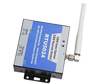

View attachment 152379 View attachment 152381
Hi, I have webasto from factory, 3.2 and I want to add 4G relay to be able to start webasto anytime. Can you share which cables/pins are used to start/stop webasto? If remote is steering, then only remote cables if you have diagram or any info which cables are responsible for which signal.
I saw that 1 guy connected relay output to start/stop button of the timer and it works without any other modification
if you have part number it will also be helpful, my friend has Vida, so I will try to get more info

Volvo uses a device from Webasto for remote start of the heater, Telestart T91(R), but for mobile start you need another Webasto device, Thermocall TC4 but it's 3G. There is no 4G solution readily available.
