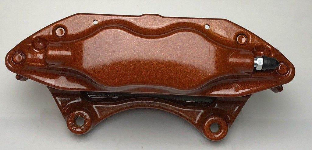

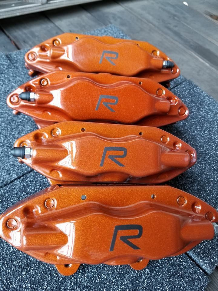

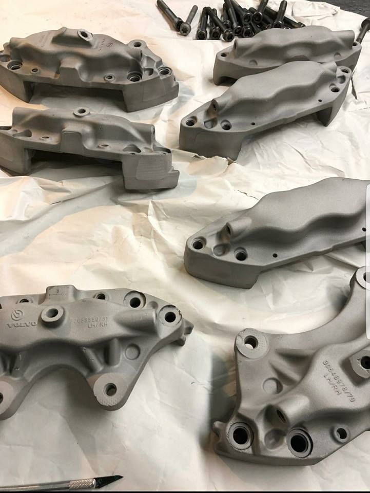

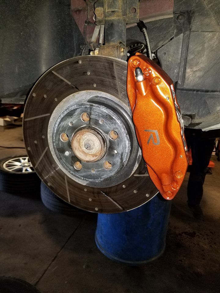

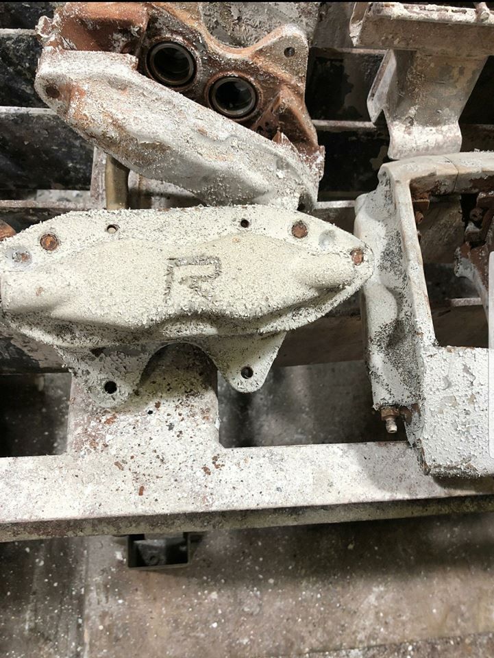

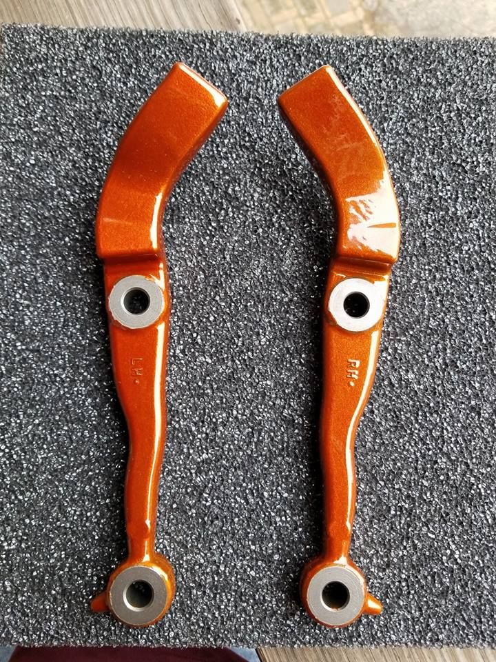

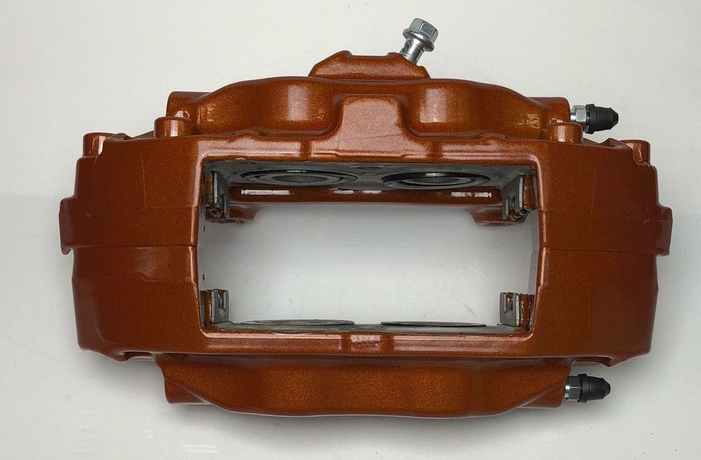

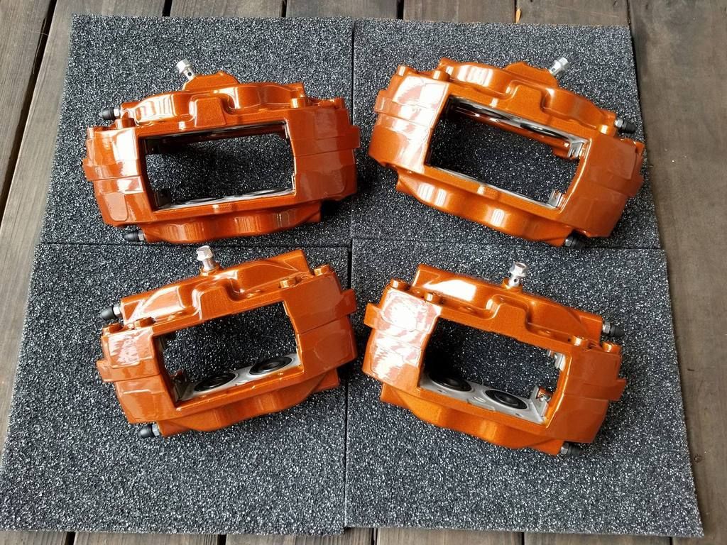

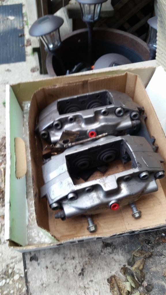

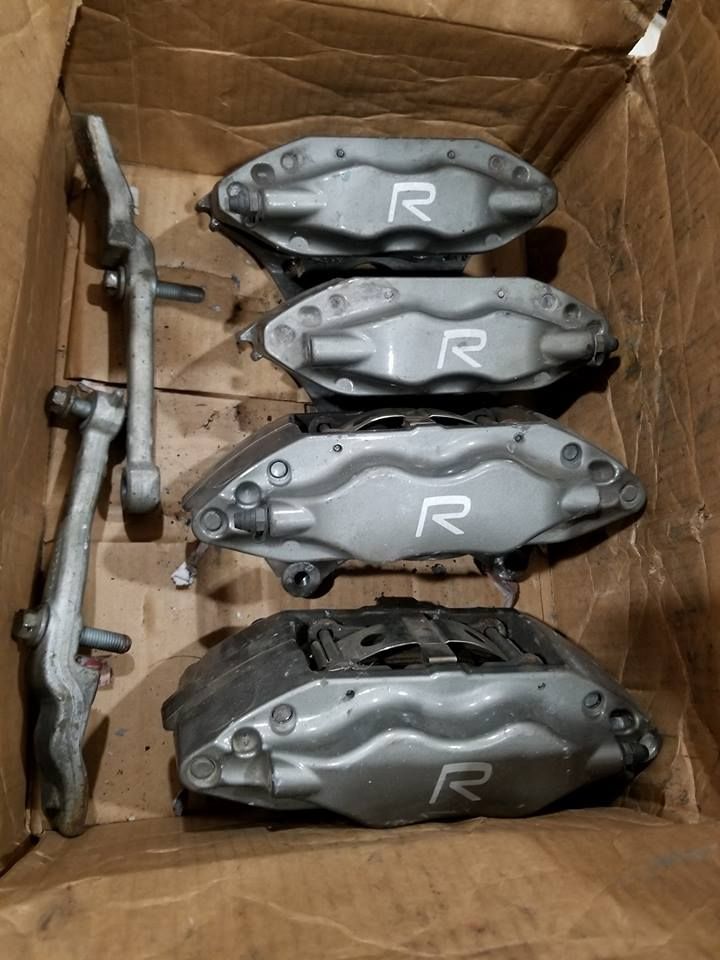

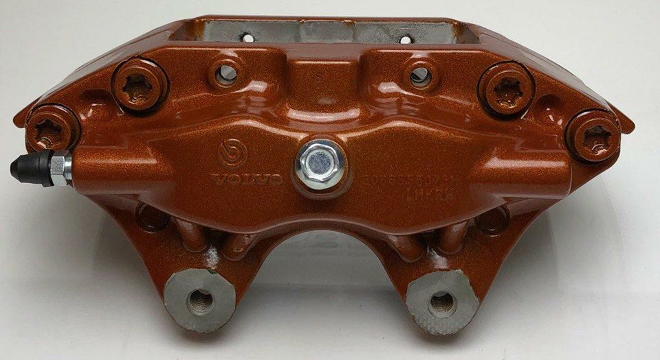

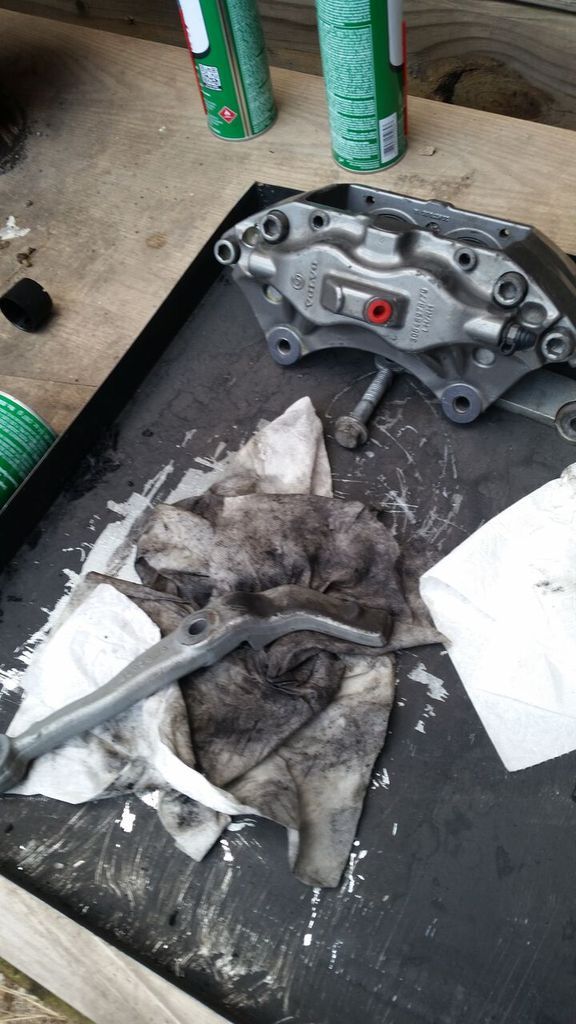

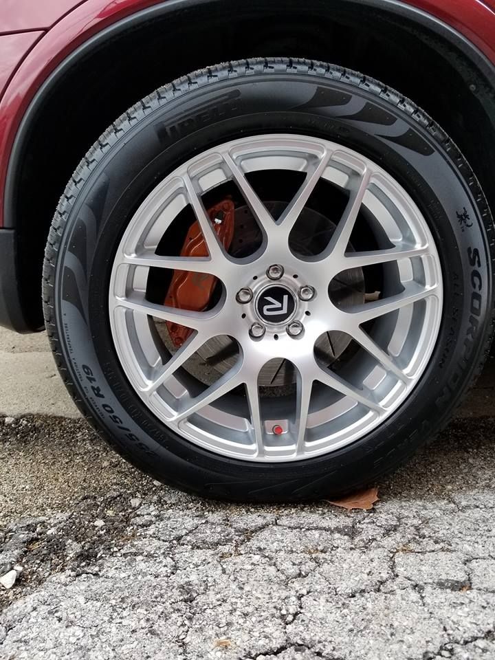

I purchased a used set of S60/V70R BREMBO Brake and had them strip down to replace all the Brake Caliper Piston with a new Boots and Seals kits when all strip down I had them bake in the oven to burn off the pant and any oil residue. out from the oven I took them to a professional powder coating paint shop to complete the work. install all new hardware kit to the calipers and install them to the car with a new set of wheels.
I add some pictures, sorry in advance for not adding the work from the Oven, installation of the seals and from the paint shop only final work.
I hope you like, let me know what you think.
