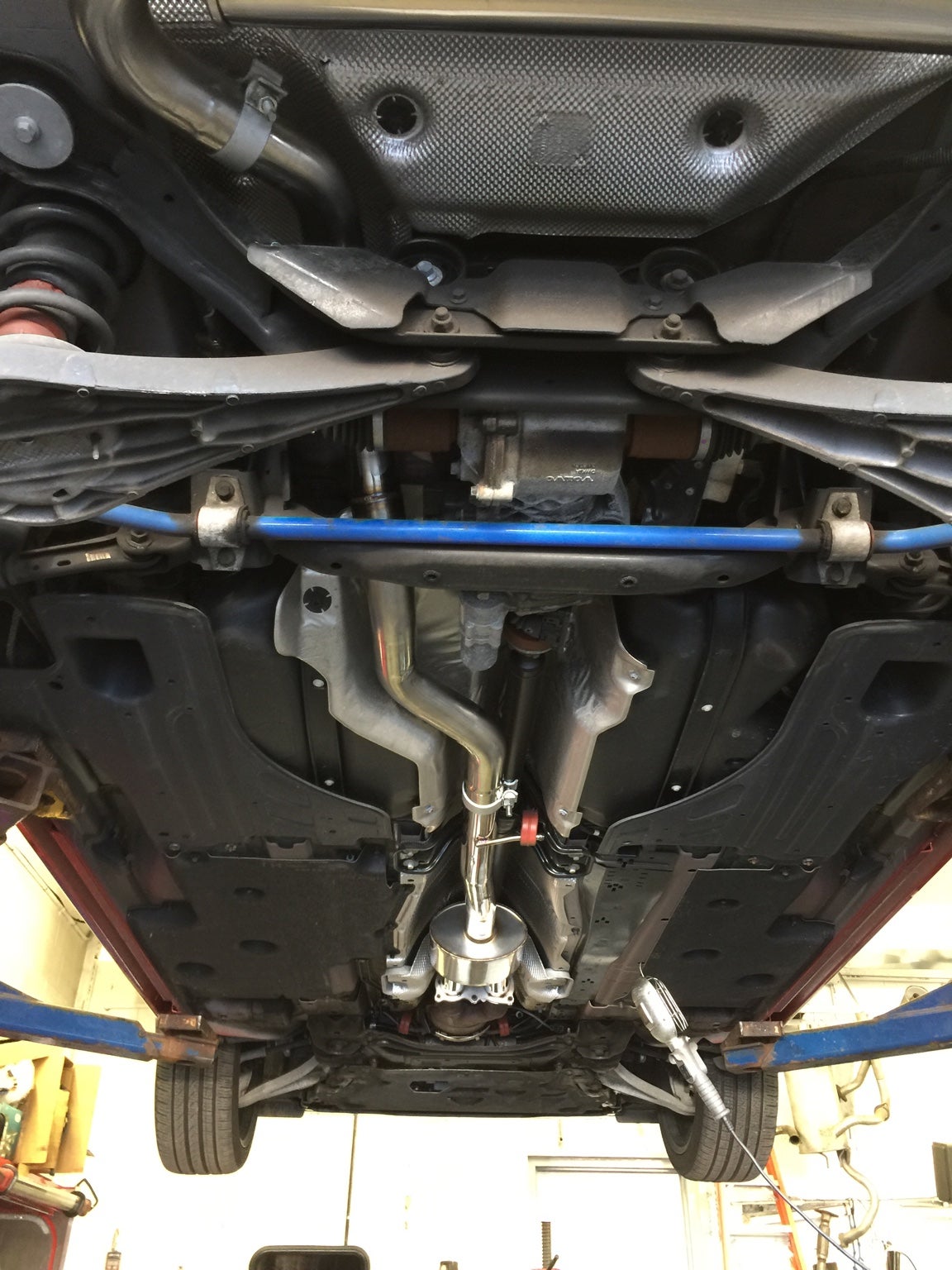

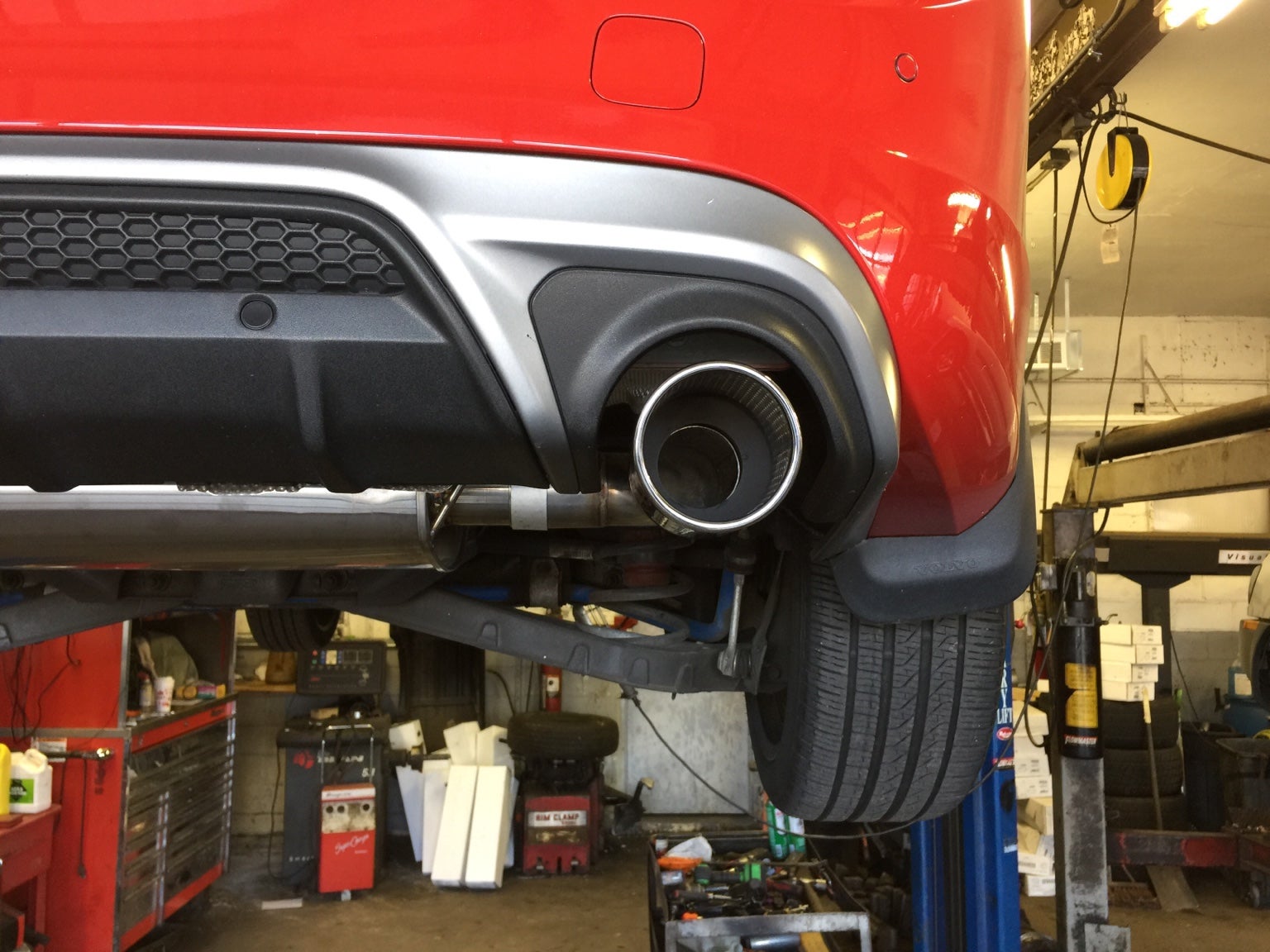

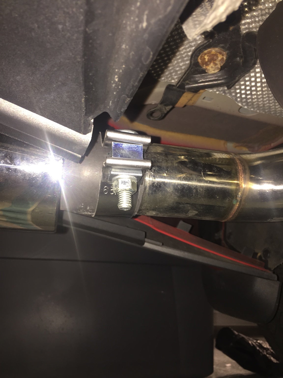

The install was very straight forward and took less than an hour to complete. For my install I had a local shop with a lift do the work since I didn't really have the time to be crawling under my car. The did make a clean cut in the rear axle area to easily remove the OEM exhaust and this way I can always have the OEM exhaust reinstalled if I ever sell the vehicle. Here are some of the pictures of the exhaust installed:

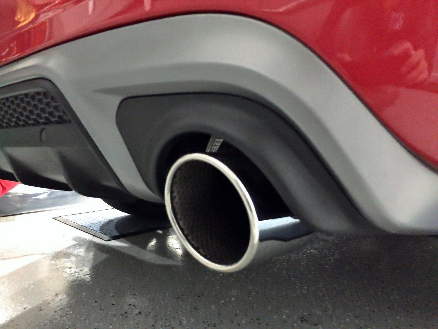

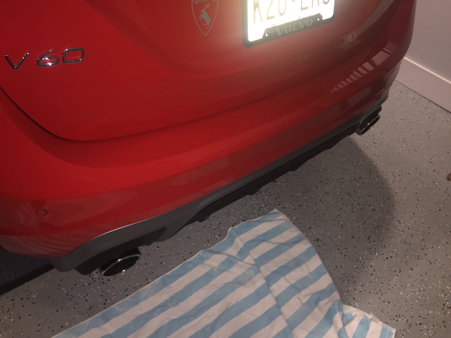

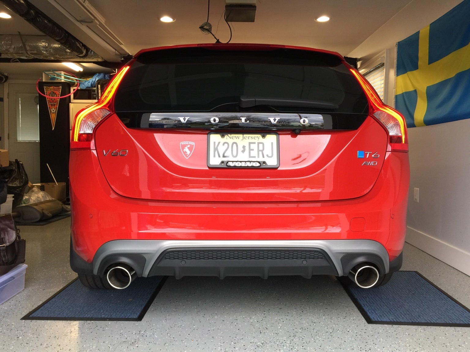

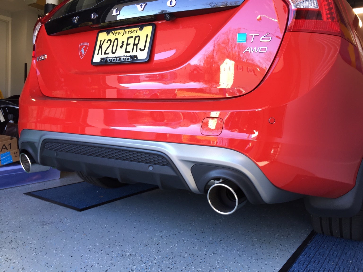

Here are some pictures of the exhaust:

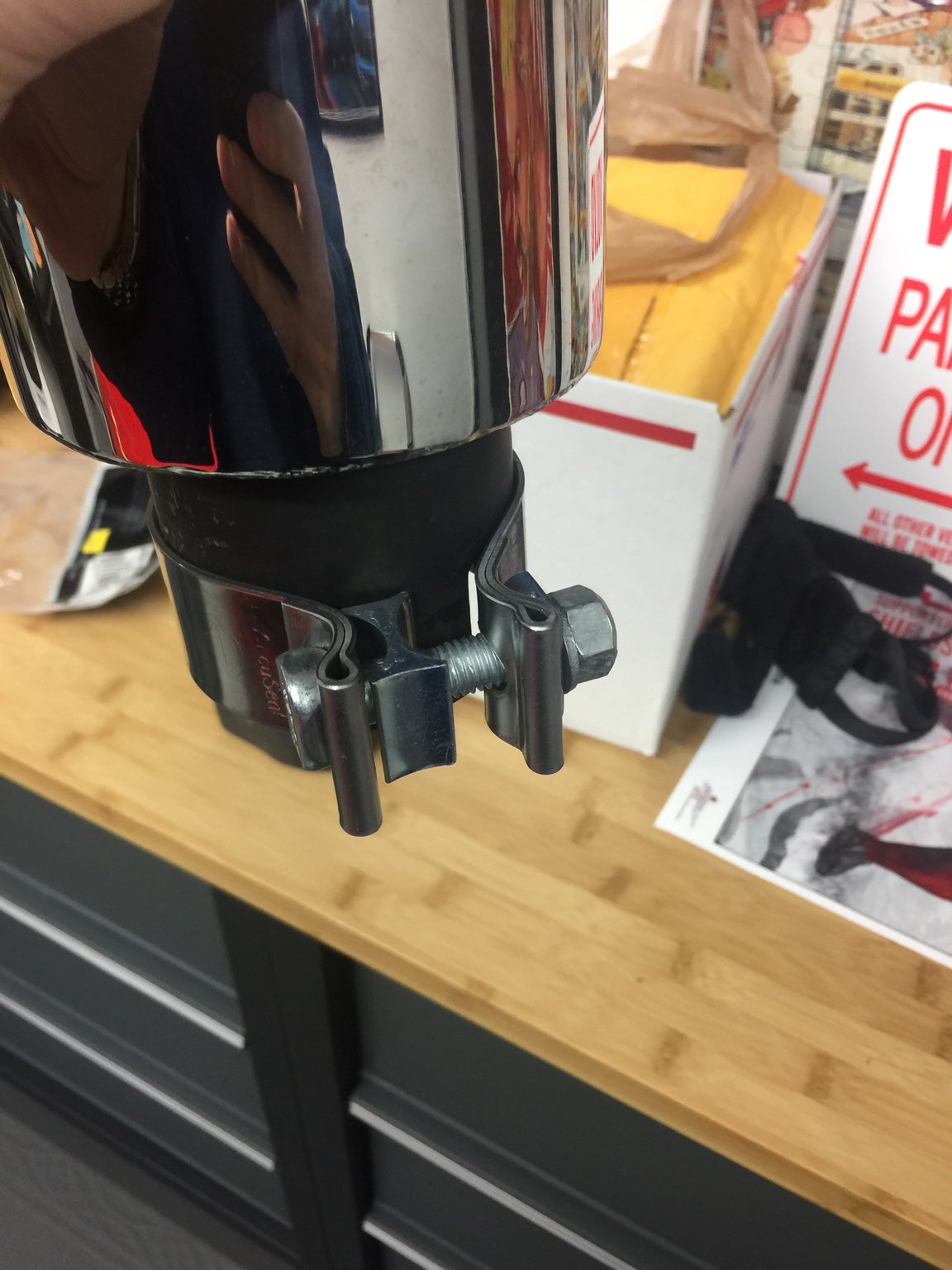

~Swap out the V-Band Clamps for the Exhaust Tips for a more traditional exhaust clamp - I mentioned this to Chris @ IPD and they are working on changing this clamp. Here is the SS Exhaust Clamp I used:

Thanks! The two are fairly comparable in price with IPD having the slight advantage in pricing. How was your exhaust tip alignment once everything was installed? Another member on here had it installed on his V60RD and the tips seemed too short and he had to replace them with other ones. The droning noise that myself and other owners of the KPAX/Jetex systems is mild, nothing that is making your ear drums bleed but you can notice it with the radio off cruising at highway speeds in the 2000-2500rpm range above 65mph.

Looks like a great setup! The tips are the perfect size. I like the clamp you used for the tips!

Thanks Chris! I think IPD will be using those clamps for the exhaust from here on out; I actually just received a box from them containing a new set of these clamps for the exhaust tips. The exhaust is definitely louder than the Heico one I heard a few years back on my buddy's S60 T6. I think it's coming across as well on the videos that I'm shooting, but under normal driving conditions it's pretty subtle. Hopefully I will be able to make it out to Carlisle this year and you'll be able to hear it in person.

I recently got this cat back on my 2015 s60 t6 RD, and I as well am very pleased with the difference! Some things to add though, it seems like they did change the clamps, as the ones that came with mine were very similar to the conventional clamps. About the droning, I do notice it around the same rev range, but it is very minor on the s60, and does not bug me at all.
