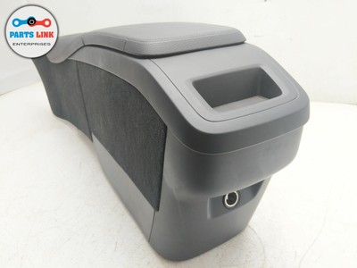

But the thing that is most missing in my XC90 is a place to put a Kleenex box. Ideally, I was thinking it'd be cool if somebody could create a 3D print model to fit a Kleenex cube immediately behind the front center console so the front seat passengers could reach around to grab a tissue. It could sit on the floor and have sides that extend over the sides of the center console to mount it. It'd end up right in front of the lighter port on the back of the console so that would need to be turned into USB jacks on either side of the Kleenex holder. The placement behind the center console would mean no legroom for a middle 2nd row seat - but with the seat removed, it doesn't matter. :)
Alternatively, the aft plastic panel of the 1st row center console (pictured below with a USB adapter occupying the 12V DC socket) has some space behind it. Perhaps it can be modified to house a half height box and a slot on the panel for the dispense.
I saw this ebay picture of a center console from the bottom view. The metal frame and that aft plastic panel has a bit of a gap.
A standard box fits between the 3rd row seats:
You lose the "storage space" that the box sits atop of, but that's not too bad imho.
