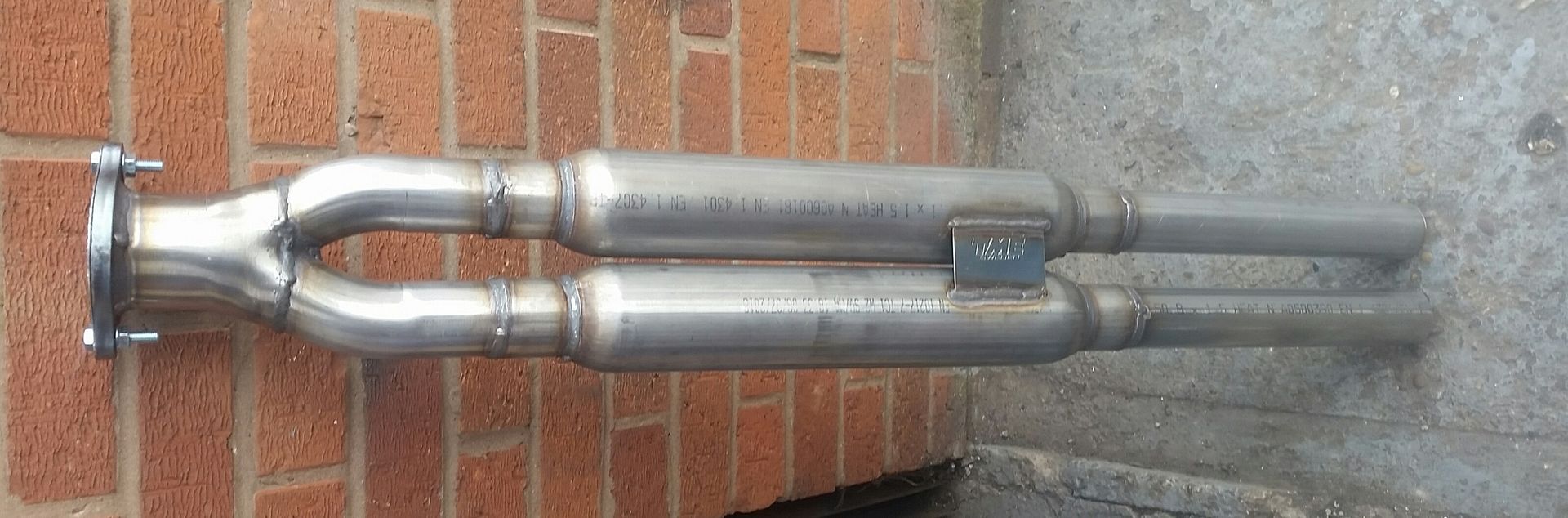

Yeah I like that look too. I have similar on mine but with the blue tip. Its a love hate thing with it cuz simple polished is also nice..I'll keep those tips in mind if I don't like the dual blue tips.....the picture i posted is of the Y ...was wondering which would be best to use.
