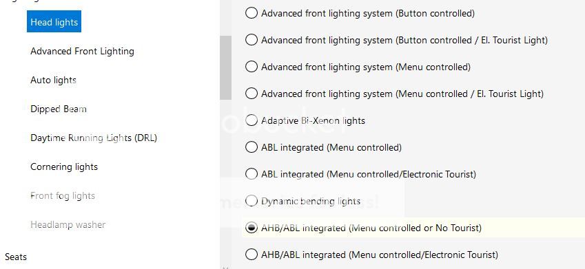

Once the headlights are installed, use VDASH to change the headlight selection. I went with
"AHB/ABL integrated (Menu controlled/ No Tourist)", I tried a few other but noting happened with the headlight switch to low beams.

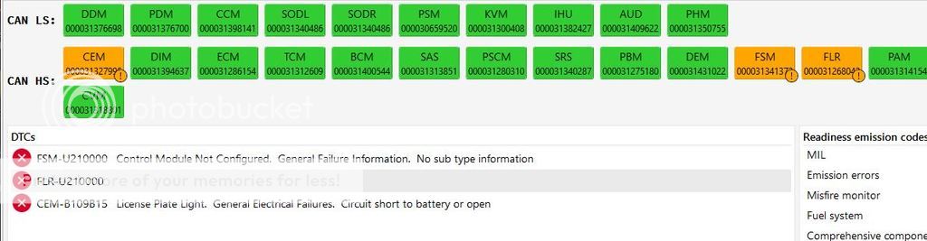

I went back to VDASH and found this:
Tried it but ended with:
So that's where I am now regarding the adaptive headlights.
I sent an email to VDASH and I hope they can help me on this.

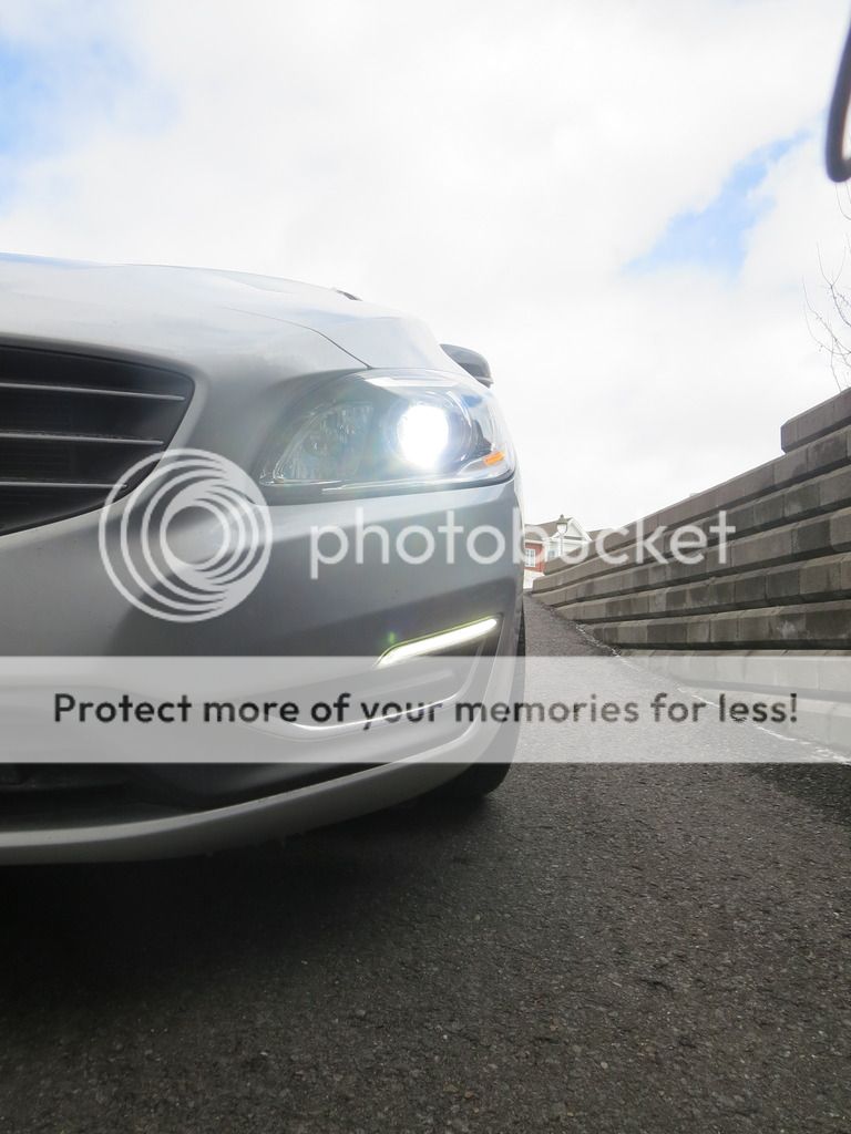

end result with OSRAM CBI (Cool Blue Intense) that are in no way blue but a nice white color that matches closely (not perfectly) the DRLs
I'll get some nicer pictures later:facepalm:

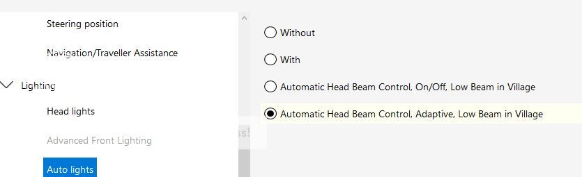

The proper combination of settings in Vdash are:
Headlights : AHB/ABL Integrated (menu controlled or No Tourist)
Advanced Front Lightning : With
Autolights : Automatic Head Beam Control, Adpative, Low beam in village
With these settings, no more errors regarding module configuration.

After VDASH make change to the CEM,New DTC FSM-U210000 & FLR-U210000,I found the DTC display after adaptive setting change, So I select “sensor alignment”&“camera alignment”in the FSM,and then go out ride 5-10miles,everything ok now. I will do a diagnostic tomorrow again....
