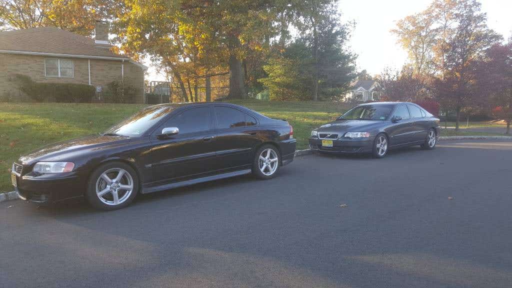

Hey guys and gals. Hope everyone is enjoying their Thanksgiving weekend. Just wanted you're opinion on this. The grey R you see in the picture, im thinking about doing a bigger turbo setup. My thing is I would like the big hp increase but not the huge boost increase. So what numbers are you guys running on the k24 hybrid and is worth it? Thanks for reading. Matt
