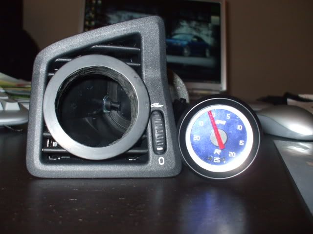

Okay so to piggy back off of Blurry's recent thread, I installed the IPD R gauge with (Brian) Bpray9223's side vent gauge pod. Hats off the Brian, the quality of his product was top notch and I was very pleased with it!! However as I found this out the hard way if you are going to use the IPD gauge with this Pod beware… Depending on where the fittings are placed , you will not be able to slide the gauge all the way into the housing since the fittings touch the side of the inner piping (as on mine).

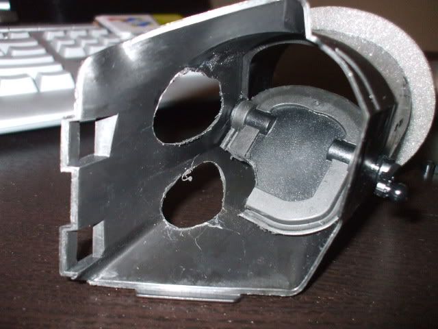

Brian was telling me he has installed some IPD gauges with his pod and had to trim the inner vent flap (pictured) for it to fit. The fittings sat differently on mine so I worked. If I turned the IPD a quarter turn to the right it would have slid in all the way.. So I had to hack the hell out of it to fit (pictures below) to get it to work. I later stuffed weather stripping around the holes and the fittings to keep everything nice. I can still feel the Air come through the vents so I know its good.

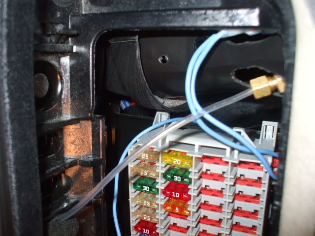

The install was a bit more worrisome than I expected it to be but I finally got it.. If you have an 07 R the side fuse panel as you saw in Lucky's Vid is useless.. all the fuses were hot. I had to tap into the Fuse 10 below the steering column and used a "add a fuse" with a 7.5 volt fuse for the accessory light for he IPD gauge. I didn't feel like hacking up any wires so I went this way..

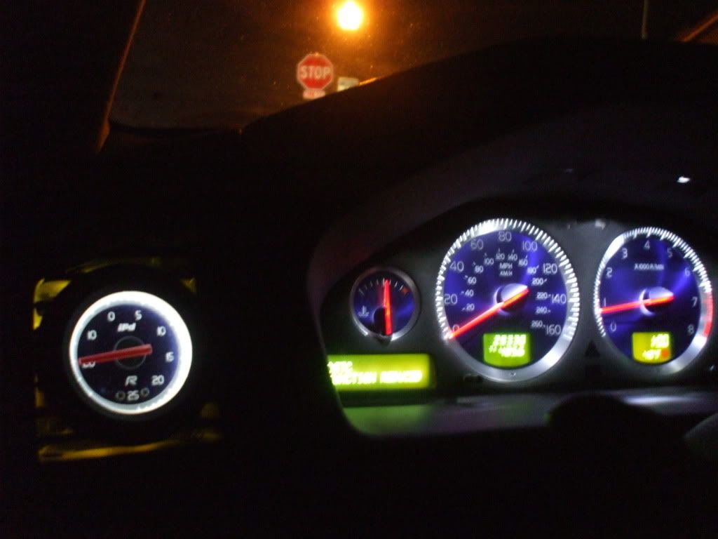

Over all the boost gauge is working fine, everything lights up (finally). I'm peaking about 15-16 PSI but it holds steady at 15 Lbs when I'm WOT for a long period of time. Hitting advanced mode and romping on the throttle I saw it hit 17 lbs.. Pretty crazy! I'm running the MTE Stage 2 and IPD down pipe. So after a few runs and listened for any leaks nothing was found and everything checked out fine.

boost guage and brians vent pod

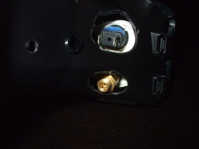

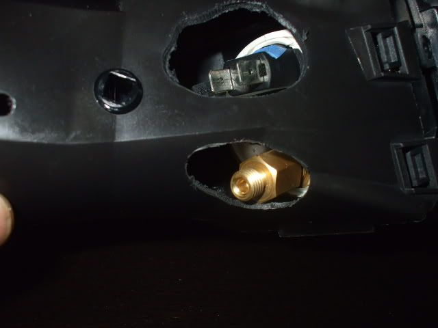

Hacking it up with a dremel once i figured out the hard way it would fit all the way.
rear view..

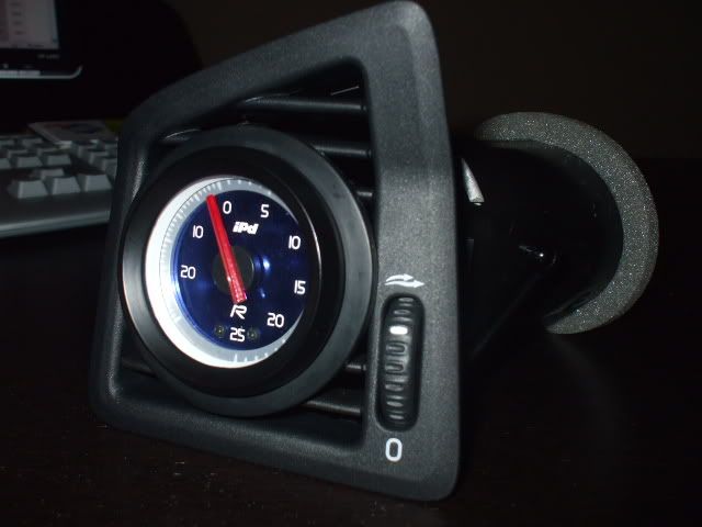

All put together..
Installed into dash.

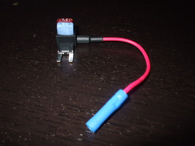

Adapter used to tap into the fuse pannel under the steering wheel above pedals.
Tapped into fuse 10, cig lighter, using 7.5 fuse for IPD light
Finished Product
All gauges!

I don't know if there is a difference between 04 and 07 regarding the vent tube/flap, but I didn't cut the vent flap at all and I can still close/open it (it's very close though). Also, I have painted boost gauge body to black to stop the light inside the vent tube that can be seen through the vent. I noticed this after I installed the gauge, so had to remove it, paint it and install it again.

Looks great, you just saved me a lot of work (I was trying to do the electrical part of this last night). I suppose you've got totally different stores than me but where did you get the multi-fuse tap?
From an electrical engineer's point of view I'd probably lower the fuse value for the lamp quite a bit. I can't imagine that LED drawing more than an amp so a 1.5 fuse would be "safer" (suck less current through whatever you've shorted out on), but then again, it'll probably never cause you a problem.

Ill take your word on the fuse. It comes with like 5 fuses so i figured the 7.5 would be sufficent since I was putting it in a 15 amp fuse socket. Ill replace it with a lower one.
The add a fuse you can get at pepboys ( im sure you have one of those around you). Its from "Littlefuse" part number OFHM0200ZP for $9.49. it also has a sup. part number of FHM200BP.

Anybody can tell me where to get that fuse adapter for the fuse box? Maybe somebody has a link for me, maybe even in Europe.
I searched for months for that solution because I did not want to just plug the wires into a used fuse.
Would be very cool
This is what i used!
http://www.amazon.com/Littelfu...90159

Gauge looks good in the vent. I thought about locating mine in the vent but opted for the IPD mount because I can keep my eye on the road better when the gauge is mounted up there vs. the vent.
