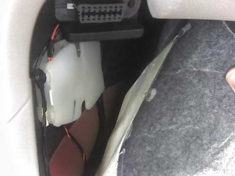

The footrest, believe it or not, isn't on the floor. It's on a hunk of wood or particle board which is backed up by a wedge of foam. Behind the foam is a wiring harness and a sort of plastic clip which must hold some option I don't have:
I used some 1/2" #4 aluminum sheet metal screws to attach the footrest, which avoided any possibility of piercing the wires you can see snaking vertically down the center of the photo, but I moved them aside anyway:

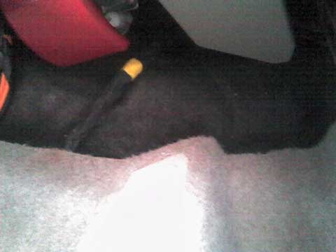

The footrest is the overexposed triangle below the red hood release latch and the yellow-banded black wire is the same one in the previous photo. I then simply screwed the footrest over the existing rubber platform, due to the tiny screws no drilling was needed, and the backing board holds them quite well. I used aluminum screws because they are more compatible with the aluminum Heico rest.

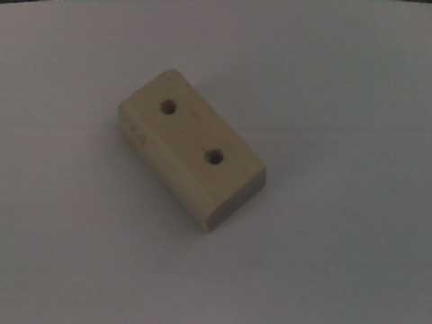

On to the clutch, I fashioned this shim block:
It's about 2 1/2" long and, in this initial photo, about 1 3/8" high. The flat side at the top right goes against the back of the clutch pedal and the slight curve to the front left corner is intentional because of the shape of the carpet.

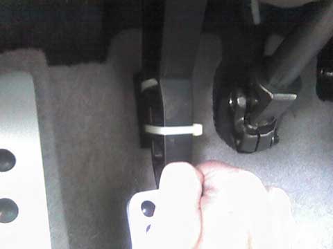

Here it is painted black and mounted:
Note that the opper tie-wrap goes through the pedal web. This is needed because the pedal arm tapers toward the actual pedal, the block slides down otherwise. This hole does not compromise the strength of the arm in any way as it only goes through the central web and is quite small.
Here it is in operation:
It may not look it, but the block is flush against the floor. After some trial and error I trimmed off about 3/8" of the height so it is now 1" thick, reducing the clutch pedal travel by about that much.
Actually maybe I should say making the clutch "solid" at about 1" off the floor. What I was finding is that the darn pedal went so far down, and so far past what was needed to disengage the clutch, that I lost the feel for where the engagement point was. Having a nice firm stop changed all that.
