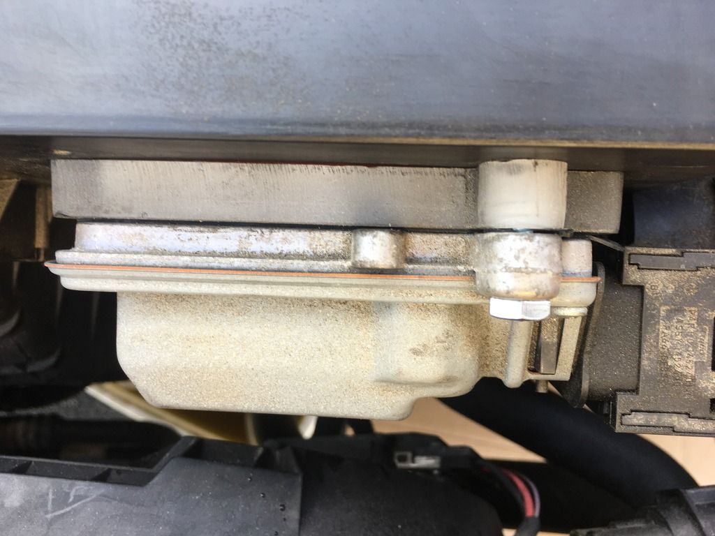

When i installed my GoVo spacer in my 04 V50 i couldn't put the cover back.
Made a nice adjustment so it still fits now and i'm happy with the spacer
#17 ·
Nice work. I may try that if shaving the ribs doesn't work.
