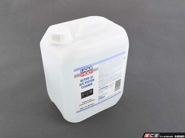

Here are some specific solutions to the issue.
Europeans have been using these for long time and have specific shops that treat all the mold and smell blowing issues.
I’m posting some that are available for home use.
Hope it will work for some of you guys.
nextzett 96110515 Klima-Cleaner Air Conditioner Cleaner - 10 fl oz https://www.amazon.com/dp/B0002Z2MKO/ref=cm_sw_r_cp_api_glt_i_M6JGDRKRQCDTC6MPB0MG
Lubegard 96030 Kool-It Evaporator and Heater Foam Cleaner Amazon.com
Wurth A/C & Heating System Treatment 16oz. Amazon.com
Wurth use to come with the tube but I don’t think it is included.
The liquid for above sprayer

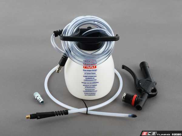

Here is a polish guy using one of the products.
He located the drain from which ac evap water drains under the vehicle and sprayed the coil with the product. He called it Bomb.
Use google translate if you want to read it.
If you want to go all in this is the newest way of getting all the bad Sh… out of your aircon system. This will use ultrasound to break some chemical particles in the chemical liquid turning it into steam and killing it all under 15 min.

I had the same thing happen on my prior gen 2008 XC90. Used an entire bottle into the intake area and in the vents directly for good measure. Let it sit and then aired it out. Problem was solved immediately and has not come back in 2 years. I highly recommend giving that a shot.
