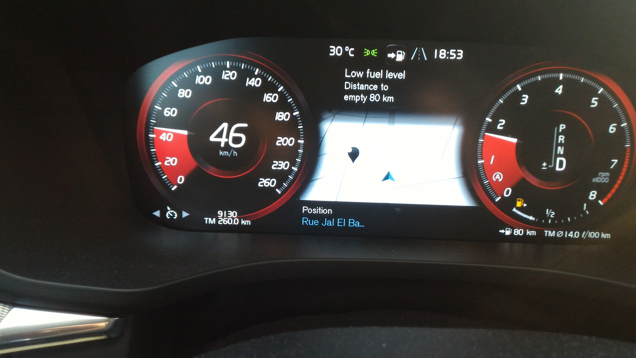

XC60 T5 MY2018 Fuel Consumption
Yesterday I was surprised, at more than 1/4 of the tanks I was warned: Low fuel level , Distance to empty 80km
For the last six days I have been constantly using the car to drive in city.
I filled up the tank on Sunday and crossed 260km
It turns out that the T5 consumes 17.1 l / 100km in the city

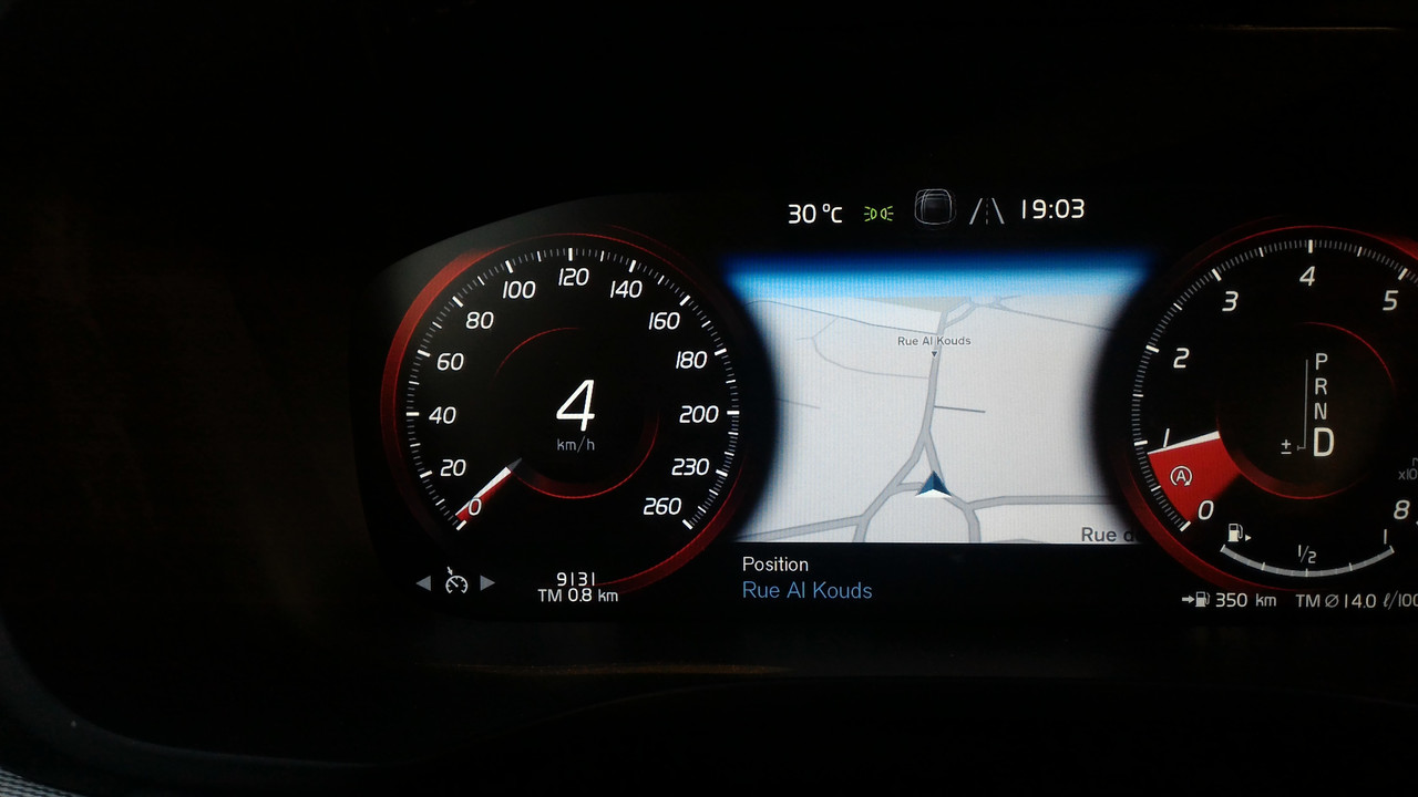

I went to the gas station and filled up the tank, computer show me out so I could drive 350km with a full tank.
To mention my tank is 60l
Volvo declares that the consumption in town 9.4 l / 100km, of course I expect to be around 13-14l / 100km but 17,1l / 100km disaster
I would love to know under what conditions and in what city Volvo received a fuel consumption of 9.4l / 100km

The calculation for Distance to Empty is based on recent driving. I don't remember the specific numbers, but it uses the last "x" miles or kilometers. There may also be a time factor.
So since you have driving all city recently, it is using that to make the calculation.

Straight out of the owner's manual:
This calculation is based on average fuel con-
sumption during the last 30 km (20 miles) and the amount of fuel remaining in the tank.
When the gauge displays "----", there is not
enough fuel remaining to calculate the remaining
mileage. Refuel as soon as possible.
NOTE
This may vary if your driving style changes.

Yes the T5 is a two tonne car starting and stopping in the city with a consuming 2.0 lt engine. 13lt/100Kms to 14lt/100Km with a heavy foot is logical. Besides on both your photos it shows 14lt/100Km so it is within your expectations.
