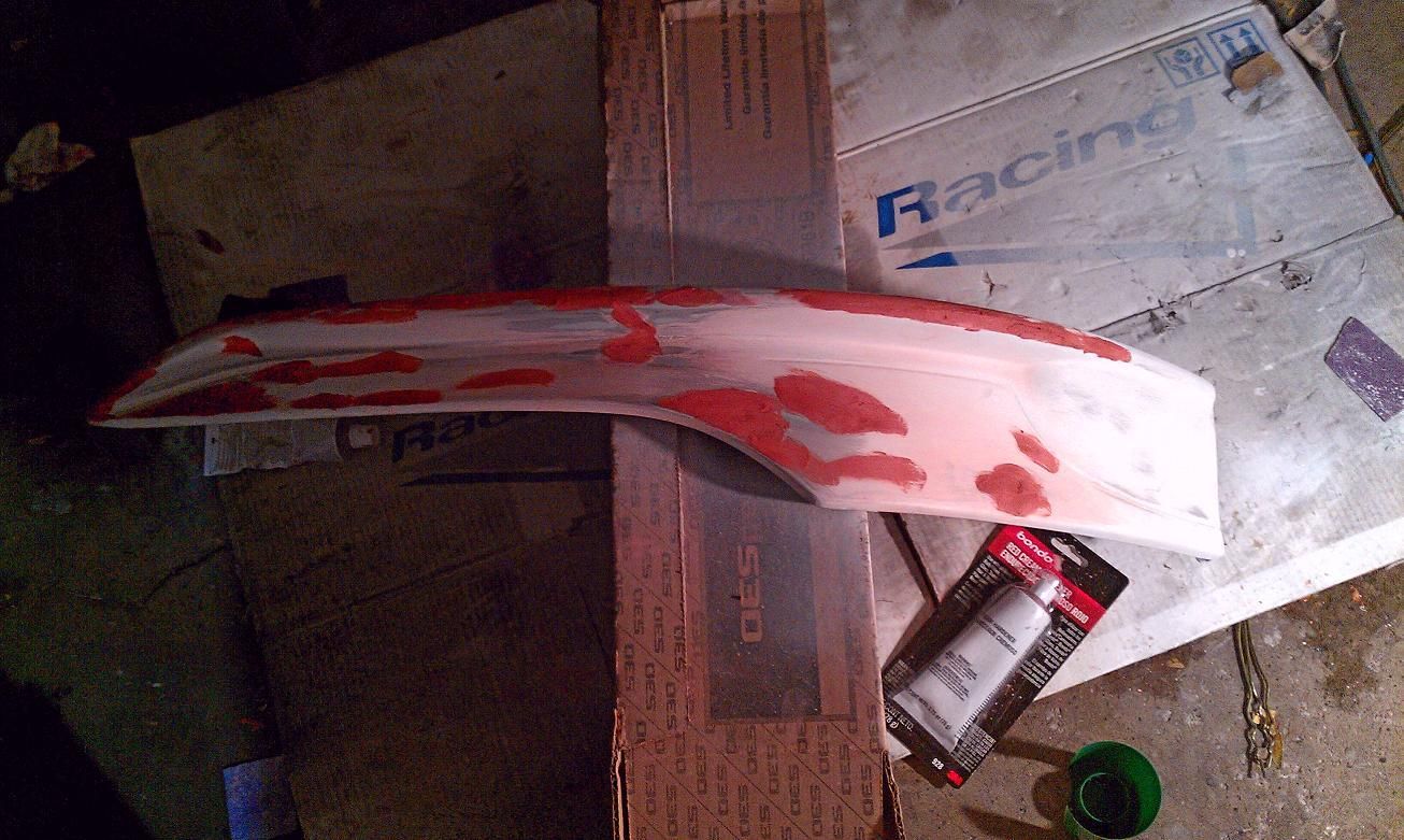

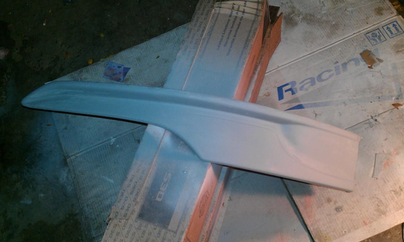

Third attempt at doing some minor body work. What do you think?

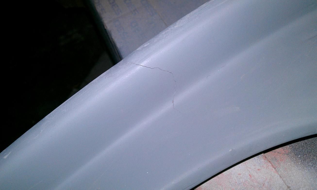

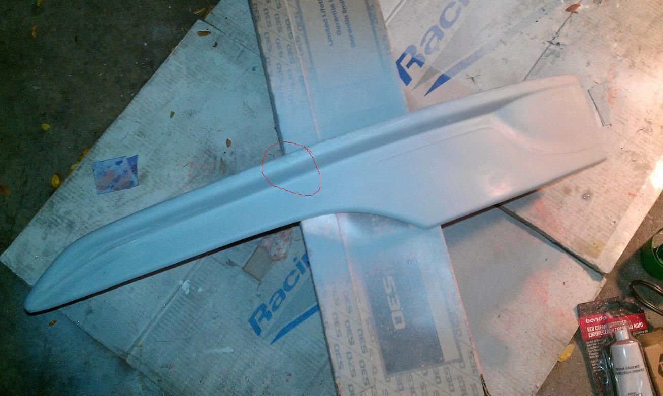

I can't figure out how to get the crack to appear completely gone. I'm not sure what sort of product to use, because there are two choises.. Leave the crack visible, or make a lump over it which will be visible in the paint. So either way there's going to be a flaw, but which do you go with? I'm thinking once the paint goes on, the crack won't show, at least until it hits the ground one time and splits the paint, even though paint is supposed to be flexible.

What kind of bondo are you using? I see the 'red' hardner, are you using just that, if so, it won't work. I only ask because the patch jobs are curiously really red.
Based on your answer is how we can help you more. Looks like you didn't do the patch job correctly but don't want to assume that. :)
I did body work for way too many years haha, love it though!

Bondo products sucks ass. For Winglets you need something made for plastics, like a flex plastic resin. Evercoat Polyflex or even their standard Rage would have enough flex to fill those and not crack. I've done some bodywork on my own R, ie; fixing winglets, and custom exhaust panels, and I've only used Evercoat products.
Nah I got that tube and realized I didn't need it. I'm using the only putty they had that would adhere to plastic other than their bumper repair kit. I needed more than 8oz or whatever they give you. **** works great, other than the crack not sealing.

For a large crack, I would recommend using 2 part epoxy first to bond the crack together. Flex Filler resin although great, won't hold the crack together, so any bending on the plastic could potentially still separate the filler material from the original ABS plastics. So epoxy the winglet first, allow it to dry, then put filler ontop. Epoxy is sandable, so once you have the crack filled, sand away. You may need to use a glaze after to create a smoother paintable surface.
As for where to buy, I'm not sure. You'll need to look for a professional autobody supply shop, I could name the shop I buy from, but I'm in Canada which I'm sure won't help you.

If the winglets are urethane the only way to ensure a permanent fix is to weld the crack using the same material. I am not saying fillers and epoxies will not be able to fix it permanently but I have seen many plastic epoxy/filler repairs fail (in a long term sense, not in an immediate sense like if you mixed plastic and fiberglass filler), or the part flexes in such a manner that the repair is no longer able to hold (someone taps you in a parking lot, a rock hits the repaired area etc...).
Also if the crack and previous repair really is that bad, it might just be worth it (from a time perspective) to bite the bullet and just replace the winglet.

Well, they aren't for me, and I'm not sure how concerned he is about the small crack. We'll see. It wasn't that the repair is impossible, it's just that they used hot glue, and it's everywhere on the backside of the winglet, so getting rid of it will take a long time.
