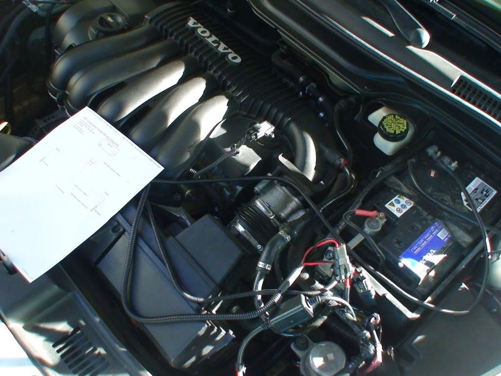

Okay so I have 8000kw 55w kit <p>battery harness<p>and Bulb out cancelers.... I hooked it all up according to this diagram: (not finalized installation lol, just to see if anything works...) <p><A HREF="http://www.sharphid.com/installation/HID%20Complete%20Wiring%20Diagram.jpg" TARGET="_blank">http://www.sharphid.com/instal...m.jpg</A><p><br>I try to turn my car on for the first time....Key turns all the way and I think I short everything out as the radio goes off and no lights on dash or anything.<p>I Try again and the car starts with NO WARNING Message. The lights are on the on position and the HID's are not on and defiently not emitting any light.<p>I feel like they arent getting power but...there is no warning message....<p>Here are some pictures for reference:<p>
<p>
<p>
<p><br>What the heck am I doing wrong?? <IMG NAME="icon" SRC="http://www.vortexmediagroup.com/images/banghead.gif" BORDER="0"> <IMG NAME="icon" SRC="http://www.vortexmediagroup.com/images/banghead.gif" BORDER="0"> <IMG NAME="icon" SRC="http://www.vortexmediagroup.com/images/banghead.gif" BORDER="0"> <p>I do not want to hook up the HIDs without the battery harness in fear of burning up another wiper motor....

BOW don't work with battery harness. BOW is like a resistor inside, increasing the current drawn from the car harness, such that if used together with a 55w HID, it would draw the "correct" amount of current so the "low beam failure" warnings do not appear. With the battery harness, the main current draw is directly from the battery, so there would also be insufficient current drawn from the factory harness to cancel out the warnings.<p>I do not have access to the insides of the BOW harness, but electrically speaking, it should not hamper the ignition of the HIDs, just that they will not cancel the "low beam failure" warnings. The only way that I've seen from some other forums is to add a "custom" resistor in parallel to the circuit, where the BOW is supposed to be, such that it adds up to 55w. This is power consuming as the entire 2 HID bulb system would take up 220w, 55w for each bulb, and 55w for each "custom" BOW resistor.<p>Problem sounds like its in your battery harness area. If you have a multimeter, test the voltage of each component starting from the battery. I have my battery harness negative (ground) hooked on to the car's chasis, which should not be too much of a difference from yours.<p>What's the capacitor harness? BOW harness?<p>Other method that you could try is just to use one of the factory harness (OEM wiring adapter cables), instead of both as shown in the diagram, my car has 1 battery harness of each bulb, so no such problem. But I would expect the other bulb to stay powered even if one bulb is completely blown, ie no current drawn 1 side. (And do away with the capacitor harness, whatever that is)<p>Usual things to check: polarity (if wiring is supposed to be correct)<br>1) Polarity connected to battery<br>2) Harness (one kit that I have bought allowed both orientations to be connected), the wrong polarity did not damage that set of HIDs, and a simple reverse of polarity works.<br>
