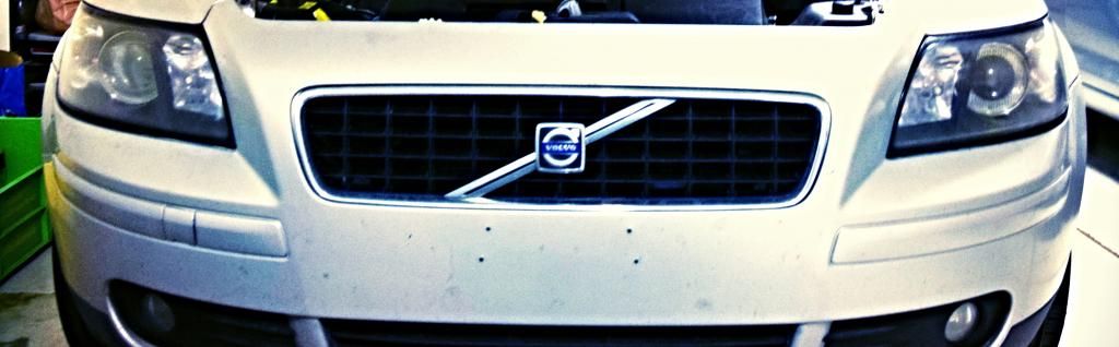

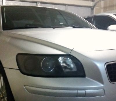

Yes, as many have said our original lighting setup is terrible...so terrible it's almost unsafe at times. Driving through rain/snow/night at times I had some white knuckle moments. I've recently completed a full retro-fit to the E46 lenses and stealth housing and couldn't be happier. You don't have to go to the lengths I did, but the improved lighting of the retro will do wonders. Here's a few shots (of the many) that I took. Need to get some better ones outdoors that show the output better.
Before
After
after converting the lenses.
Sample Light Output (sort of) - Sadly no light before but I think we all know what that looks like.
Current - Light On (It's not this Blue...bulbs are Pure White)
Current - Light Off
