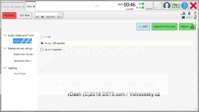

Hello everyone,
Finally, I tested VDASH diagnostic software and this is to confirm it's working now for Volvo SPA using only the ethernet to OBD cable. No need for the expensive Dice unit like before. The software is free on D5T5.com.
I was able to diagnose trouble codes on my 2018 S90. However, adding more features like navigation, video in motion, etc.. will require decoding the pins of the CEM and ECM (require VDash Pro dealer). Did not try that yet.
Part needed:
VOE adapter (Ethernet to OBD cable). I used the one from ebay ($25) and it was working fine. However, I had troubles to match the IP address but finally it worked on my second laptop. Not sure if it's the cable resistor itself or the laptop.
D5T5 supply OEM volvo adapter 9513108 and would recommend that over the eBay one. The choice is yours at the end.
Software needed:
VDASH (free but would require account registration).
Pictures and sample report:
Volvo VOE cable (9513108)
Ebay VOE cable

I just tested it again and it's working flawlessly. Kindly, check again as they might just released a software update that addressed the issue.
Here are the steps that I'm following:
1- Conect the OBD cable (OBD side only)
2- Start the engine
3- Run VDASH as administrator
4- Log in into your VDASH account
5- Once logged in, that J2534 device error message will appear
6- Turn off the engine
7- Connect the Ethernet cable into the laptop and wait until it detects the vehicle.
8- Once detected, close all the pop up windows/messages.
9- Enjoy VDASH (Warning: do not exceed the 10 - 15 minutes if you have no battery charger connected as diagnostic consumes a lot of energy).

Re: CEM decoding needed for vdash...i followed the process Power6 outlined in this post:
very clever workaround...costs you a 3 day vida subscription and a whopping $0.10 vida purchase...along with $10 subscription to vdash...the vdash changes are purchased a la carte...
enjoy - R

I think vdash is out of a la carte and now it's yearly sub.
What sucks is that if you get a total refresh at the dealer I'm sure you have to re-activate features like paddle shifter.
Sent from my Pixel 6 Pro using Tapatalk
#19 ·
I used the VDASH Lite version for $10/year...and then you can select various options to enable at various prices...activating the paddle shifters cost $109USD...the VIDA 3-day subscription was $79...
true on the total software reload...i have no idea if once you buy the enabled option with vdash whether they allow another update should it be needed...otherwise, it's another $109 in the case of the paddle shifters...not the worst of cost if i needed to pay again...
software 2.0 updates don't effect vdash enabled updates - at least not this one...i've had that done since i enabled the shifters...and all good...
