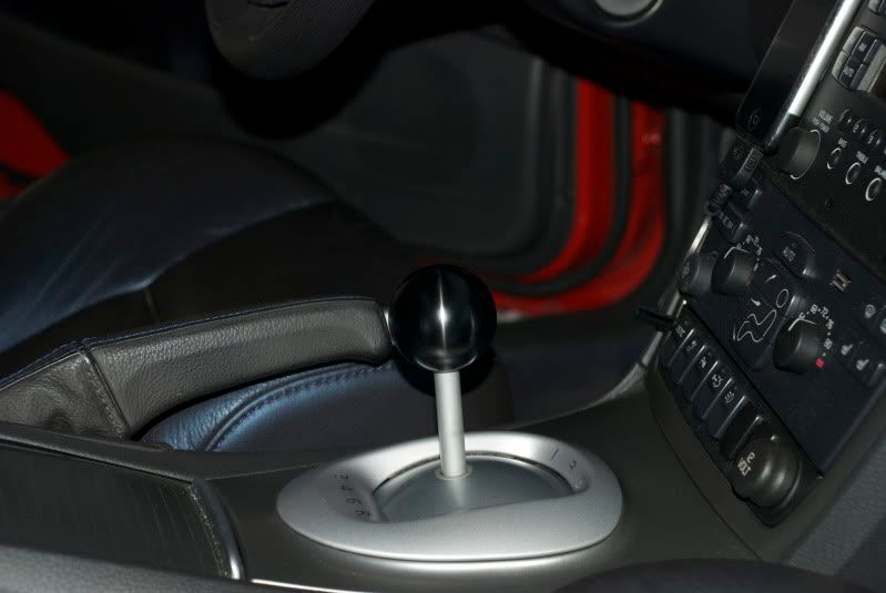

I finally got my shift knob installed today. Like most posters in the past have said the hardest part of the install is getting the die started on the shaft. I would recommend eating your Wheaties and doing it first thing in the morning
! The knob came with two spacers, one small and one large but I opted to use none. The knob sits nicely without the spacers and is comfortable in the hand.

Just as a reminder for everyone, do you mind posting which pitch TWM you ordered or for which vehicle..as well as the tap/die easurement?
http://********************/smile/emthup.gif I want to know as well!

crap, i have this info someplace, let me dig around, though someone will probably beat me to it.
M8x1.25, then thread shifter to match.
I didn't order by vehicle, I clicked the box to the right that allows you to specify what you want. Sorry I meant to mention that it is 8mm X 1.25.
Sorry I missed the second part of your question the first time I read it. You just use the corresponding die 8x1.25.

Also, did you cut off the thinner section of post? Or is that the part you threaded?
No cutting at all. In fact I can still go back to stock because the threads are just cut on top of the shaft, the hole for the pin is still there. Mine sits a bit lower than the image above.

Here are a few shot underneath.
Its hard to see from where the hole is potitioned but its still there.
