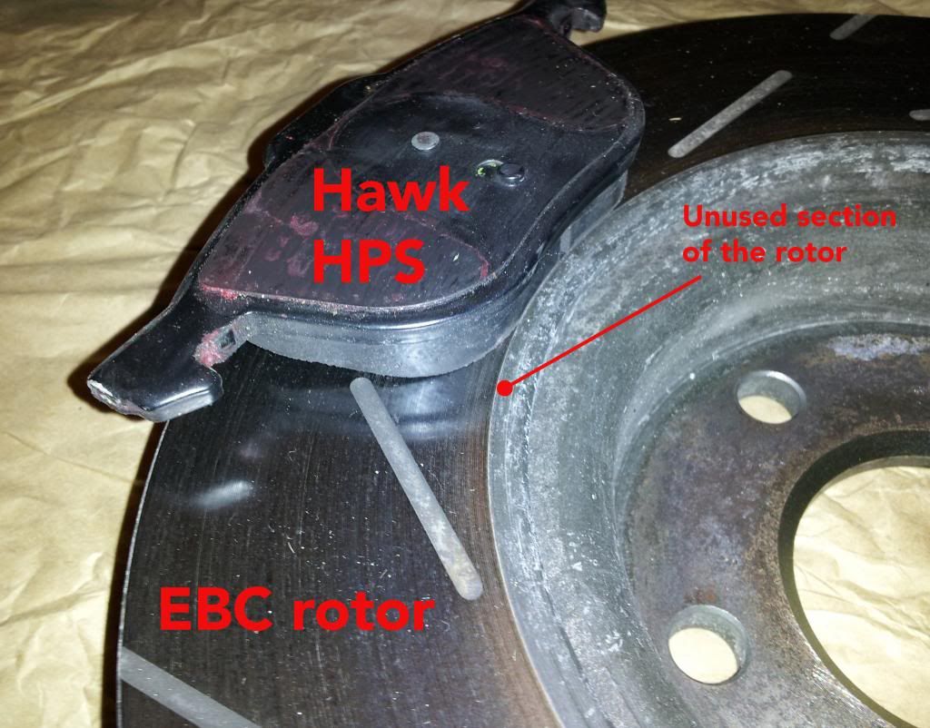

5. Rotors:
The EBC slotted rotors seemed quite a good quality at first. It is hard to tell if some of the vibration came from bad rotors really… What I can speak about is this: The EBC have a particulate slot pattern that - to be totally honest - look pretty cool. But this has two downsides. One is that it seems the amounts of slots are too many. Even if the general surface area might be close to the PowerSlots I installed afterwards, there is never a large surface area free of slots for the pads to get grip. I believe that this design with reduced surface area of the Hawk pads dramatically reduced the performance I was looking for.
EBC at the top. StopTech on the bottom:
Another downside of the EBC is that the slots are open to the outside edge of the rotor. The Hawk and EBC parts did not seem to match well in diameter (part of the issue being the caliper bracket I mentioned earlier). The Hawk pad outer wall was flush with the outside edge wall of the rotor. However the rotors have a bevel as well on the outside edge. This created a thin knife edge material on the pads which I believe would catch the open slot of the rotors. Not a good situation. The StopTech Pads and PowerSlot rotors (from the same Centric company) where much more in sync.
hawk with knife edges from sticking outside of EBC rotor braking zone:
So to sum this up I strongly recommend getting rotors and pads from the same manufacturer so diameters match. Otherwise try to get specification drawings as much as you can to make sure pads will seat within rotor braking surface.
Overall I do prefer the StopTech slot design because it leaves a continuous surfaces area of the rotors the far edges of the pads ride on without slot interruption keeping the pad stable as it runs over slots.

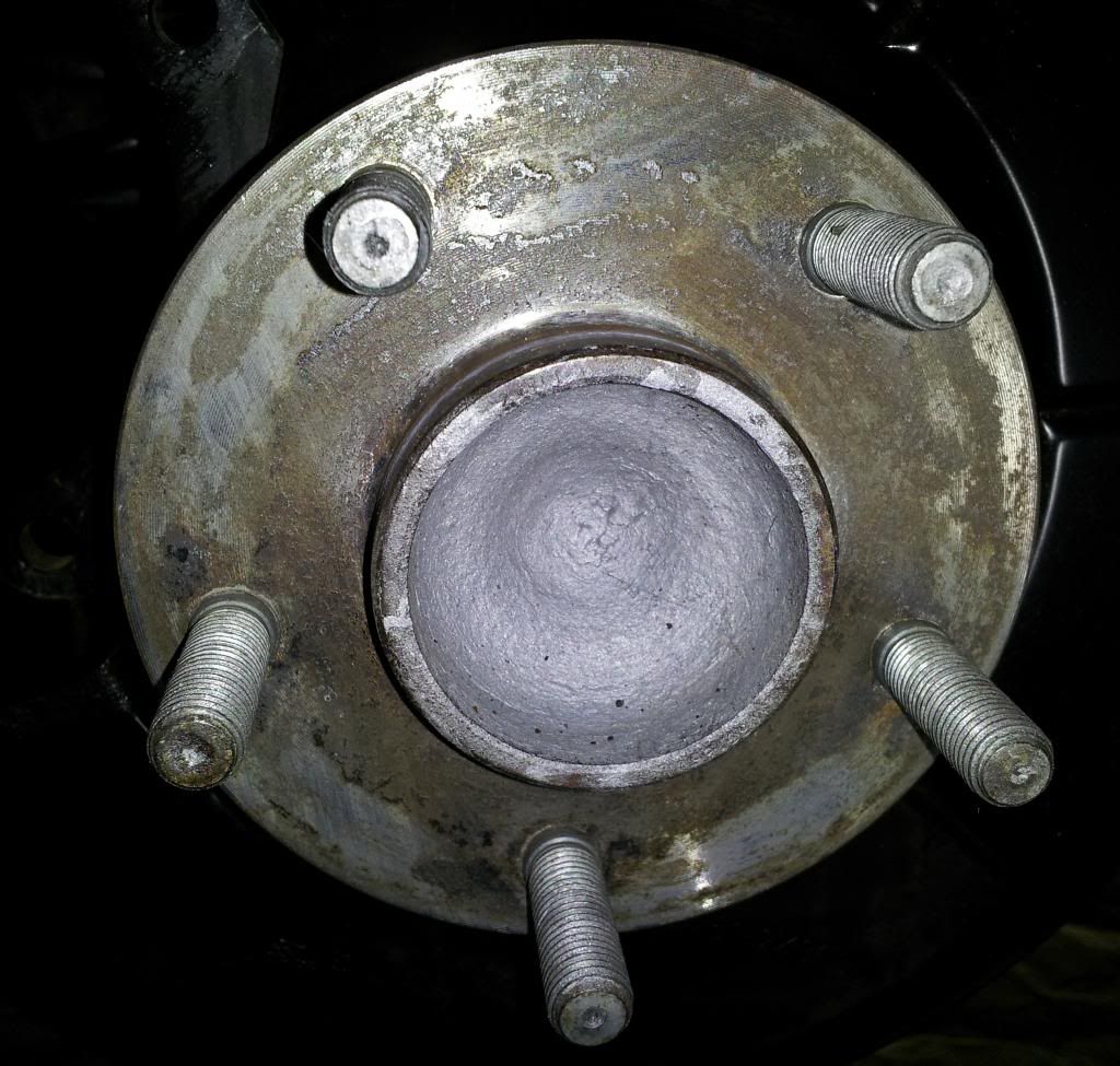

6. Wheel hubs:
Needless to say cleaning things up before placing new rotors is essential. What I didn’t realize however, and some may not either, is to what extent!
When you change the rotors for the first time after 48000 miles (77000 km) there is quite a bit of rust between the original rotor and wheel hub. While these two have aged together without any alignment issues putting the new rotors on does not provide good aligned any longer. The first time I re-did my brakes I used a wire brush to scrape off most of the rust. This was not sufficient what so ever. The older style hub is all one flat surface. It has little concentric ridges. These were hidden under the rust. I now believe I was getting vibration in part because the surface of the hub was never planar. I used 220 grit sand paper this last time around and realized you can sand off all the rust without damaging the hub surface. On the contrary you can sand rust off to reveal concentric ridges once more. I warn you though this takes lots of time. Perhaps there’s an easier way than by hand but it is hard with the studs in the way. After I sanded down all my hubs the rotors were perfectly aligned (well I still have a slight issue with the front right hub but no vibration noticeable at the moment).
Rusted HUB:
Cleaned HUB:

Good Stuff , You should get You money back on those HAWKS - that Pad wasn't even Cut or Beveled Right .
Also sounds like You got some from a Bad Batch .
