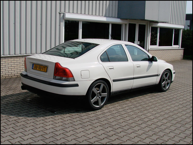

After that the car received Koni shocks and Eibach springs, the SD2's 18" Graphite Pegs, S60R front Brembo calipers and rotors and alignment was done,
After which the car looks like this,

Still investigating a real coilover suspension so for the time being I went with the trusted Eibach/Koni combo. Maybe it is because of the white color the car doesn't appear that low but it is about the same height as my former S60R. Color is not Ice white, at least it has a yellow hue to it.
And the tires, they have performed well under P2 cars.
