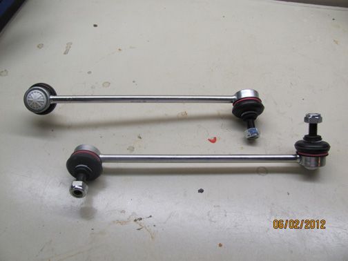

At 153000 the front sway bar support stays are really clunking and today was a good day to replace them. It's a fairly straightforward job (took me about an hour) but I took some pics and thought I'd submit a write-up about it.
Just to be sure, I sprayed some penetraing oil on the upper and lower nuts the night before. Struts were from autohausAZ about $16 for each

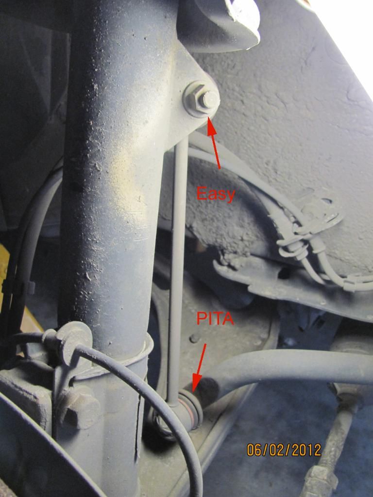

After jacking up the front and taking off the wheel, the struts are removed (originals on mine were 15 mm). The top nut is easily accessed by turning the hub assembly for the best positioning. The bottom nut is a bit harder to get at - you don't have to be a contortionist, but some knuckle bashing is easy to do.

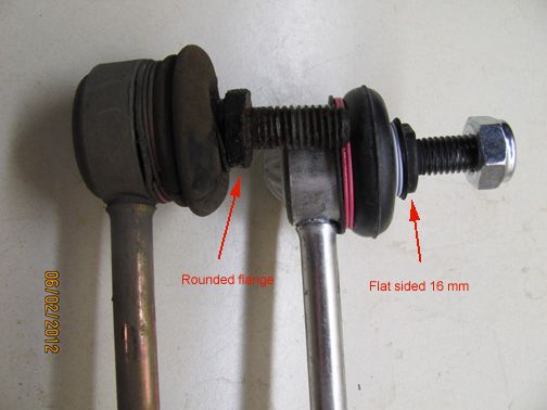

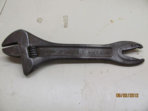

As with tie-rod ends, the entire joint assembly wants to turn as you turn the nut, so you need to secure the rear flange to get the nut off. On my originals, the flange was round :mad: but the Crock saved the day.
The flange on the replacement struts could be secured by a skinny 16mm end wrench.

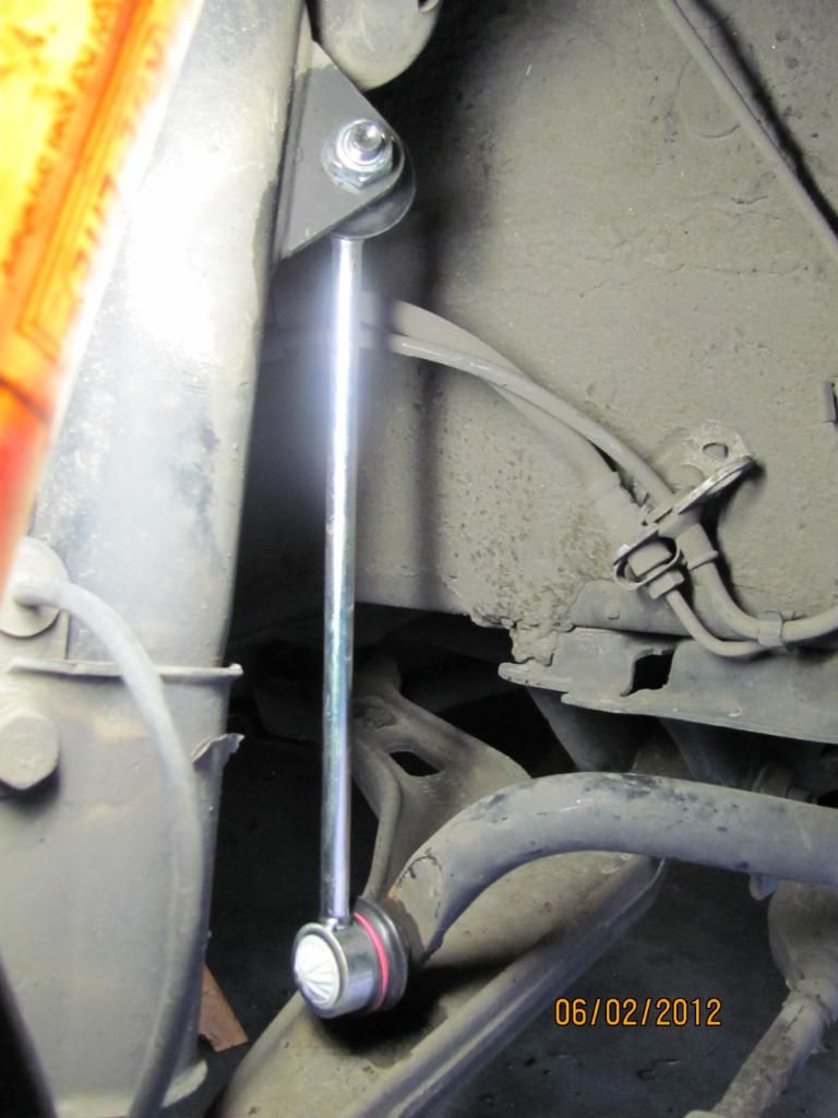

Once those are removed, the new ones go in easily.
I torqued mine to 40 ft/lbs - another real PITA for the lower nut since the torque meter faces towards the OTHER side of the car, there isn't much clearance, and even less viewing room. Clunks gone!
