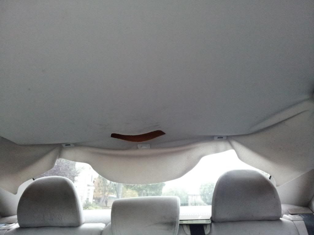

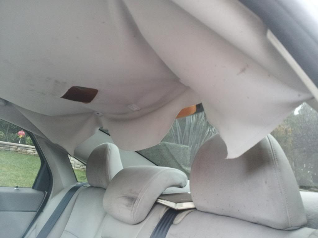

Ha. Time for a headliner project! Anyone have any views on the best headliner adhesive?
Any tips from people who have already done this?

You know the look grew on me too! Until it started blocking visibility. Then I figured may be time to do something about it.
