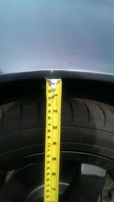

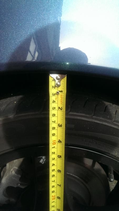

Hi i have v50 d5 and i am not sure weather it has the volvo lowering springs on it can any one tell from the pics ?
i am thinking about getting some h&r or eibach springs but not sure it will go any lower if it has springs on now
front
rear

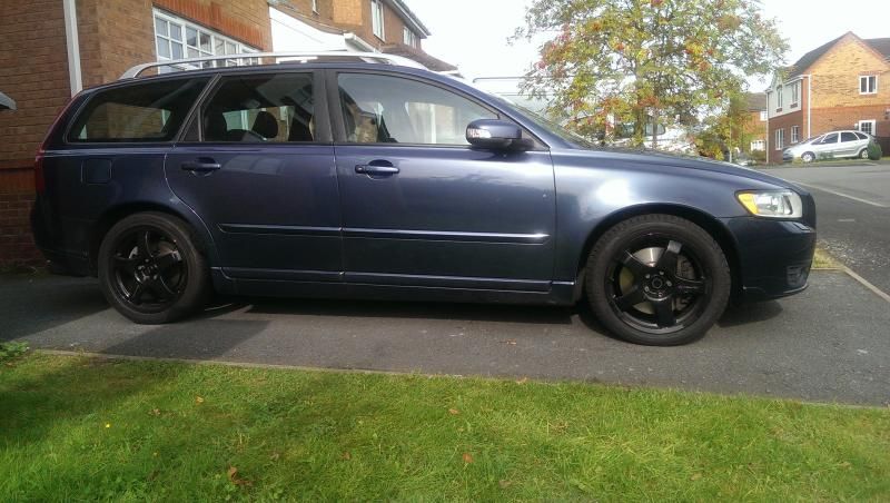

can you post some pics of v50 with lowering springs to thanks
7,186 Posts
If it's an awd you definitely have some lowering springs in the rear. Harder to say if it's fwd as those sit a bit lower in the rear from the factory.

just black springs can not say i seen any think on them just some bits a paint sure they stock volvo ones but not sure if the sport ones they do

15,117 Posts
I would guess sport springs as well. It looks a little lower than my car was at stock height, but definitely not that much of a drop.
4,366 Posts
You are low. I have factory lowering springs & measure about the same. FYI, those springs are 20mm lower than "stock" so you can figure from there.
1,934 Posts
If those aftermarket wheels were on the car when you bought it, I would say there's a chance it's lowered on aftermarket springs

nar i put them on was standerd when i got it.
