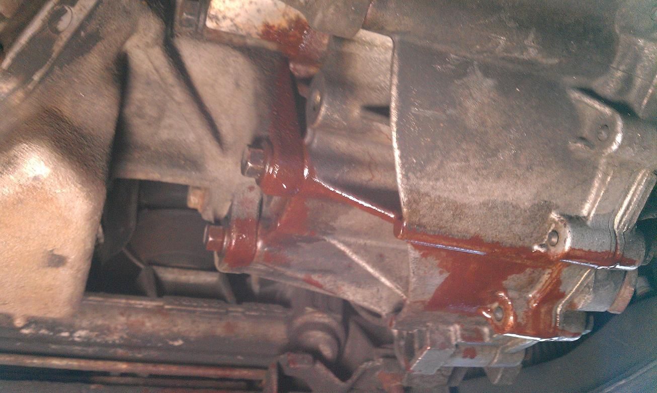

Doesn't look like tranny fluid to me. It's bleeding!
I had a small spot on my driveway that was this color right after swapping the slave cylinder, but it didn't start leaking until sometime in the last week or so. I'm just guessing it's the angle gear seal.
2,418 Posts
Ouch man, get that resealed before the gears get damaged. :(
At least it's not hard to get the angle gear off... Takes probably 25 minutes.
2,418 Posts
Uhm, strange. Are you sure it is not related to slave cylinder?
Yes, because.. That's not where the slave is located, and it was just replaced recently.
2,418 Posts
Perhaps... I just recall that when my AG leaked, it had different fluid colour. Kind of like this:
Just again seems coincedental that slave cylinder was replaced recently and now you have this. Just throwing out some ideas here.
Recently as in 10K miles ago, it's definitely not brake fluid lol it's either coming out of the trans, or angle gear. Just don't know which one yet.

kinda what I was thinking... more like trans oil...
Except it's brand new fluid and it went in like engine oil color? I'll feel alot better if it's tranny oil, actually. Volvo fluid from the dealer.
Just curious to why it would ALL OF A SUDDEN leak like a bitch in the past 2 days or so. I've got a small spot in my garage, and on my driveway. It's been at least a couple days... It wasn't leaking 5 days ago for sure.

I'll take the angle gear off first thing tomorrow. My best guess is that it's just a seal... I'll inspect the condition of the collar while it's off.

its rust from the coupler splines
Right, but fluid would have had to have leaked out somewhere to carry the rust out with it... Just have to find where. I will also clean, and lube the collar sleeve tomorrow. When I did the slave it seemed to be in pretty good condition.

So, the splines look pretty good. But everything is coated in this ****... It's hard to tell if the seal is bad.

Looks like red clay.
