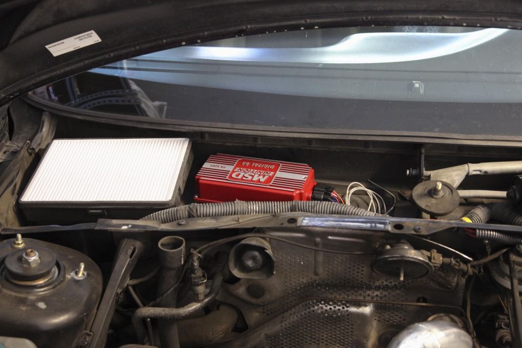

<!--[if gte mso 9]><xml> <w:WordDocument> <w:View>Normal</w:View> <w:Zoom>0</w:Zoom> <w:Compatibility> <w:BreakWrappedTables/> <w:SnapToGridInCell/> <w:ApplyBreakingRules/> <w:WrapTextWithPunct/> <w:UseAsianBreakRules/> <w:UseFELayout/> </w:Compatibility> <w:BrowserLevel>MicrosoftInternetExplorer4</w:BrowserLevel> </w:WordDocument> </xml><![endif]--> A painful lesson learned, though embarrassing, IMHO still needs to be shared. If I did this someone else could also. By installing my MSD 6A in the depicted location, I managed to put a screw right into my AC Evaporator! Those not familiar with the replacement ramifications, it entails the removal of the entire dash to perform the repair. :facepalm:

Thanks for sharing though, hopefully it saves someone a similar fate someday.

Those are one of those EFFFF moments. Thanks for sharing, it is good to remember it doesn't happen to just us! lol

And oh! From your picture it looks like you're missing a nut on your right strut tower?
63,543 Posts
Your NEW evap or your old evap?
2,238 Posts
Sure hope it wasn't the new one! How long were the screws?? I've done the job twice and I don't remember the HVAC box being that close to the upper cowl.
1,930 Posts
It was on the old Evap, I don't do well with plastic, nor did the job look like a pleasurable one, so I'm picking it up from the dealer tomorrow. I go back quite a ways with the tech that's doing the job, so I'm sure I'll get an ear full when I pick it up. I was told by the service writer that he was going to cut if off to avoid further issues. I can't remember how long of a screw I used, as I know in one location I had to use a stand off because the mounting surface isn't complainer. I didn't even give the evaporator a thought, nor did I put two and two together that I caused it. It was original with 382,000 miles on it.
