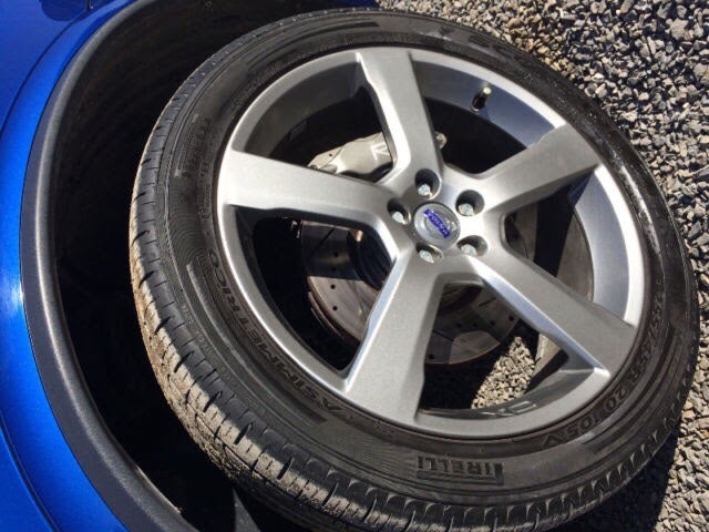

Done but I need the go with larger spacers. I'm 0.1mm shy on the very bottom edge so now the paint is rubbed off the bottom edge of the front calipers. I'll just go from 10mm spacers to 20mm. That should do the trick. lol.
Discussion starter · #69 ·
That looks awesome! I'd say go with 15mm if you can find some. Otherwise it's good to know that those brakes and wheels almost work great!
Looks stunning!
Discussion starter · #70 ·
Check Ebay i saw spacers that were 15mm and 20mm for the S60R guys. You may have to machine them from 65.1 to 67.1 to fit them on your car though but this will make the stance and wheels sit perfect with the fender flares and the braeks.
