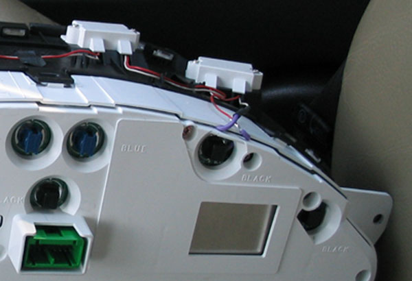

Re: (S60Driven)
Well, I'll try explain it a little, unfortunately english is not my first language. I have this picture, but it's not very good one:
The backlight bulbs have those black and blue holders which are attached to the base (or ground). The base has metal connectors for power. I just joined the wires by soldering to the metal connectors.
I hope this helps you.

Re: (S60Driven)
Ok here are the pics as promised...slightly late...sorry.
Here are the two wires that come off the LED cluster. I cut the connector off and connected the wires to the base where the bulb twists into.
I simply put the wires under the bulb holder and twisted it in and it holds fine. That way I am not stuck soldering anything thus making it permanent (even though I bought a soldering iron and practiced soldering just in case!).
