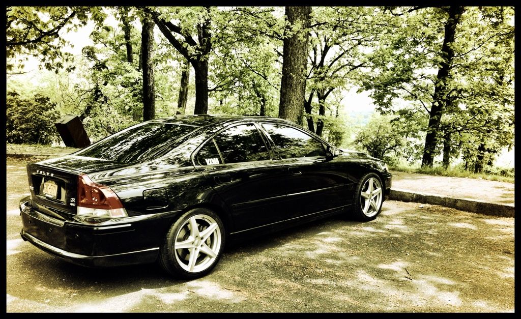

CAR IS FOR SALE: http://forums.swedespeed.com/showth...60R-GT-NY-NJ-CT-97k-miles-Black-Sapphire-Gobi
More Pictures Below
