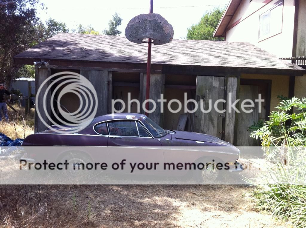

I started off by getting a "barn find" volvo which was located in Malibu, CA. Unfortunately, the car was next to the barn, not in the barn. It was rather weather beaten and hadnt been driven in 20yrs but all the parts seemed to be there and it didnt appear that rusty overall. After draging it out of the field (brakes were locked up), and loading it on the trailer, I took her home. After initial inspection she was christened "Project BLACK WIDOW". Why? Because after getting it in my garage, we discovered that she was infested with black widow spiders! Needless to say, fumigation was the first order of business!

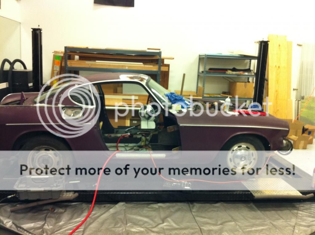

Diamond in the rough...

Work begins!

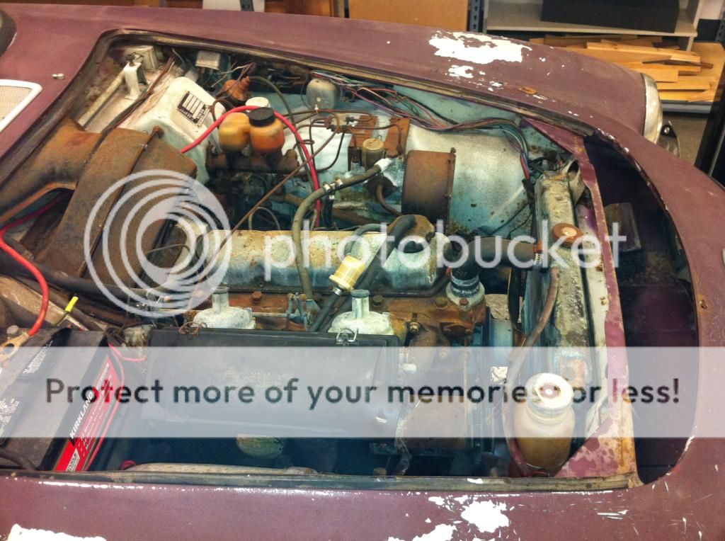

Engine bay
