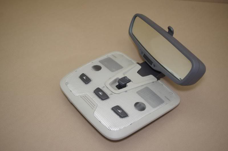

i want to know can i swap my 2001 overhead console with the later style overhead console
without changing the rear view mirror as mine is auto dim
my old
new style
i need to use the space to mount accessories
can i do that??

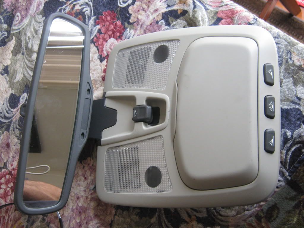

Hmm! The new UEM looks longer isn't it?
The pictures in VADIS don't suggest the larger one can fit into the older one's space.
it is under;
[Interior lighting and upper electronic module (UEM), replacing]
Should you decide to go ahead, let me know, I would send you the instructions.

please send me the instructions i ordered the part in picture shoulkd arrive in 3 days i think

ok done it's extremley easy,
1-st they are not the same size the new is longer about 2 inches ,ok this was not a problem just punched 2 holes at the retaining clips at the end
2-nd sunroof wasnt working .... used my sunroof switch all worked like a charm
remember dont ever use another rear view mirror as it contains the upper control module, if replaced remotes wont work sunroof wont work also
