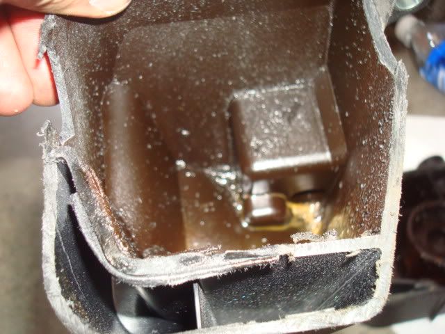

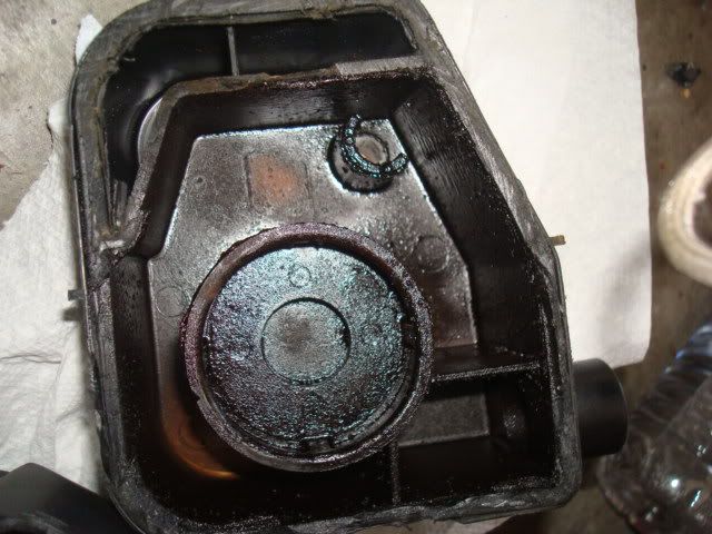

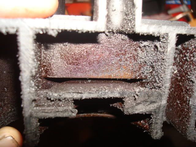

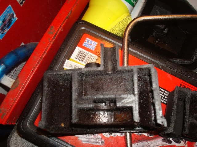

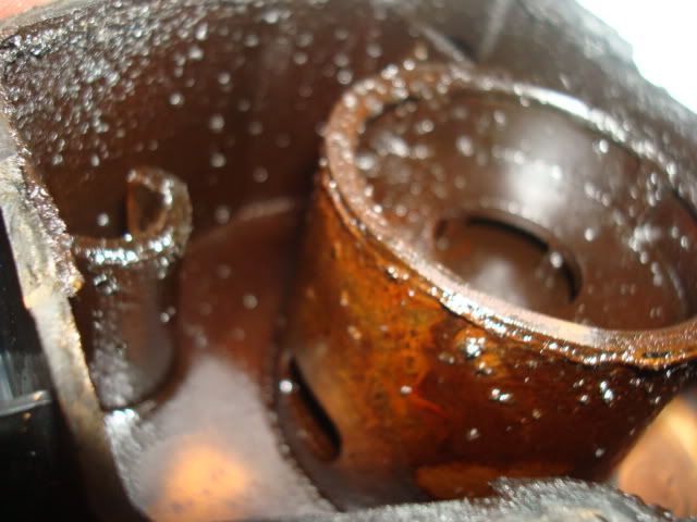

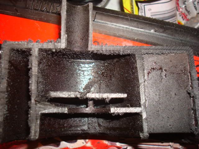

Ever wonder what's inside that black box under your intake manifold? ....Well, not much:<p>Top half<br><IMG SRC="http://i161.photobucket.com/albums/t215/rushin_album/DSC02692.jpg" BORDER="0"><br><IMG SRC="http://i161.photobucket.com/albums/t215/rushin_album/DSC02696.jpg" BORDER="0"><br>Bottom Half<br><IMG SRC="http://i161.photobucket.com/albums/t215/rushin_album/DSC02694.jpg" BORDER="0"><br><IMG SRC="http://i161.photobucket.com/albums/t215/rushin_album/DSC02697.jpg" BORDER="0"><p>Top half in half (quarter?)<br><IMG SRC="http://i161.photobucket.com/albums/t215/rushin_album/DSC02725.jpg" BORDER="0"><br><IMG SRC="http://i161.photobucket.com/albums/t215/rushin_album/DSC02729.jpg" BORDER="0"><br><IMG SRC="http://i161.photobucket.com/albums/t215/rushin_album/DSC02730.jpg" BORDER="0"><p>Diagram of the oil seperator:<br><IMG SRC="http://i161.photobucket.com/albums/t215/rushin_album/oilseperator.jpg" BORDER="0"><p>Now you know <IMG NAME="icon" SRC="http://********************/smile/emthup.gif" BORDER="0"> <IMG NAME="icon" SRC="http://www.vwvortex.com/vwbb/smile.gif" BORDER="0">

Looks like your engine splooged all over itself...

66k miles... still looks good (to me), besides the jizz <IMG NAME="icon" SRC="http://www.vwvortex.com/vwbb/tongue.gif" BORDER="0"> <p>The only reason I swapped it is b/c my car was consuming quite a bit of oil , thought it was clogged PCV system...but turned out it wasn't. I had the new part already, so swapped it anyway while I had my TB off to be cleaned.
