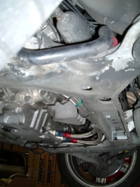

Discom is doing a CNC run for an Aluminium oil take-off plate for those who who like to install a dedicated oil cooler. This take-off plate replaces the stock Oil cooler at the same location. It will fit the S60/V70 series as well as the new S40/V50 series. Est. price inclusive of shipping is USD100 just for the oil take-off plate.
Pics of my car fitted with it below:
Who's interested?

Thanks Blot for the post and pics.
I am doing a run of 10 takeoff plates at this time and 4 are already spoken for. I will sell the rest to Swedespeed members at USD110 shipped.
This takeoff plate is designed to work with an Aeroequip AN10 to 1/2 in NPT coupler or equivalent.
http://store.summitracing.com/...w=sku
Of course AN10 hoses and fittings are recommended.
I would also recommend a Earl's remote thermostat. This thermostat will only start routing oil to the oil cooler at 160 degrees Fahrenheit and will be fully open at 180 degrees Fahrenheit. It will also allow mounting of 3 sensors, thus you can monitor oil pressure and temperature if so desired. Another plus is that it is designed for AN10 fittings.
The stock oil pump is more than sufficient to support an oil cooler.
Basically, you will remove your stock oil cooler, replace it with the take off plate and remember to join the 2 radiator lines that was connected to the stock oil cooler.
The stock oil cooler uses the radiator fluid to cool the oil, so by doing this mod, your radiator will have less heat load too.
If demand is sufficiently high, I can do a bigger run and I will pass on the cost savings to the buyers.
