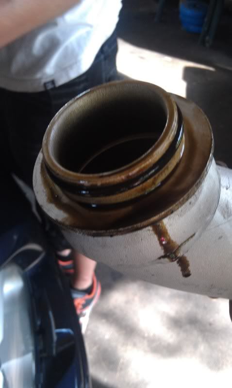

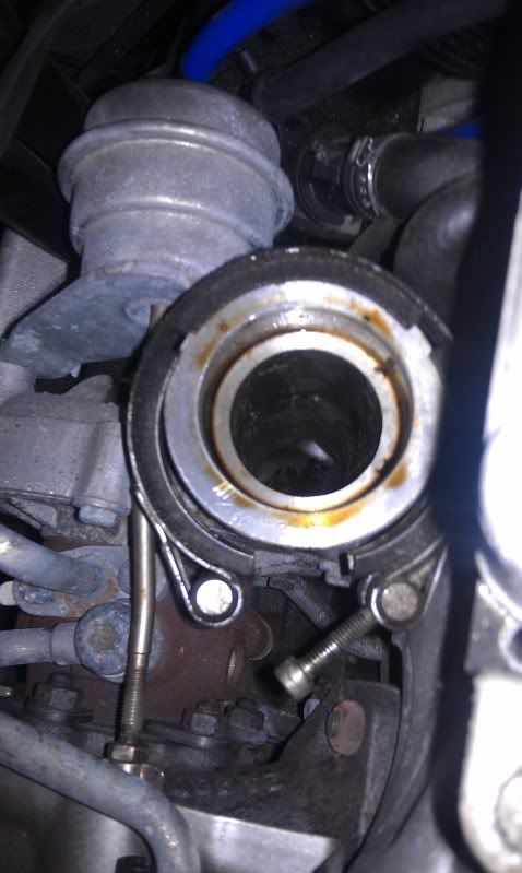

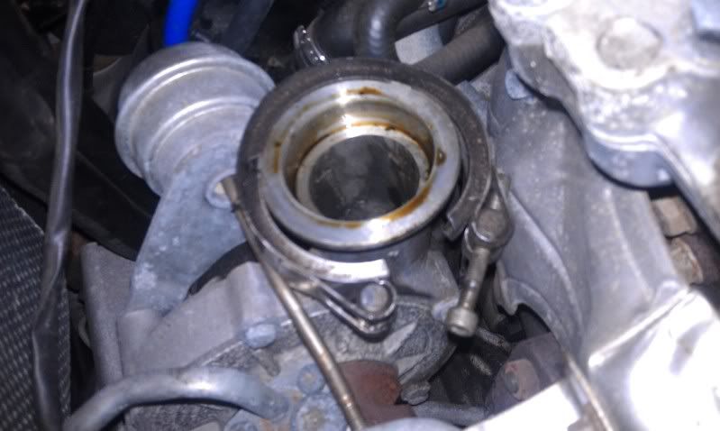

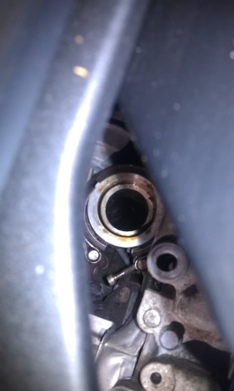

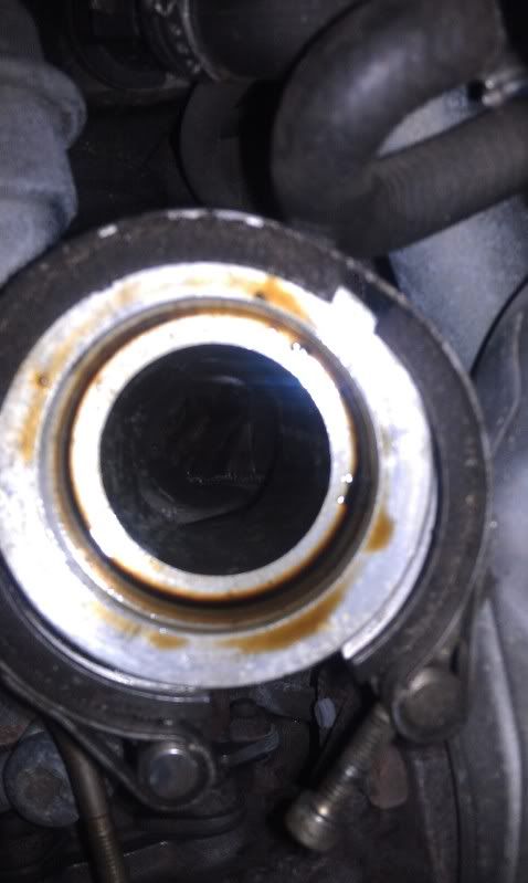

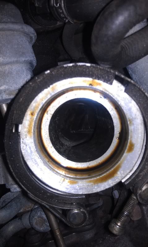

In the fight against low boost I had a chance to take off my Charge Air Pipe yesterday to see if the oring was still good. I noticed whoever took it off last put the clamp on crooked causing a nice slice in the metal. The oring was fine and the slash didnt effect the seal when I put it back on THE RIGHT WAY. I did notice a lot of oil around the seal. I know your supposed to put some on the oring but deffinetly not this much. Any clue if this is ok/bad or what its from? I know oil condensates in the intercooler piping cometimes but this seems to be a little more. There was barely any residue on the other end of the pipe and the rest of the intercooler piping.

Totalled, how much do you want for your pegs?

Lol. Check your PCV though, just to be safe.
