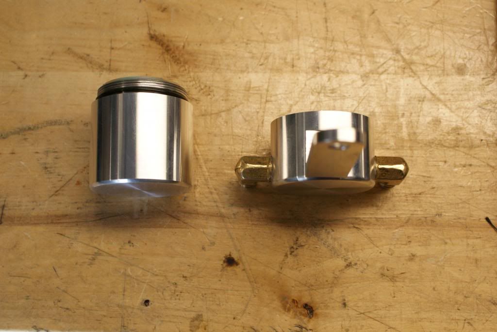

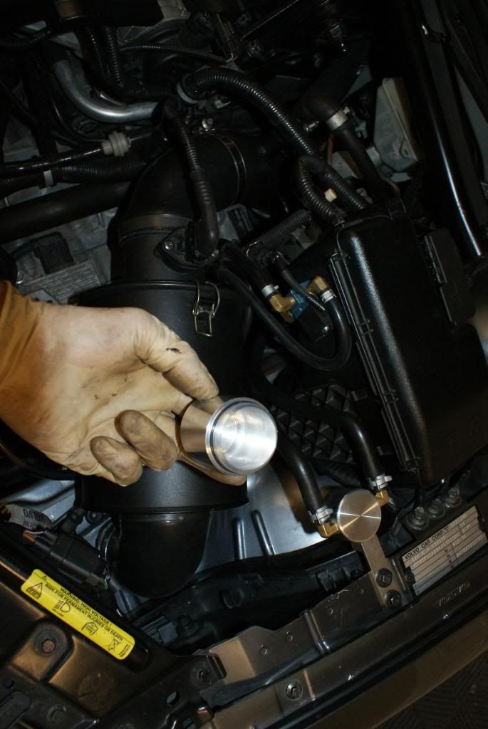

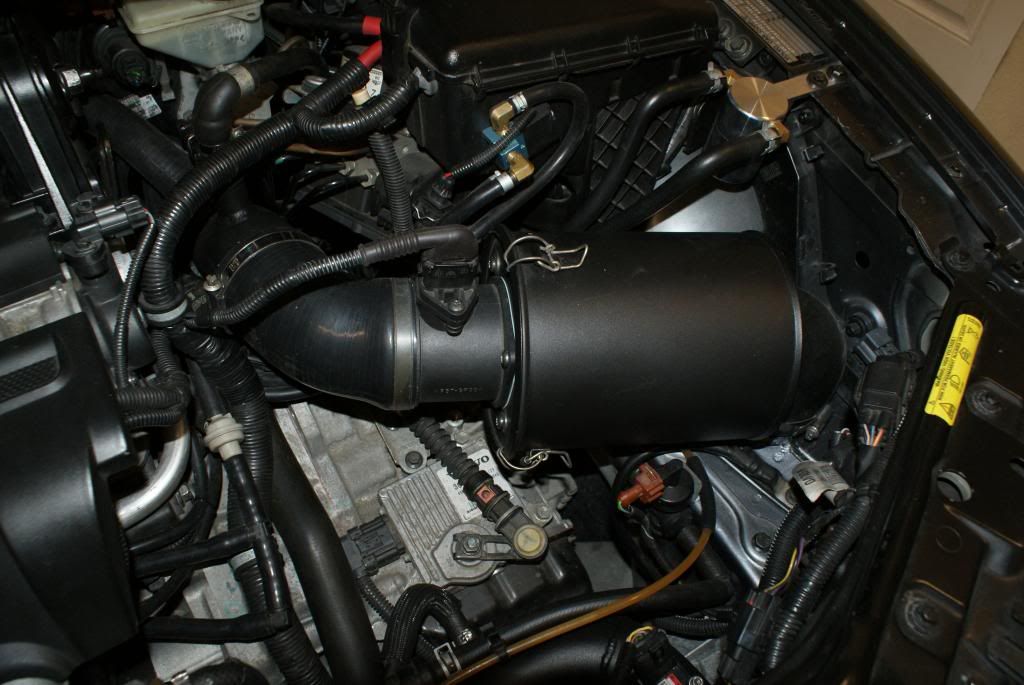

replaced my VMS one with this small one that does a better job...works perfect on my 850 and S60R...
4/18 revised

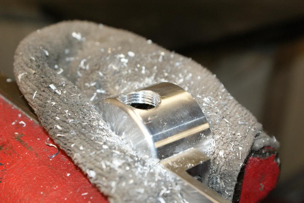

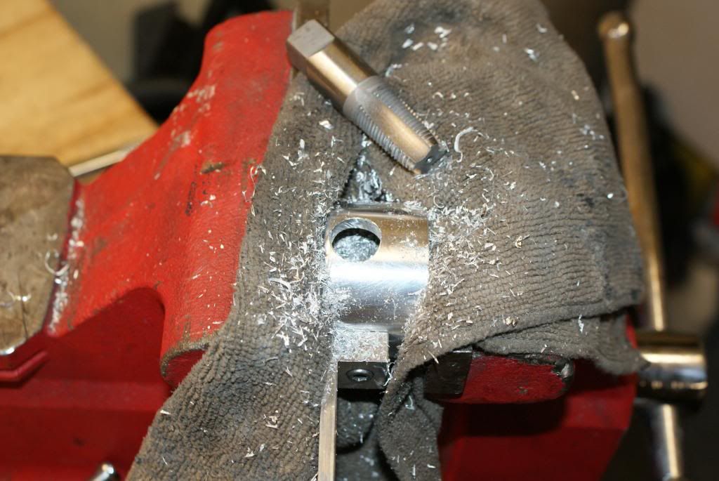

the plastic fittings that the oil catch can comes with and the 5/8 id hose are sufficient but if you race or have a tune and want to reduce positive crank pressure then do this.

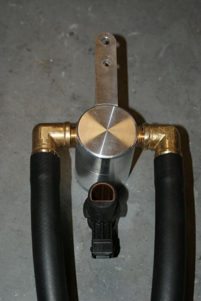

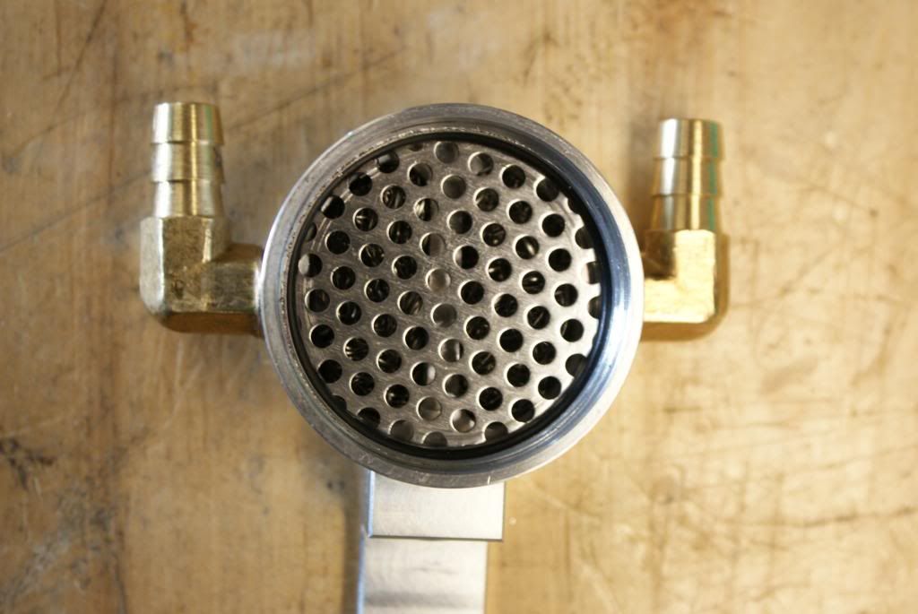

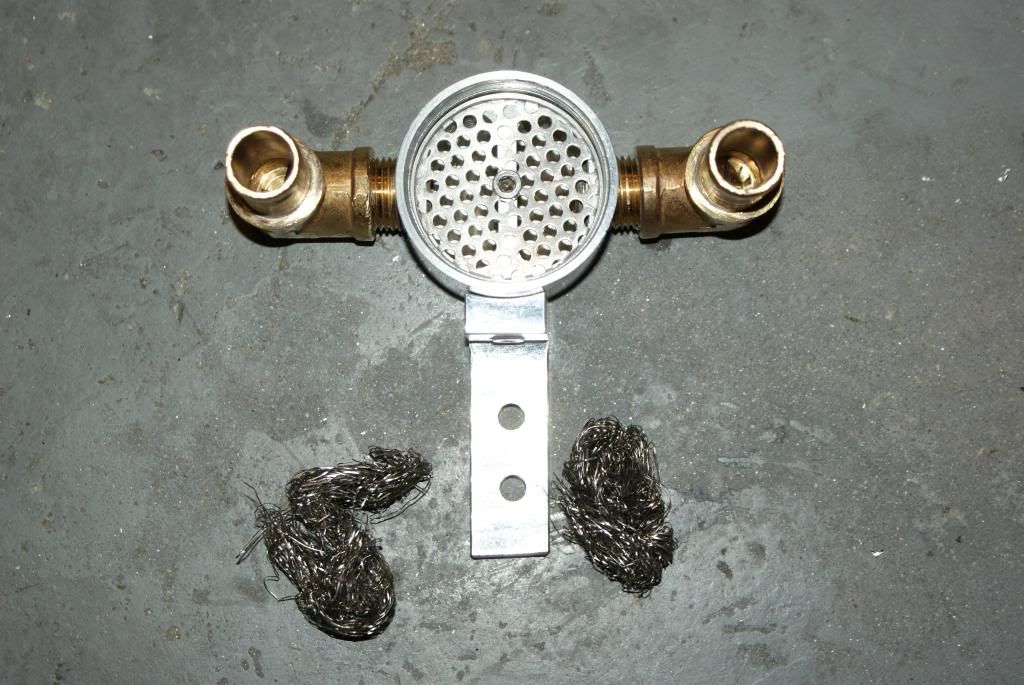

I drilled and tapped out oil catch-can to fit larger in and out fittings...3/8 pipe thread tap and fittings home made to fit 5/8 hose same thing but the hole in the can is now larger on the inside of the fitting and is able to move more air and I also removed the steel mesh from the oil can all together ......see pics.

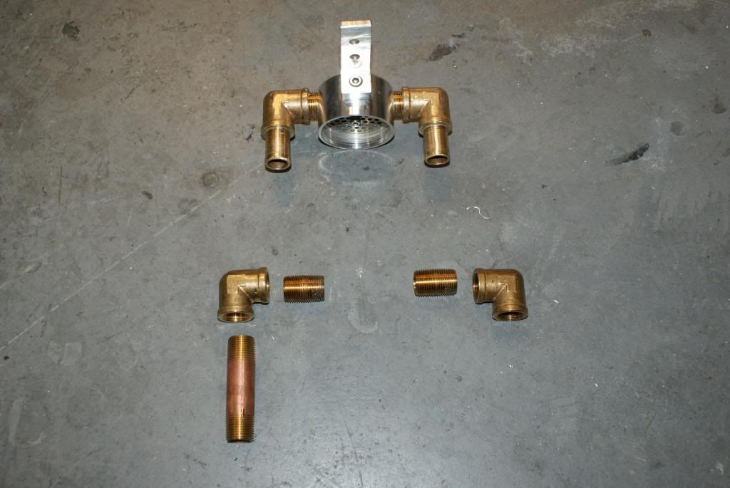

new way
i made the fittings from below.

Douggy, have you tried packing scouring pad into the breather? Old trick from one of my turbo buddies, gives the oil vapor something to coalesce to. I use either the gold or the copper ones so they don't rust.

I can see you did not use the AWFUL plastic that it comes with. What size are the barbs on the bras fittings ? Also how much hose and what size will I need ?
Thanks, its going in Wednesday
#27 ·
hose is from JY ...barbs are from local hardware store to fit the hose and can threads...didn't pay attention what size it was just had the hose with me to fit it...i know i did not like the hose that it came with...it was too thick.

i don't, but you will need a hose that plugs inside the upper part of that back elbow hose on left(you will push it inside) and the WaterPEX fitting in the middle...don't pay attention to valve on the right...useless
like so bellow...MB clamp on left is once again from Local JY of off 1986 MB fuel pump and on right from Nissan Maxima...hard to find clampy's that size and that nice and stainless steel and let me just stop..

mesh is good and the separation running down between incoming and outgoing is a must and that is what helps to catch the incoming oil and making it stay in the can. Brillo pad part I would remove on a turbo vehicle...also know NOT all oil catch can are the same . I had a hollow one and it would catch about tea spoon full of oil in a month. This lill 1/5 size of a oil catch can, can do that in couple of days.
