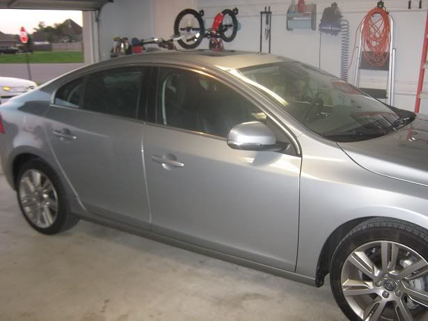

Hello to all from New Orleans:
I just purchased a new 2011 S60 T6 for my wife. It had been sitting on the lot for a good long time. It has a build date of 11/10 and had 38 miles when we took it for a test drive - 58 at delivery on 6/8/12. It has the following options: Premium Package, Electric Silver Metallic Paint, Navigation Prep, and the PCC. We have driven it about 350 miles this weekend and the car is awesome!!!:D
Here comes the questions .......
1. We are of course getting the Maintenance Overdue message. Should I just reset it according to the guidelines on the forum or should I bring it to the dealer? The vehicle had been sitting on the lot for about 1.5 years.
2. I have noticed many threads regarding updates to the transmission and to the sensus. What specific updates should I request? I did check to see if the "sport mode" had been added and it did not look like it. So, I doubt any updates have been completed. Should I wait until 7500 miles.
3. I have read many many threads over the past few days and over the months that I had been considering the vehicle, Anything else is a must know?
Thanks for your help. I have attached a few pics - not the best since it has been raining here in New Orleans for the past 4 days on and off.
