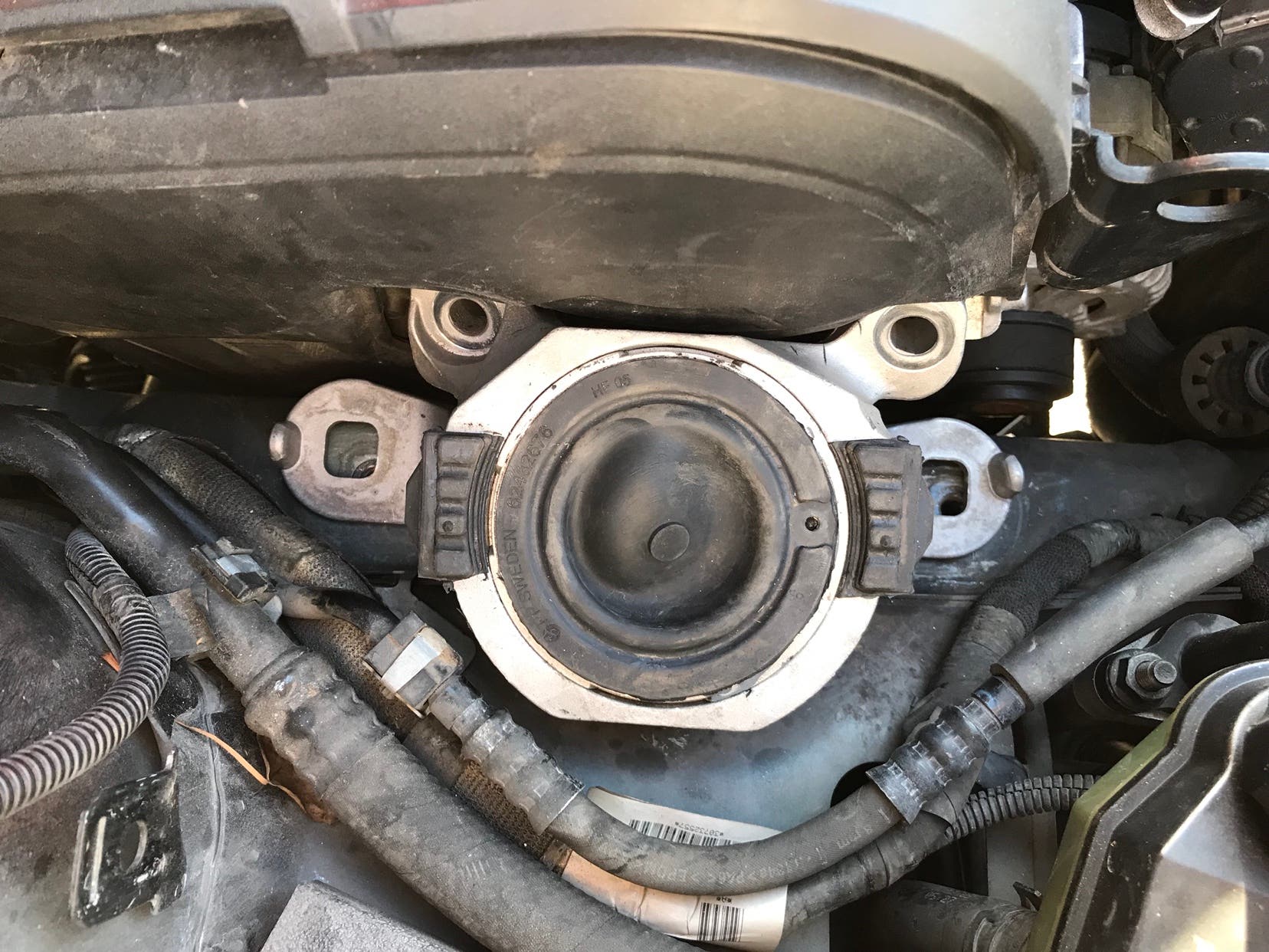

1 week later i started getting a knock sound over bumps and when turning left. I inmediatly suspected the engine mount. Went to see how it was sitting and i saw this...
It was pretty much sitting all the way down, so it was not supporting anything. I went and bought a OEM at my dealer after this and i could tell right away the build quality was much better. The centre was stiff not like the aftermarket one when i got it new.

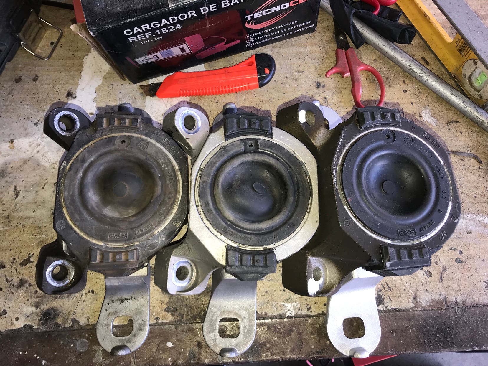

Today i removed the aftermarket one and it so happened that i saved the 12yr old OEM mount that was installed so i could compare.
(Left to right: Old OEM, Aftermarket, New OEM)

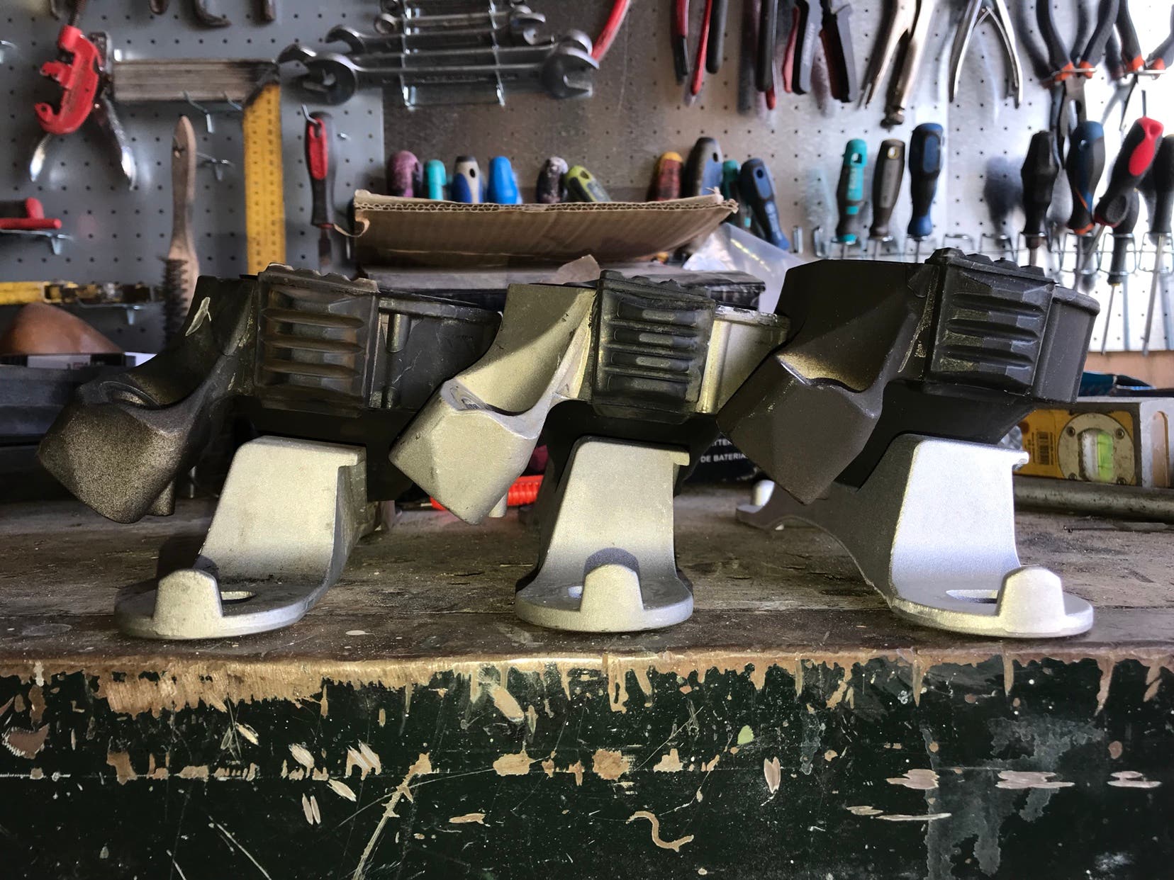

As you can see from gap between metal bracket and rubber side, the new OEM has much bigger gap. I measured the gap with caliper and these were the measurements
New OEM: 13.5mm
Old OEM: 10mm
Aftermarket: 8.8mm
The aftermarket unit has way smaller gap than 12yr old OEM mount. Now if we check the middle rubber full with fluid, look the difference.
New OEM: 13.5mm
Old OEM: 10mm
Aftermarket: 8.8mm
