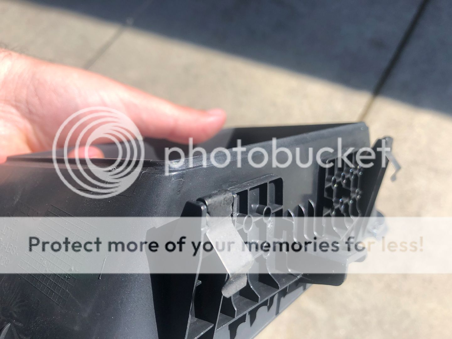

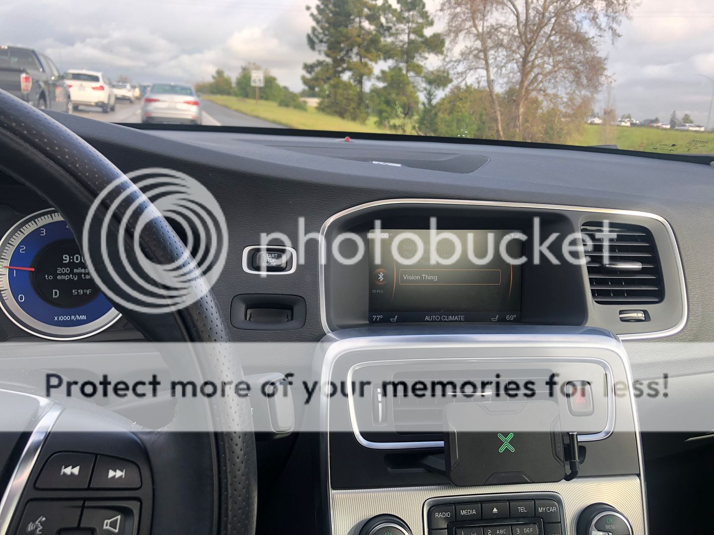

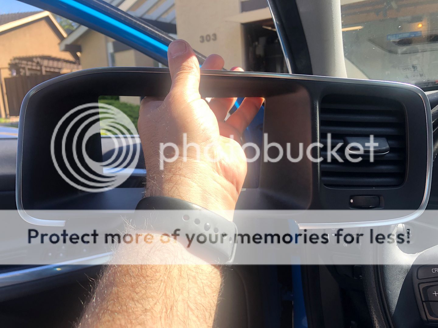

While I was re-routing the charger cable through the center console of my 2013 S60, I decided to replace the Nav Screen surround with a 2018 model. The 2018 Model has the chrome surround that matches the side vents. Yes, I have a slight case of OCD and wanted everything to match:p. I also wanted to address the slight misalignment of my original surround. The 2018 surround is an exact match. I wanted it to be better aligned with my screen. I trimmed the bottom tabs and put to use the mounting hole at the bottom of the surround. If fit great and looks super awesome.

You sir, are a legend. I have been asking around about this exact upfit. Such a nice look! I can't understand why Volvo would put the nice brushed surround everywhere but there...

Yeah... My car has the same amount of misalignment. Would have been good if the piece was bolted down somehow, I've had to remove mine and glue it in place... Lol.

I’m drawn to the visual consistency aspect of this “upgrade” but having had some bright sunshine the past few days I have to say I am finding there is already a bit too much shiny metallic stuff in the drivers line of sight.

There is a hole at the bottom of the surround piece, and it looks like at some point it was designed to be secured. I ended up drilling the hole in the dash and putting that mounting hole to work. The hole in the dash is hidden, as it is behind the center console.

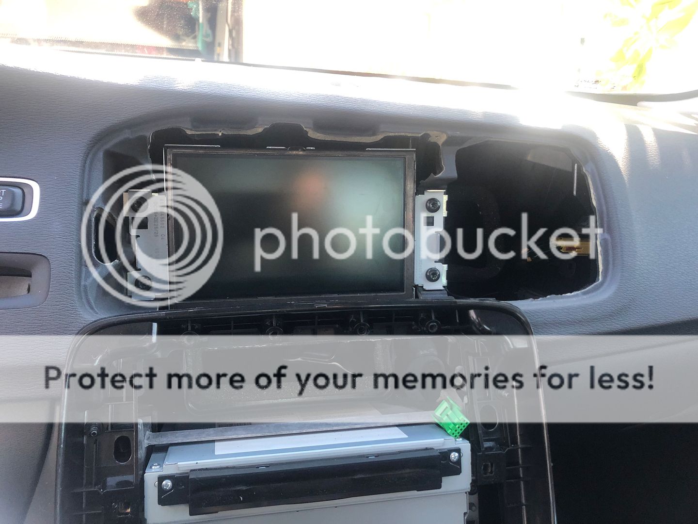

Did anyone of you remove this part of the center console?
I think it is better to do so but, much more work Unfortunately. In VIDA they show it still in place during removing and refitting of this updated nav screen surround. See below.
However, I question if the bottom part of the nav screen surround wil be able to get over this frame??
So if anyone of you have done it like VIDA (with this part in place during refitting) please let me know.

You don't need to remove that area (which is apparently called the floor console in VIDA) to remove the surround but it sure does make it easier. I actually just did this a few minutes ago while working on another project.
Here are instructions to remove the rear part of the center console, which you'll have to do first. You don't need to remove the entire console (I only went up to the first photo of post #3)
The rest of the removal will follow this PDF
