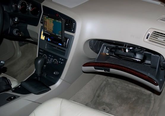

First order of business, stereo upgrade:
Put in an Alpine head unit, two amps, replaced all speakers with Boston Acoustics Rally series, and added a 12” enclosed sub. Also added an Alpine GPS nav and XM radio.
Later added full sound deadening liner to car (similar to Dynamat) on the doors, floor, and trunk.
Deitz CAN BUS reader. Interface for capturing can bus signals. Allowed steering wheel controls to work with aftermarket radio; volume controls, track skip, speed signal for GPS, reverse signal for rev camera, dimer signal for stereo lighting
