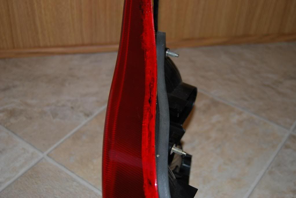

I bought a used taillight for ebay and disected it using a hot knife. ALthough it was quicker than actually cutting the taillight it had some undesirable effects. Have to work on a way to conceal it:

Instead of cutting the entire taillight I cut the section just long enough to fit LED strips.
(LED strip is covered by the yellow glue/gasket stuff). I thought it would be better just in case LED fail and I would have to deal with the weatherstrip rather than taking the whole taillight again. I will probably end up taking the left taillight out since for some reason it is not as bright as the right side. Perhaps the strip would have to be repositioned.

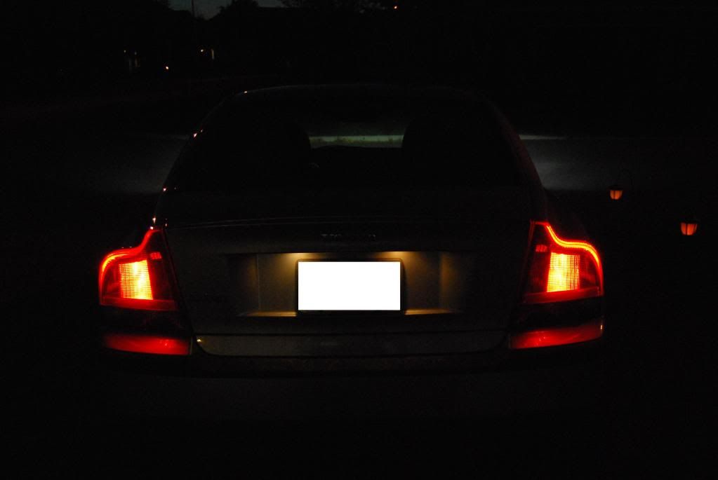

In regards to the connections. I decided to use replace the rear side marker bulb since its removal will not cause bulb warning message. Just to be safe I used LED protectors for each side.
Once everything was dry:
No bulb warning messages.:cool:
Not sure if i prefer this look now:
And even if I do I would have to figure out the way to eliminate the bulbs without causing the dreaded message.

just finished up the left tail, looks better than before
BTW, just another idea for those who decide to mess with the tails. I found that it was easier to make this type of connection: find an old bulb and break the glass all the way to the socket, cut the electrodes leaving just enough space to solder your led wires- handy :D
