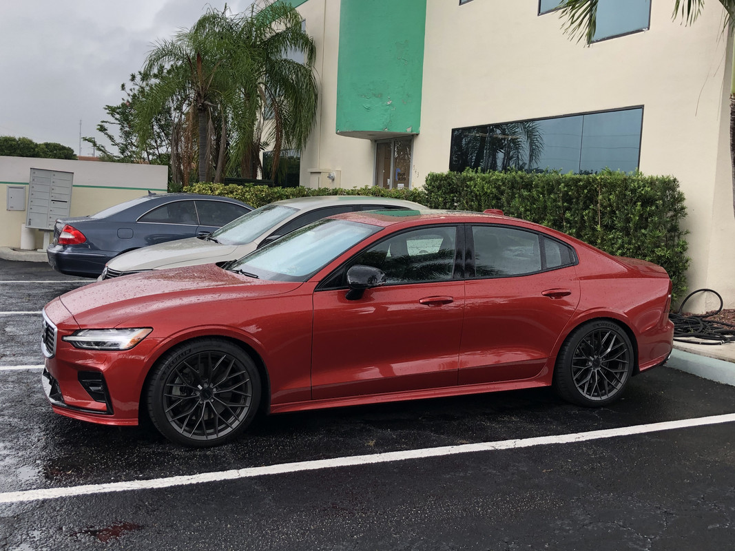

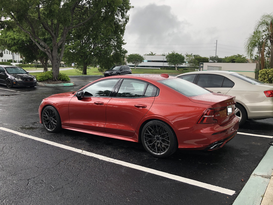

@kemmons S60 T6 on a Heico setup.
@Red Hammer V60 T8 on Heico setup - (looks considerably lower than the S60 above. Unclear if he's got coils or the spring/space setup.)
@Dodd S60 on Heico Springs - does not looks slammed like Heico's site show. He's running a 21mm spacer in the rear leaf setup.

@easyhunter V60 T6 looks like euro-spec Sport Chassis
@aonarch sport chassis V60 T5
@Symtom S60 with Sport Chassis and rear spacer removed.
@EMRtek S60 with Sport Chassis and 15mm rear leaf spacer installed
Confirmed Sport Chasis from Instagram user @oboyalkis.
